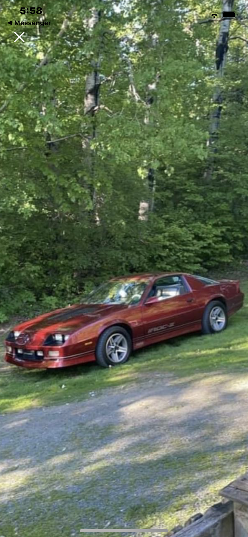

Looking at this 87 IROC have ?s
Thinking on picking up this 87 IROC. I have been sent alot of pics and vids and it looks pretty damn clean.
58,000 miles on it. Only concern is seems the IROC decal is ahead farther then it should be. And the door to fender gap.

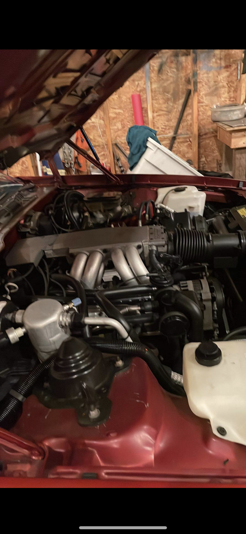

It looks like maybe some over spray on the hood strut.
Seller is very forward with info, prob doesnt know a super lot about these cars.
He was told it never had any damage and never been painted or touched up.
It has been in Canada now for the last 4 years and originally from Florida.
My concerns are the gap between the door and fender,
the door, IROC decal in the wrong place, and possible over spray on the hood strut.
How do I do a car fax report ?
What do you think its worth in US $$ ?

Car looks pretty clean. The gap could be from someone jacking the car up improperly. Carfax is pretty easy... Just go to carfax.com, put in your vin#, pay your money and a report in generated.

I never recommend buying any car sight unseen, especially if there is any question about possible crash damage---or potential hidden rust. Can you inspect this vehicle in-person? The "He was told..." part of your post is a red flag to me.
As far as estimating a car's 'worth' on an internet site, that's a real hit-or-miss proposition. You can improve your odds, though, by providing many more photos of all aspects of the car, especially underneath and the interior. As far as providing a dollar amount based on the few pics you provided, I personally wouldn't do so; there's just not nearly enough information provided.

The decal placement looks correct for an '87, so no concerns there. The fender/door gap IS from improper jacking, so that also is no concern, as it's an easy fix. I can't see the hood struts to know if that's paint or reflection, but the hood liner has also been removed, so the hood could've been painted.

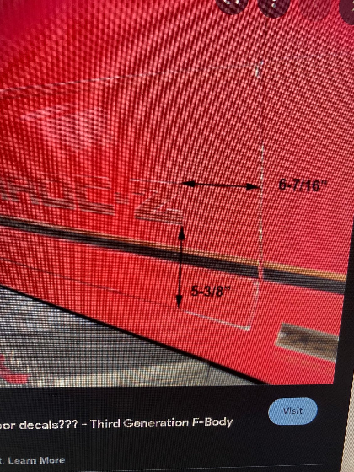

Hey Scott. From searching online it appears the decal
is too far forward ?

Well, without seeing the car in person, it's possible the decals were damaged and replaced, but not correctly. You can see the stripes have some damage, but it doesn't mean there's been a repaint. After looking more closely, the 5.7 Tuned Port Injection sticker under the emblem is also incorrect. That decal is supposed to be the same width as the Z28 emblem.
These are reasons why asking what something is worth without being seen, is impossible. There are too many variables that we don't know about or can't see.
