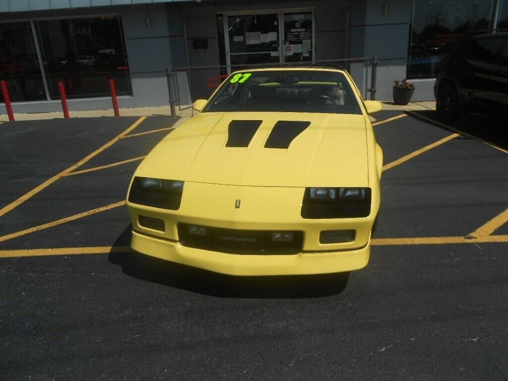

87 Iroc w/gold stripes... is front "camaro" logo always gold too?
I see some cars with gold striping/wheels that have the "Camaro" wording on the ftont lower grille insert in gold to match, and some with silver Camaro lettering. Enough of them that it makes me think they didn't always get gold lettering on the grille with gold stripes. Some I've seen this way are fairly original/lower mile cars. Was it a year thing, a supply thing, or are the ones with silver lettering just replaced at some point? Asking about 1987 model year specifically, but would be interested in know about all years.
Secondary question... how close are the reproduction lower grilles to original? i see they lack the "dimples" where the screws would go for the plate bracket, but is everything else accurate? I've never seen on in person.

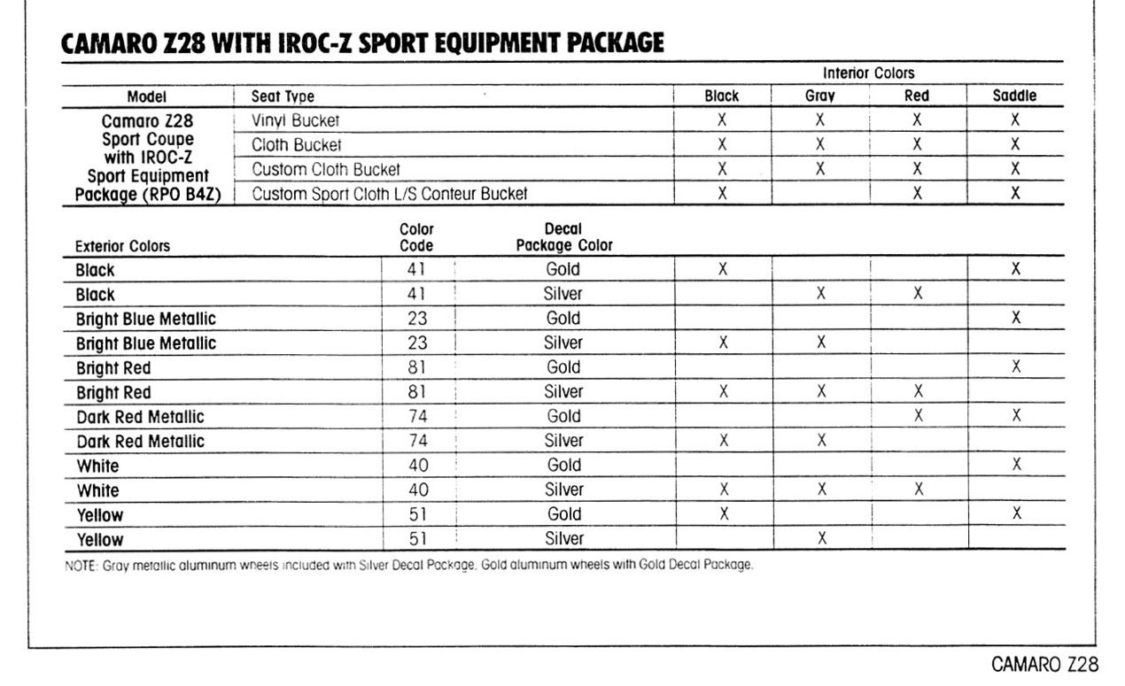

I'm fairly certain that 1987 was the same as 1986 in terms of color combinations. That means that a black IROC with black or saddle interior would have gold accents and wheels. Black with gray or red interior would have silver accents and wheels.

Stripe and wheel color was solely determined by what exterior/interior color combo was ordered. You could not select the stripe/wheel color seperately.

thanks, while this is new to me, it makes sense after viewing a bunch of original window stickers and never seeing any mention of wheel or stripe color mentioned on any of them, only interior trim and exterior paint colors.

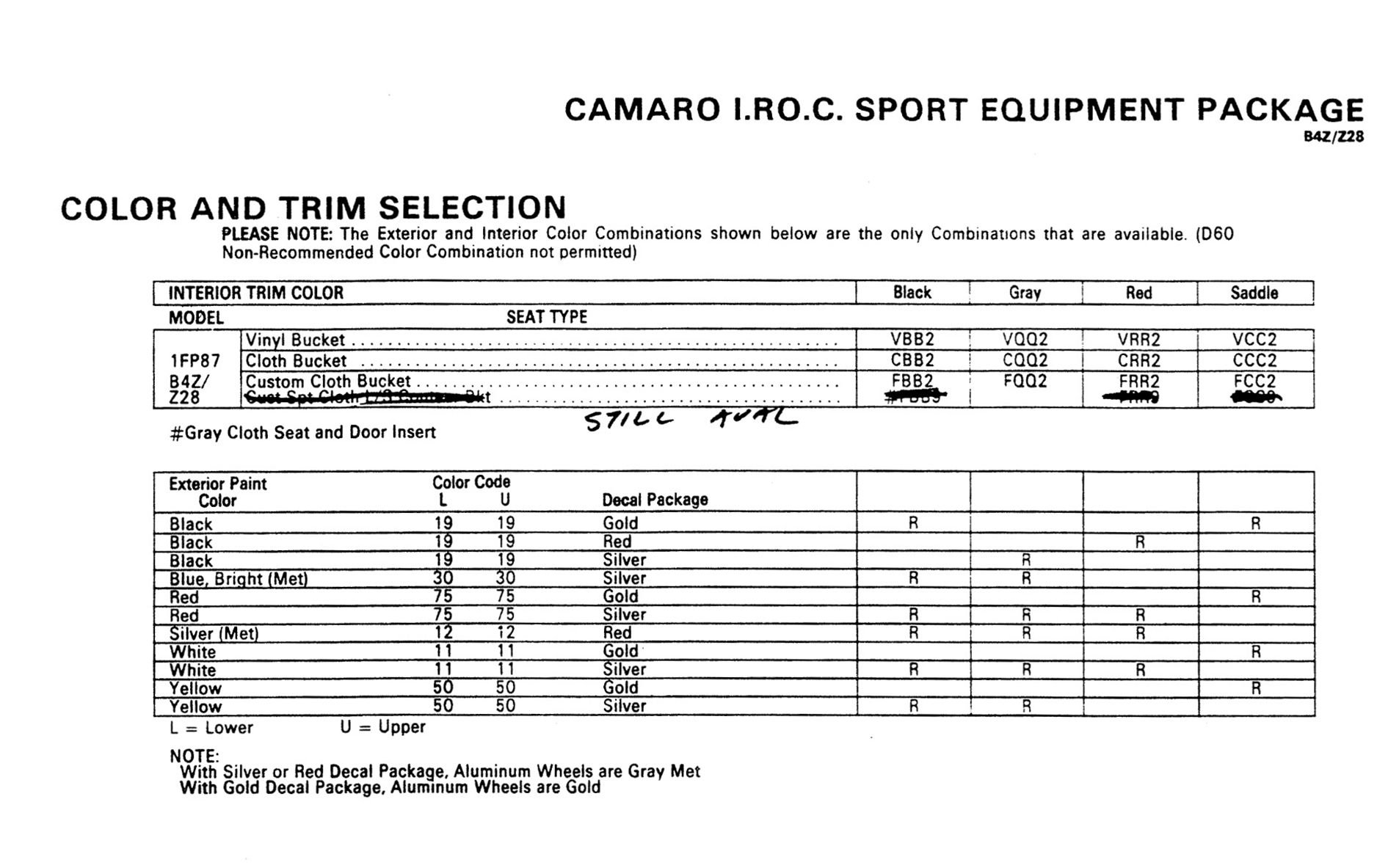

According to the order guide, black with black interior got gold accents. In 1986 anyway.

I'm just going by what is in the published GM order guide, which has typically been gospel in terms of what they did and didn't offer or build. I've been in this business for over 25 years and I've only seen them build something for regular production that wasn't supposed to be available, once. It can happen but it's very rare. In 2002, according to the order guide, you weren't supposed to be able to order a Silver with Taupe interior Firebird/Trans Am but I was able to order a Silver/Taupe WS6. That was the last time that I saw anything like that happen.
I don't have the 87 color combos from the 1987 order guide because they're missing from the PDF, so they could be different than 86.

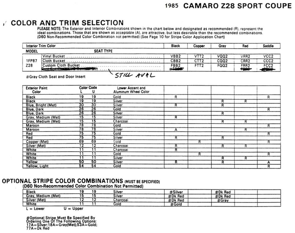

Do you by chance have the '85 equivalent of that sheet?

In doing a little personal research using Bring a Trailer completed auctions, it seems that’s indeed the case. In 1985 black cars with black interior got gold wheels and stripes like later years, black with gray interior got silver stripes/wheels, and black cars with tan interior got gold wheels/stripes. The only way you got red stripes was with a red interior.

Re: 87 Iroc w/gold stripes... is front "camaro" logo always gold too?
I for sure have a yellow iroc, with black interior, gold wheels, gold stripes, and a gray front grille
Gearhead, your chart shows exactly what I was sorta hinting at. -meaning with black you got gold with the black, but on blue you got silver. It WAS dependent on exterior color.
are you sure the grille has never been replaced? Thinking it should have gold lettering if the stripes were good originally. What year is your car?
Yes. Mine is a 1987.
Here is another one with the gold interior and stripes, but silver grill.
It was dependent on both exterior and interior combo.

One thing I forgot to mention earlier, I find it very interesting that a buyer could not specify a stripe color. I realize that this day and age, that's very normal. But at the same time these cars were offered, the Chevrolet trucks gave you an array of paint and two-tone choices, as well as more than one "recommended" interior color choice. I say it like that because it was simply recommended. A buyer could pick another color interior if they desired.
1987 Z28 is also missing from the 1987 order guide. 1985 and 1986 below.

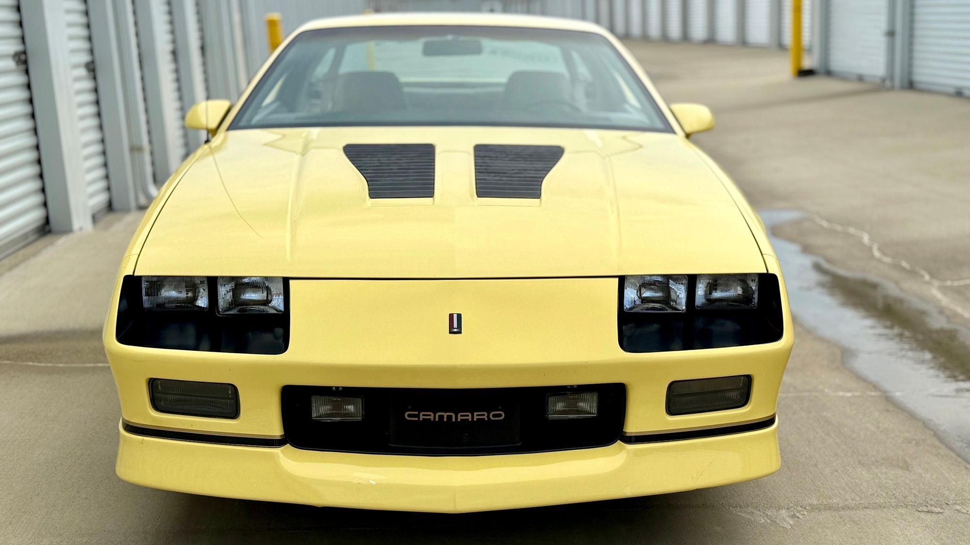

I've had a ton of these cars. On all of my original ones, the lettering on the grille was ALWAYS gold when they had gold stripes...on all years
I had owned several of these cars as well in the early 90's when they were just 4 or 5 years old. In Wisconsin it is/was required to have a front license plate, but every one of these cars I bought I would remove the front bracket, run down to the Chevy dealer & buy a new grill because the three holes left behind drove me crazy The exception is my 87 I still have since those days, it still has the original gold lettered grill, but sadly has the three left over bracket holes to go with.
I found out way back then the gold lettered grill was already discontinued & this was at the latest 1995?
I was going to buy a silver one and repaint the letters but never did.
I would be willing to bet there are a bunch of cars out there with original GM silver lettered grills, but they are not original to the car.
I personally know I did that 4 times.
If the silver letters would not have bothered me 30 years ago my 87 would also have silver letters today just like the yellow one above.
Next time you see a silver lettered grill on a very original car with gold trim, I think there is a possibility it spent some time in a state that required front plates in its past.
I think there would be an RPO on the spid for the plate bracket as well?
Gold stripes, gold letters. But F-body-fan, above ^^^^^^^^^^^^^^^^^^^^^^^^^^^^^^ ,makes a great point.
Yes, I have never ever seen an NOS one with gold lettering. And of course Hawks makes a repro and doesn't do gold lettering either.
