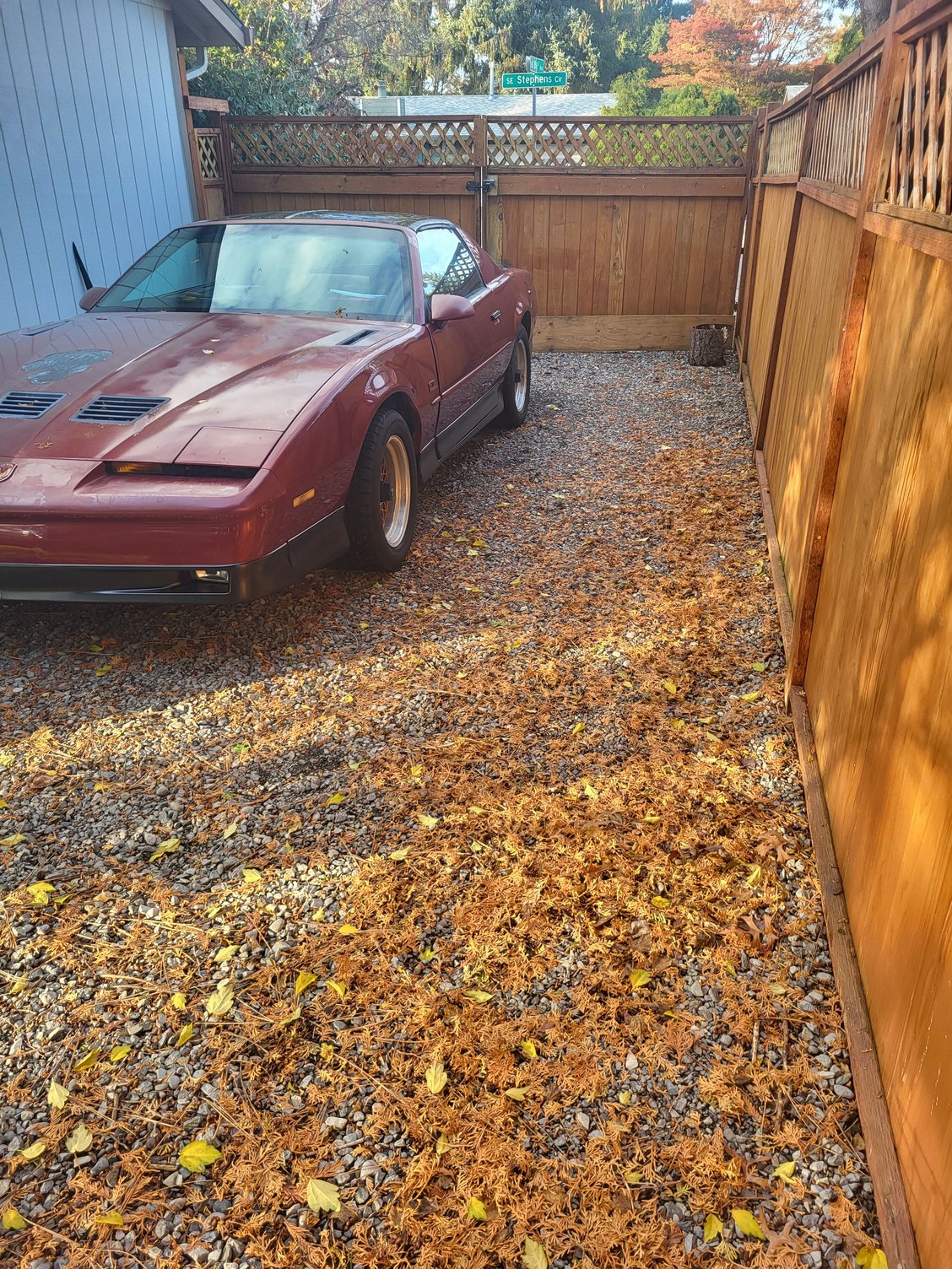

Looking for RPO codes
I know this has been discussed and i did searches:
1- Picked up an 89 GTA and have been cleaning it up etc.
2- So far no RPO codes, removed carpet, checked seats (they may have been replaced with period correct GTA seats in nice condition), not in glove box, not in hatch compartments, not in spare tire wheel well. have not checked behind dash or on top of gas tank
3- Contacted PHS and they only cover up to 1986
4- Obtained from GM archives the document 'Ive attached (hope it is viewable)
5- color schemes vary in car such as rear seats belts are tan, but one looks like saddle or beech wood. The actual rear belts under the plastic are tan, but the the front seat belts are red underneath plastic covers? The interior plastics are sun faded as well
6- doing my best to match things up, etc.
7- The wrap around spoiler is toast with respect to the mounting points (have a fiberglass one)
8- The car is reddish with gold spoke wheels & the ground effects are newer (black)
Anyways like information, not looking to restore this to original per se, just want to understand what i got.
the car runs/drives, but has the first shift slip in the transmission.................
Any suggestions would be appreciated. This is my first Firebird, have been driving 3rd & 4th gen Camaros for last 20 years on the daily
with gratitude, thank you

You said you included the GM Archive document but it's not in your post. You have two of the same images of the car in your post.

Yeah, it's not in Compnine's database. Like I said, most 1989s aren't.
Just based on the VIN, it's a 1989 Trans Am or Trans Am GTA with the 350. The RPO codes would verify more.
Also, the paint theme is not correct. All GTAs were monotone.

The car was originally Flame Red (dark red) with medium gray leather seats, so it would have matching gray/black interior trim.

Interesting, PO swapped to tan interior, which looks good to me. Just gotta get carpet. Thanks 4 info

Just out of curiosity, is the speedometer / odometer in miles or kilometers?
My neighbour's used to have one with the same colour combination.
