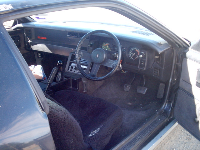

Not really clear but it's the only one i have at the moment.

still think it needs a different firewall both of these cars are from Australia

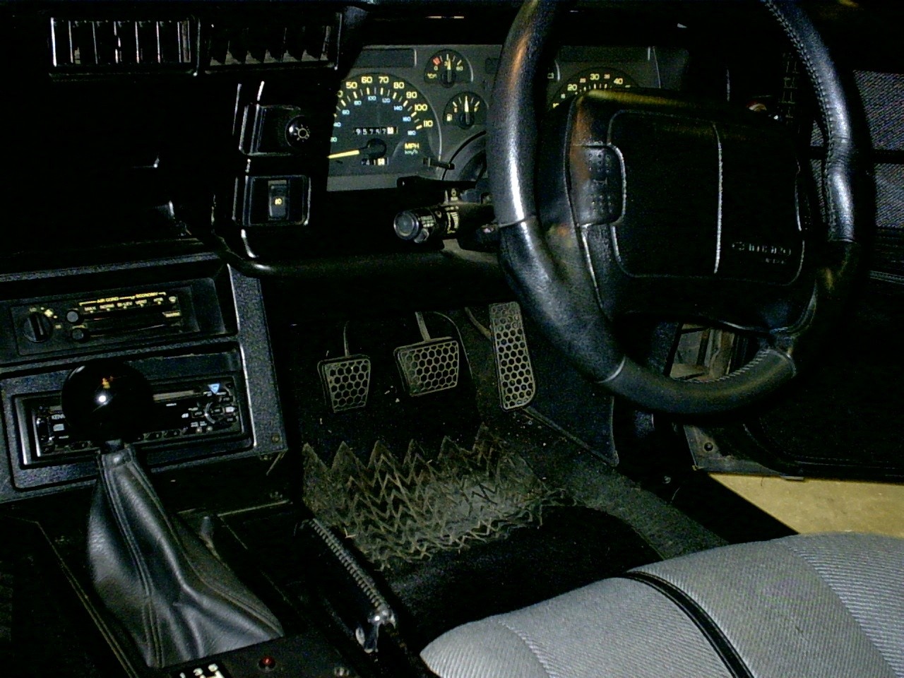

Mine is what they call a non mirror conversion, the firewall is original, the heater/ac unit stays the same except for a slight mod for column clearance and the dash is reversed to suit. The brake/clutch operation is via cross shafts that run over the top of the heater/ac unit, which works fine.
The steering linkages are original, idler arm swapped, steering shaft rag coupling altered to suit the aust steering box and a slight mod to the draglink/cross link.
Heres a few pics
