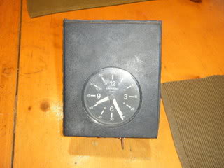

Old Mar 1, 2009 | 09:50 AM
tonys91rs's Avatar
iTrader: (17)
Posts: 854
From: Rincon, Ga.
Car: 91 Camaro RS
Engine: 305 TPI conversion.
Re: how do i install a center console clock?
this is the center piece that holds the clock. instead of trying to cut a hole, just cut out your section and mount this in. get another console, so you dont cut yours up. i have one if your interested. also, do you have the harness?
Old Mar 1, 2009 | 11:21 AM
tarheel's Avatar
Joined: Feb 2008
Posts: 118
From: Central NC (NC/VA line)
Car: Sold: 1986 Z28 Black/Silver
Engine: LG4
Transmission: 5 spd
just thinking out loud here....but i'd rather cut the hole for the clock vs cutting the console section out.
there has to be some type of finishing bit in the correct width..unless the clock is an odd size.
