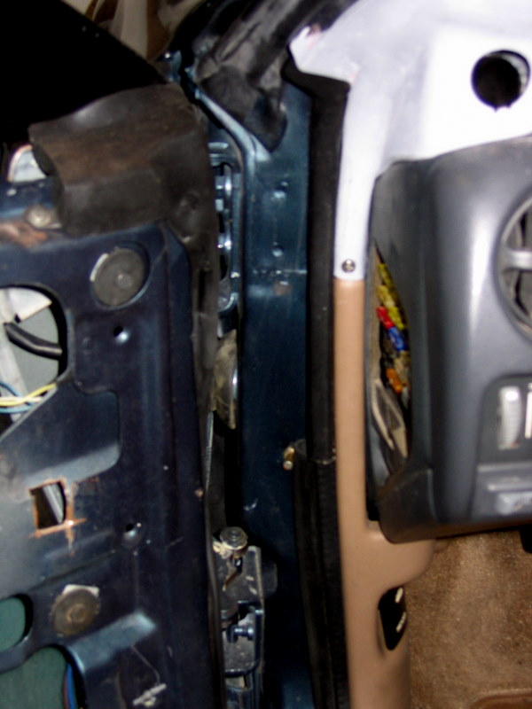

If you're using the 4th gen harness, why would you move it from where it's supposed to be?? It's a hell of a lot easier to get to then under the dash:

hmmm looks like on mine that it wouldnt fit there.. granted i cant open my doors all the way to see that far into the jam do to my workspace being to skinny.. ill have to look again thanks shroom
