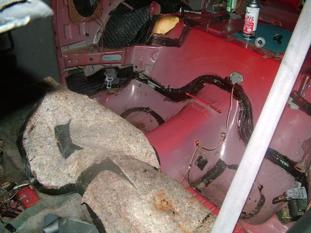

here, the 2rd post has a pretty good picture
https://www.thirdgen.org/forums/memb...ml#post4865578

Old Mar 23, 2011 | 09:36 PM
58mark's Avatar
Joined: Jan 2009
Posts: 4,009
From: Mesquite, Texas
Car: 89 rs, 86 Trans Am
Engine: RS-V6... Trans Am-LG4
Transmission: RS-T5... Trans Am 700r4
Re: converting to split back seats?
yes, that does help. I'll still go to my buddies car for exact measurements, but at least I can picture what I need
I'm having another thought though... I might need to buy a new set of fabric covers for the seats when I get them. I could always buy the set for a solid back set, and just reuse my one piece back, but with the delux covers... right?
