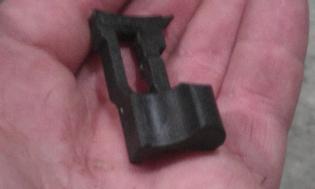

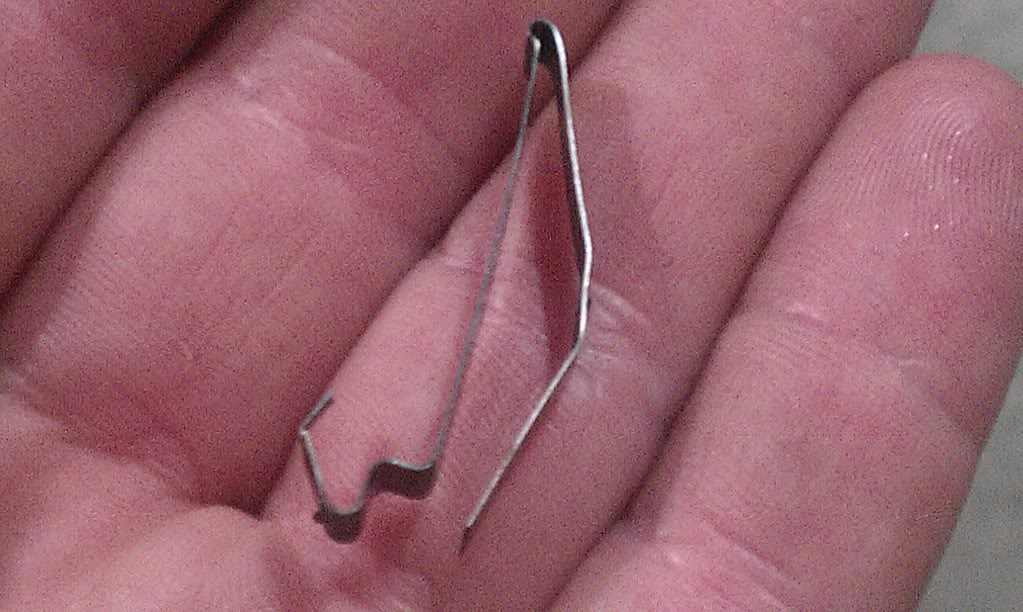

random plug and wire
random clip thingy
random plastic something or another
what does the brass spring loaded thing do on the trun signal switch? to me it looks like it would get caught in the lock plate and break off
random clip thingy

well the parts your showing are
1 unsure but *looks* like the vats plug
2 its a clip that goes in with the plastic under your ign key cyl.
3 is a part that goes lower left of the colum and your bright light switch pushes on it
your going to have to take some stuff back apart to get it all back in.
You need to test each switch and part for proper operation as it goes back together.

The brass locks the steering wheel from turning when you pull the key out. Just like you think.
The part for the brights should be put back in or your lever may flop around..
