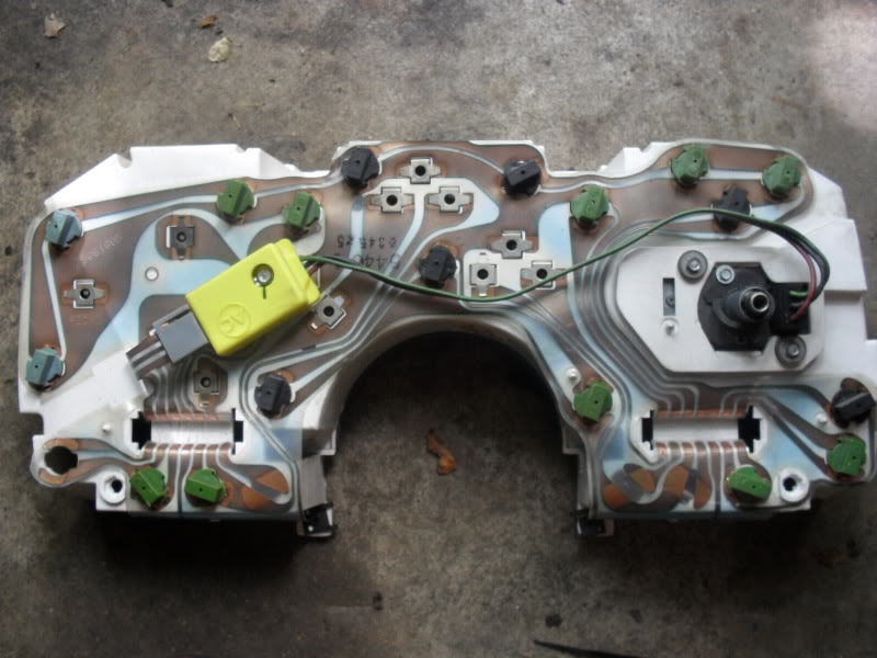

Just remove the 7 ? screws on the underside bottom of the dash pad and
also the 2 in each defroster vent on the top front of the dash pad up by the
windsheild.
Heres a link with instructions and a video:
https://www.thirdgen.org/forums/body...d-removal.html
Heres a pic of the back of the cluster:
Right click and open in a new window for a big pic.
Alright thank you for the information and on the picture of the cluster, how many LED's would i need to just change the gauges? cause i only order 11
