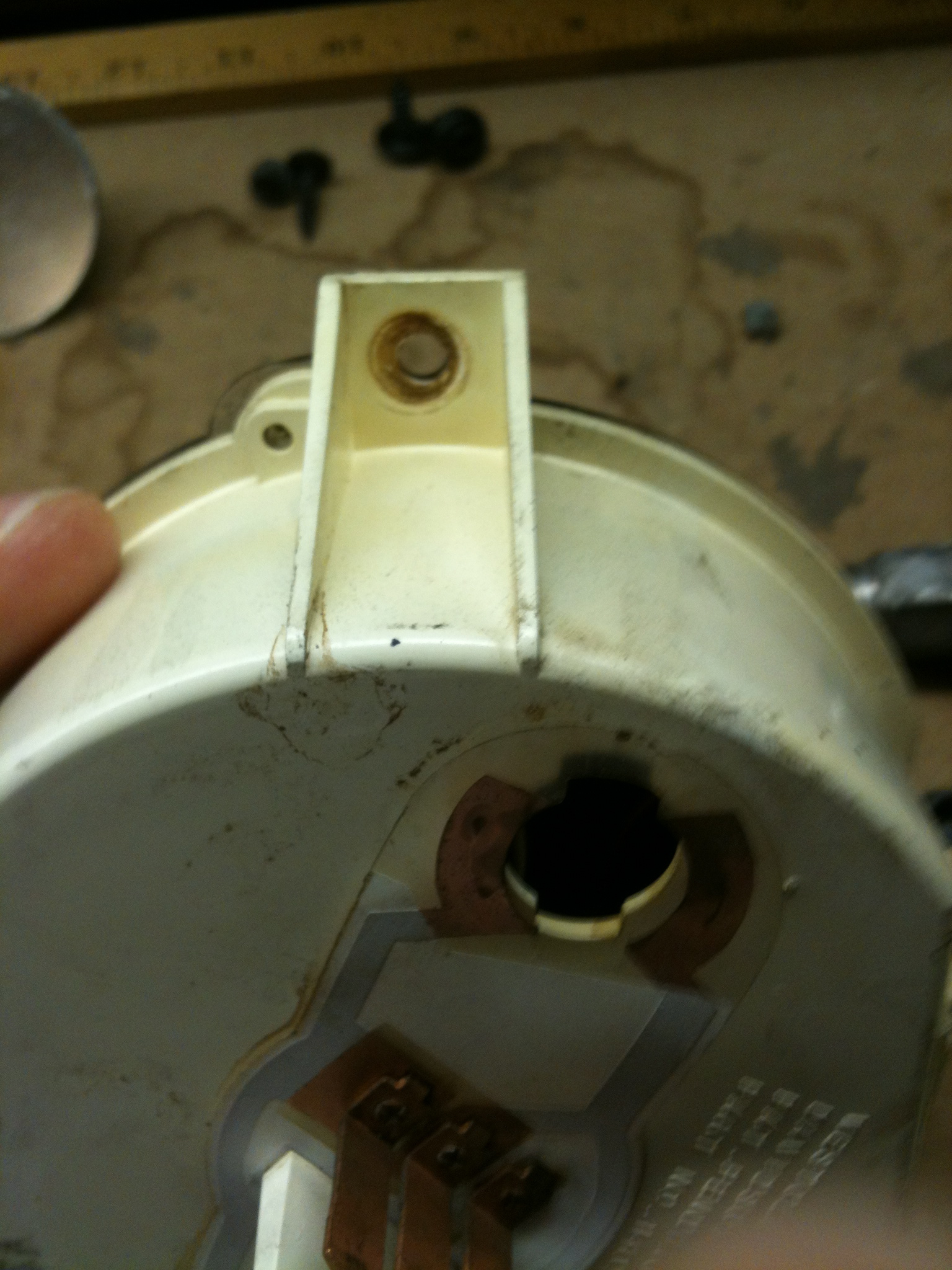

Here's a pic of one of the three holes in the clock itself. The screw goes through the hole and into the upper console.
JamesC

Re: Removing console clock?
Cool,
But I have a clock and see these holes. What I cannot sort out is:
You can remove the clock by loosening the rear of the upper console and lifting it up.
How do i do this? What and where are the screws/bolts to accomplish actually pulling the old clock out?

IIRC, you can remove the two screws at the bottom of console (lift the lid to locate them), then lift the rear of the upper console, which will allow you to access the underside of the clock and the three screws securing it in place.
