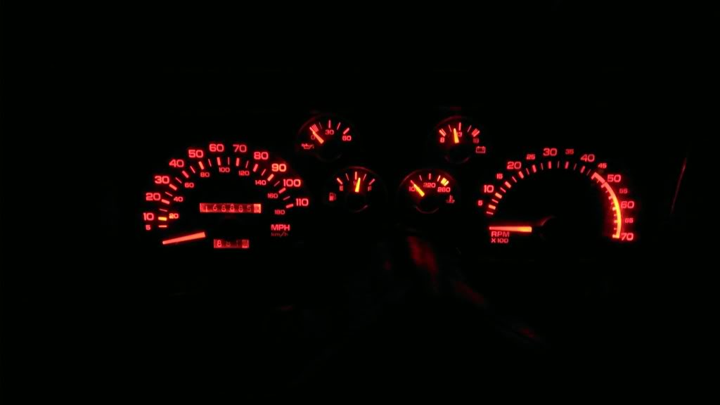

This is what you need to install the led bulbs. GM went to a cheaper bulb/socket combo more than likely to save money. The way you have it now it washes out the gauges. If you use the sockets and bulbs it makes the numbers and needles light up red. I used the five led wedge bulbs on mine bellow.

this is my dash with red. Name:  IMAG1276.jpg
