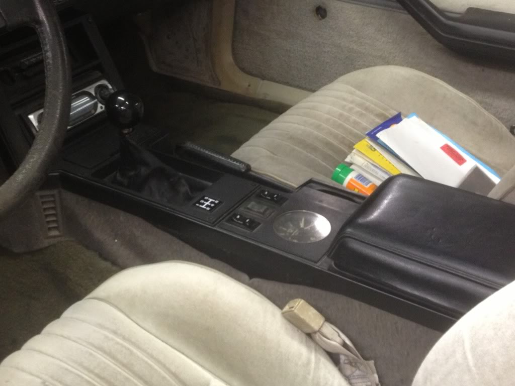

I cut my own with a hole saw. Just make sure you get the finest toothed one you can find, aim it level and go SLOW. If you try and push your way through it, you'll snag and crack the plastic.
No need to scribe any line as I recall...the circle can be seen on the backside in case you got that option...here's a pic of how mine turned out:
You can't tell it didn't come that way!

Here is the one my buddy did for me in my old 82 camaro.I took it out before I sold the car and then put this console top with clock in my 86 Iroc.
