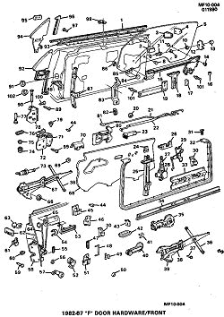

The part number seems correct as seen in the attachment below
but the number is no good on gm parts direct so I can assume they
don't have or stock it anymore. #85 in the parts list

the part you pictured is an up stop. they catch on the stabilizer that hodls the window in place at the top of the door. i have 4 of them. the weird thing is you can take them out and use the up stops on the door window channels, there is one already for the front not being used below the triangle filler and one on the rear in the channel that is vertical. i used different doors and windows on my car and the ones you refer to i removed them and used the up stops that were in the channels and were adjustable.
anyone have any idea what the down stops are? my window goes down too far.

My 84s window also goes down into the door too far and gets
caught on the bottom of the weatherstrip.
I also couldn't figure out where the lower stop was located either
as the door had never been disassembled before.
I just mounted a small block of wood to the base of the slide/guide
pole to use as a down stop.
Thanks to ted for this pic:
Parts # 48, 5, 6 from lists above

The pic in the 2nd post is #5 in the diagram, classic also sells those.The bottom stop is by #15, but doesnt appear to have a number listed!

the upper door stops are 23 and 49,

if you look at item 14 rear there is a nub on the bottom of the piece by the circle with a 15 in it. it bottoms out at the bottom of the door cavity, i put a few washers stuck together with sealant and was able to raise the window enough to kinda fix my issue. i believe the actual down stop is the spring on item 27 the regulator. whether the tabs are bent or the slotted pin in the center of the spring has rotated. the only way to fix this is to take the door apart again and get a new regulator. but those are the only two items that would stop the window from going down to far. i rebuilt my drivers side door and it works fine and stops where it should when all the way down.

I'm having that same issue. When I raise the window it catches on the felt strips because it went down too far. It also rattles a little when the window is all the way down.
Incorrect. #27 is the power door lock actuator.

trim it down, it's too tall but only $.60

Re: Door window guides/stops
Sweet. Thanks for the help.
"Item Not Sold at: Camarillo #1012"
That's what the Homedepot website says for me. That would explain why I couldn't find it when I went to the store the other day.
Originally Posted by TEDSgrad
Model # 15948
Internet # 100338677
Store SKU # 755472
1/2 in. x 5/16 in. Black Rubber Stopper
Write the First Review
Ask a Question
I was able to find them at another Home Depot. I just used a screw with a washer instead of using a bolt. Seems to work OK. Just happened to come across this while messing around on ebay:
http://www.ebay.com/itm/1982-92-GM-F-Body-Window-Stop-Bumper-/331134759985?fits=Year%3A1991%7CModel%3AFirebird&hash=item4d192b7431&vxp=mtr
For the record, the p/n is: 16624604.

Originally Posted by Drew
When that rubber bumper goes, the top of the door glass can catch the dew wipe screw and chip the glass.
Yep this happened on mine, I ordered new ones from Hawks.
I drilled out the old ones that were riveted in.
What did they cost at Hawks? I got mine off ebay. IIRC, they were around $6.
Same price there too $5.99
