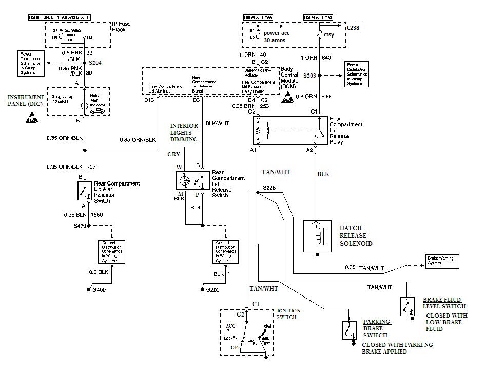

Will upload schematics when I am finished tweaking them, along with results and other pics. I dont know if I mentioned it earlier, but the bcm manual is
http://www.fieros.de/en/articles/BCM.html

My Schematics, I made these from a download of a 4th gen service manual + Paint and my third gen book. The radio schematics I threw in b/c I installed the uq7 option in my car and redid my radio wiring.

Plugged in the Battery today, no smoke! haha Found a couple errors, but for the most part all good. I have a digital dash, so one of the problems I encountered was my driver info center and odometer screen not working, but after reading up I realized that when I was re installing the dash it didn't get a good ground. Another thing was the hatch release relay. I wired it wrong, even though schematics were accurate. I actually popped the ctsy fuse. other than that, everything is good. RAP works nicely too. Oh and rundown protection works well too. After a while with the doors open, the bcm shuts off the interior lights.

I put the BCM through its paces over the last couple of days. So lets run down the line: the windows and stereo (with my new harness work pretty well, both normal and RAP), the door locks saw a large improvement in power. In comparison to the old relay, the lock levers really move, and move fast. with the key on the seat belt light stays on until you pull out the seat belt, as if to click it in, the interior lights dim off after a bit when you close the doors and also when you leave the doors open for a long time, parking lights, LED and horn I will come back to, the security light flashes currently because I didn't disable VATS in the BCM, but it works, it dings when the key is in the ignition, the signal for the trunk from the switch is read by the BCM, and it sends the signal through; the trunk opens the first time you press the release button, and the door jambs work well. Now with the LED, park lamps and horn, they work, but I recomend not plugging in the LED until you have the key fob, otherwise, the BCM will log in code 35 (alarm activation). I have one last thing to add regarding this upgrade: I got all signals right from the terminal ends of the wires I tapped into. What this means is that I cut off the old terminal ends and when I crimped on news ones, I added my own wires. It took much longer, however there are no additional cuts in wires for the most part. Ignition pos. voltage is the only one I can think of that I cut into. The schematics I uploaded may or may not depict this. Any "S" (splice) or "C" (connector) designations in these schematics that have a 400+ number are ones that were created by me. and any dots not designated are simply connections at the terminal (old term. cut off, new one crimped in with new wire).
