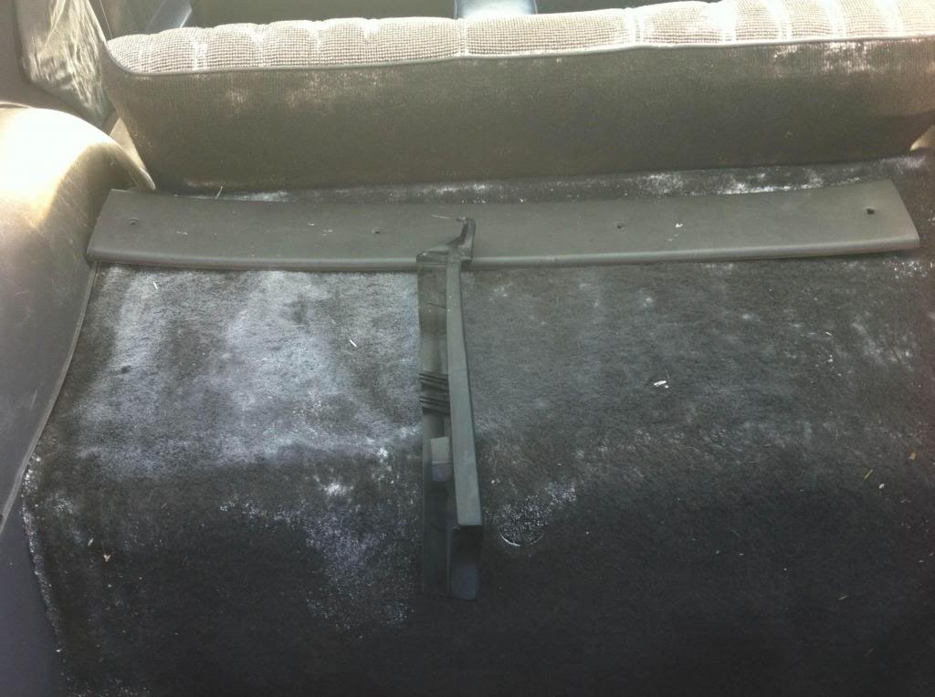

When I got the car it's been sitting out for years. Close to 8. I love in Oregon so rain and all that doesn't help. It's a t top Camaro. Anyways spiders nested and the old owners sprinkled what seems to be baking soda to absorb the moisture and now it's like fused to the upholstery. Any products that help with it? Also the steering wheel is discolored was wondering of you guy recommend a stain that brings back the original factory color. Last but not least my dash lights are weak/out. Any idea how intensive that portion is? Work wise? It's my first rebuild car and I'm figuring things out slowly.

Requested pictures

I clean rugs & small carpets by hanging them on the fence, & then
use a power washer. Pre-treat as necessary with any generic
carpet/fabric cleaner. Amazingly effective.
The carpets look to be structurally sound enough to remove,
then clean like this, and I bet the results will be impressive. If the jute
padding is (probably) nasty, it's very cheap to replace, rather then try
to clean. Or, upgrade and add products like Dynamat.

The baking soda may have been put down to disguise mold. There may still be moisture underneath. I'd strip it ALL right now. If it's salvageable/able to be cleaned, it's easier out of the car to clean and touch up with paint and/or dyes. Plus, you need to see how the floors look underneath which may be a second, currently hidden, project.

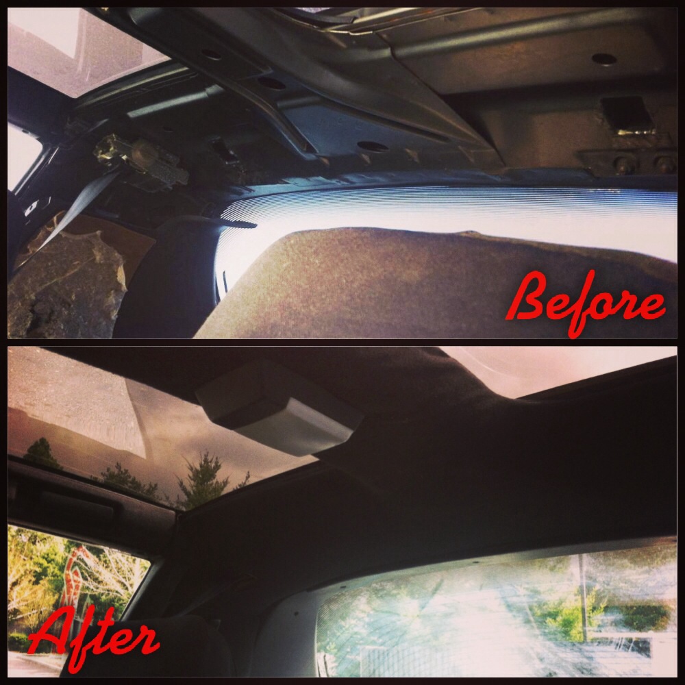

I finally found what I needed. Interior restoration is almost complete. I need to take care of the floor board and the back seats. But here it is.
