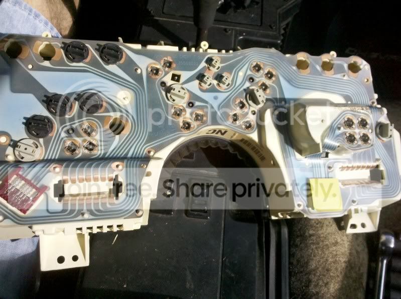

As far as I know the 91-92 clusters are completely different including the shape, mounting and electronic connectors. Also difference between mechanical and electronic speedo although I don't know which the intellitronix cluster is. IIRC, the front has a different face with a flat curved clear piece (similar to the Berlinetta) vs. the earlier black plastic piece with the round holes.
https://www.thirdgen.org/forums/elec...ster-woes.html
