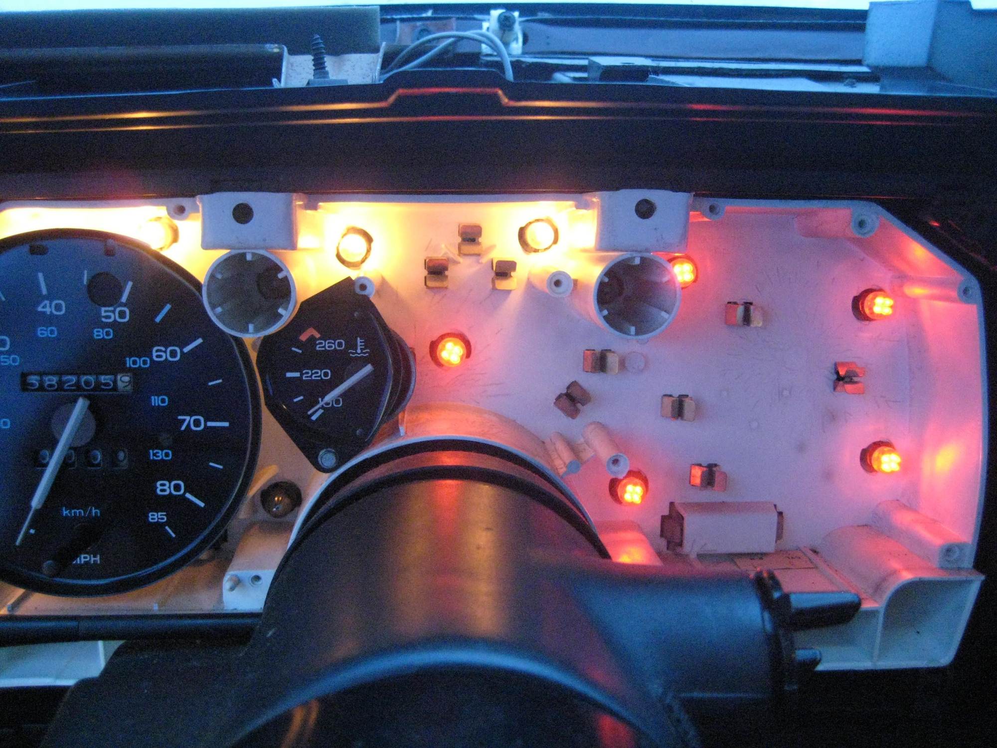

These are the bulb holders/sockets:

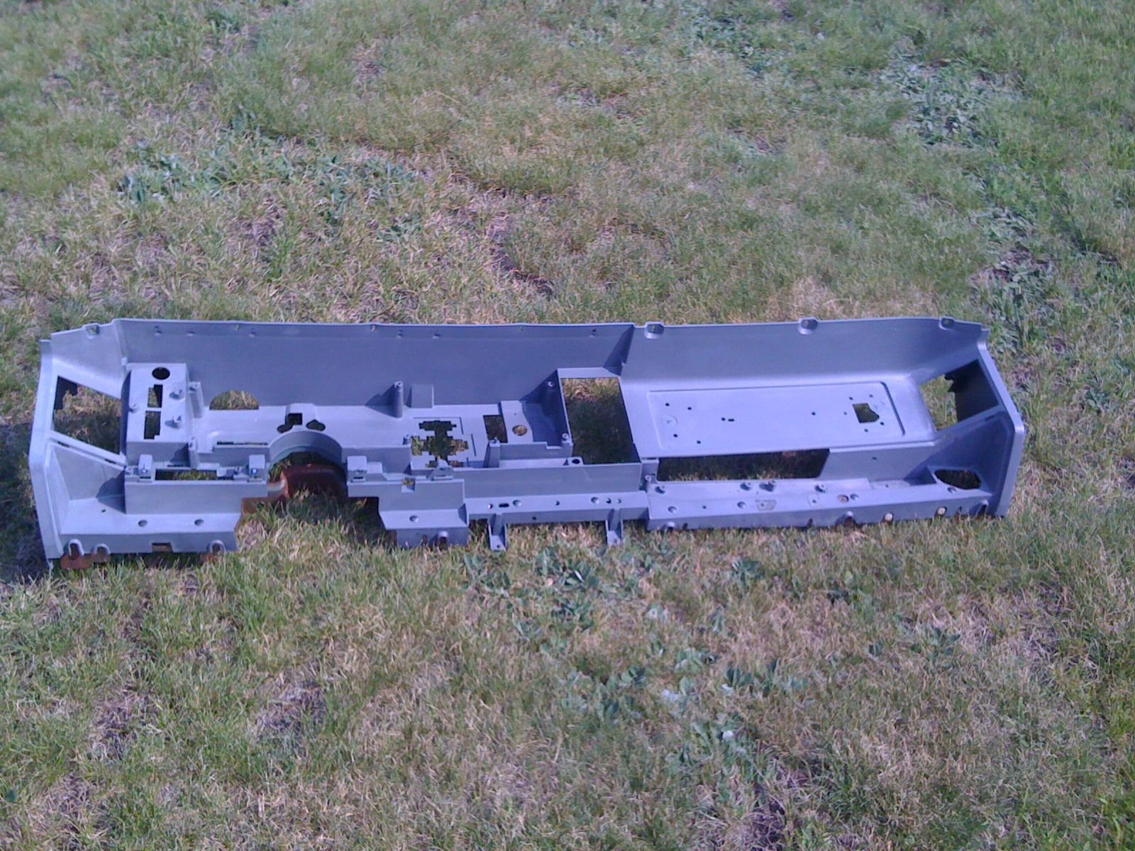

here is a picture of the inner dash plastic from a 1989 Firebird , looking at where the gauge cluster sits you can see that there is no way to access the back of the cluster while it's still installed in the car .
Yea , I know a bunch of the plastic stuff has to come off to get to it , and Navy02ws6 is right on target , the steering column dropped a few inches is part of the fun (or misery , your choice) ...

When I was installing new speakers in the dash of my T/A, and snapped a photo or two of the area behind the cluster. These will show you what's under the pad.
https://www.thirdgen.org/forums/memb...ml#post6053116

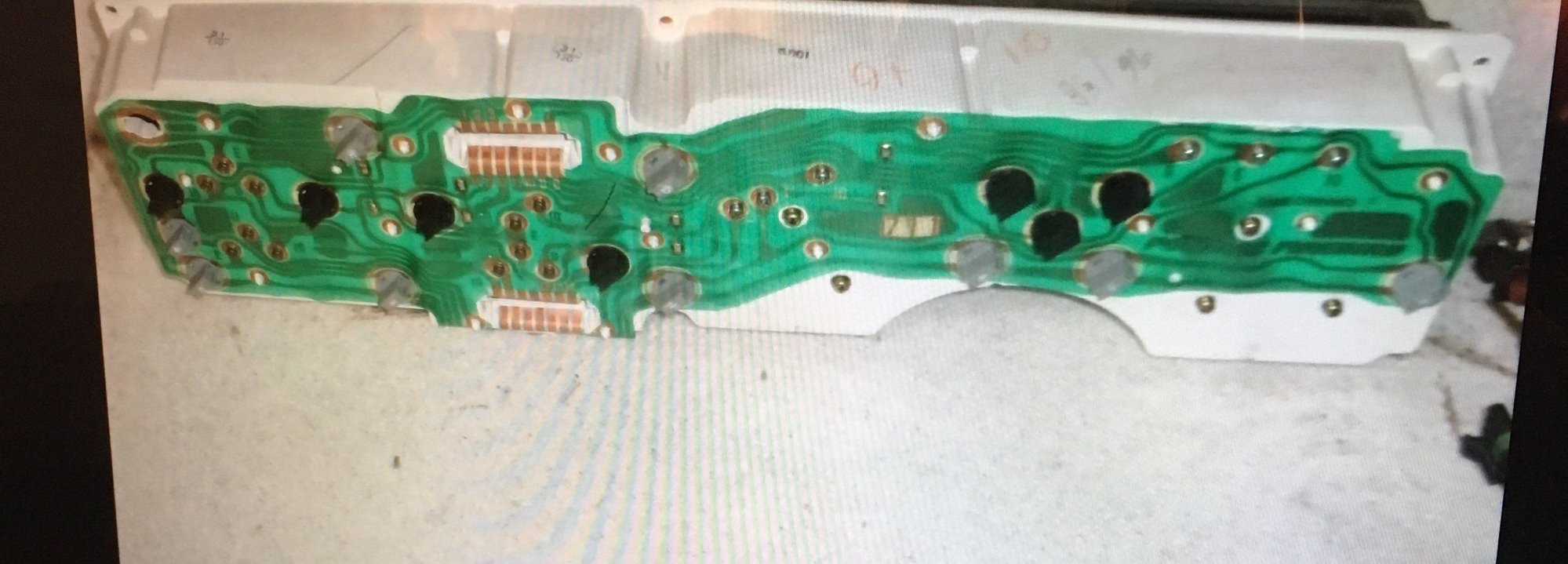

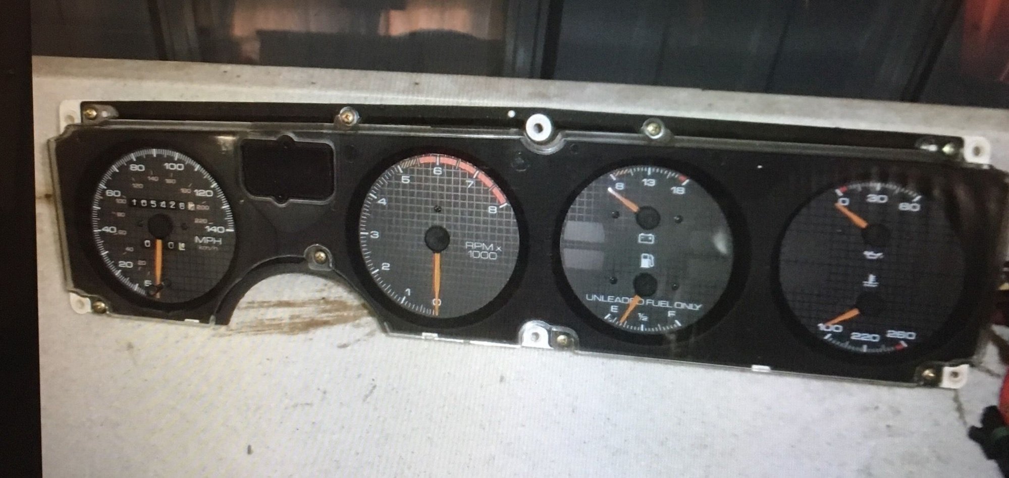

Here are two pictures of the 1989 Firebird gauge cluster . Even if you do remove the front plastic covers with the gauge cluster in place , the gauges themselves (which are covering the bulbs) are screwed in from the back of the cluster housing and are not removable from the front (like your Camaro appears to be , I wouldn't personally know , never having owned a third gen Camaro) .
I know the picture of the back isn't that great , but if you look close you can see the screws that hold the gauge units into the cluster . Even if you could change them from the front , by the time you get far enough into the dash to remove the cluster's bezel and clear plastic cover , spending all the time it would take to get into taking apart the cluster from the front , it's only 6 screws to pop the whole unit out and change the bulbs from the back as the General intended
