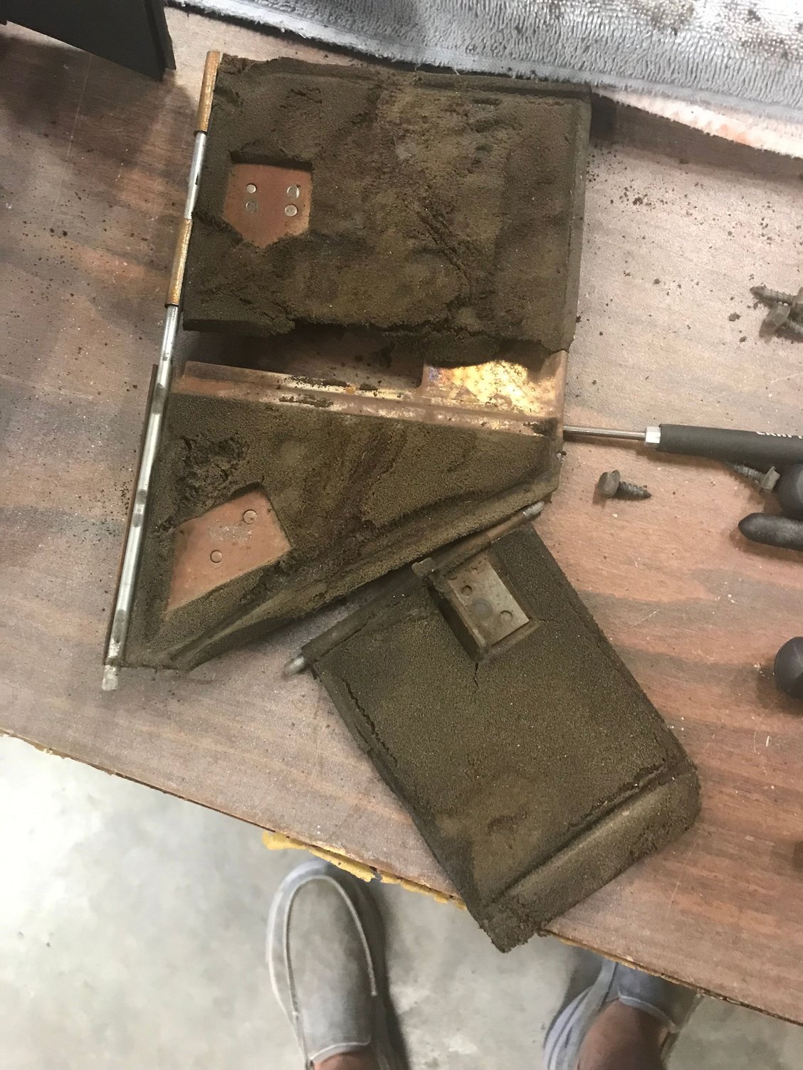

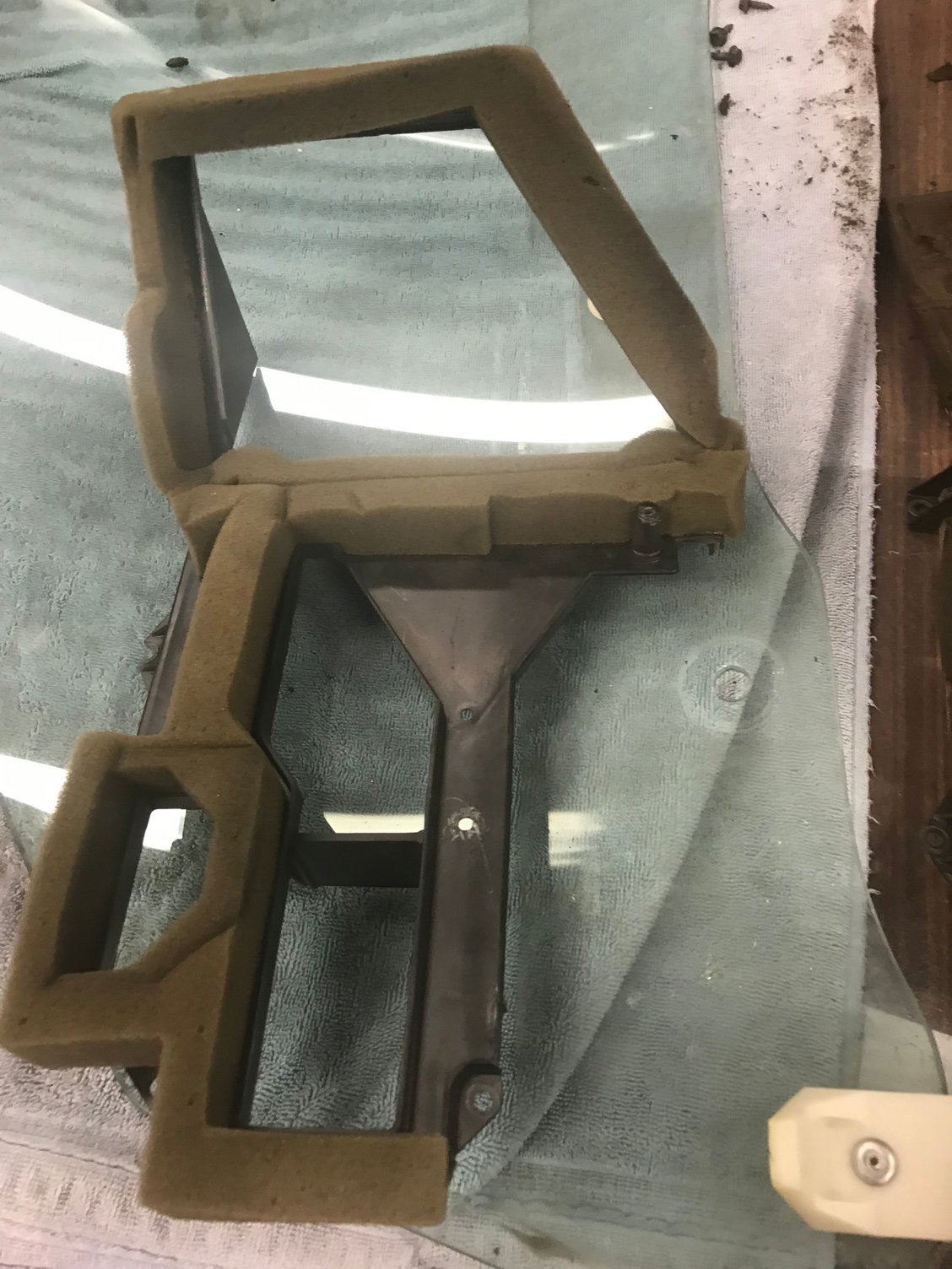

Does anyone know where I can get the thin foam like material that insulates the airflow doors that are inside the A/C and heater core box? You know, the replacement for the fuzzy crap that shoots out of the vents on our old cars. 😜 Also any idea where to get the green foam material that acts as a gasket on various parts of the box?

I ordered some 1/16th inch closed cell foam off of the net. Don’t recall where but I soda blasted parts and applied spray on adhesive to door flaps cut to size. Let them dry overnight and reassembled. Worked great. Take pics of flaps before cleaning so you can cut pieces correctly.

Material is on both side of doors. None inside box. Don't have pics of both sides of flaps. Maybe ask on TGO Heating and Cooling thread and see if someone has pics or a diagram. I just copied what was on there before I blasted old material off. BTW that was 3/16th closed cell foam, not 1/16th.
