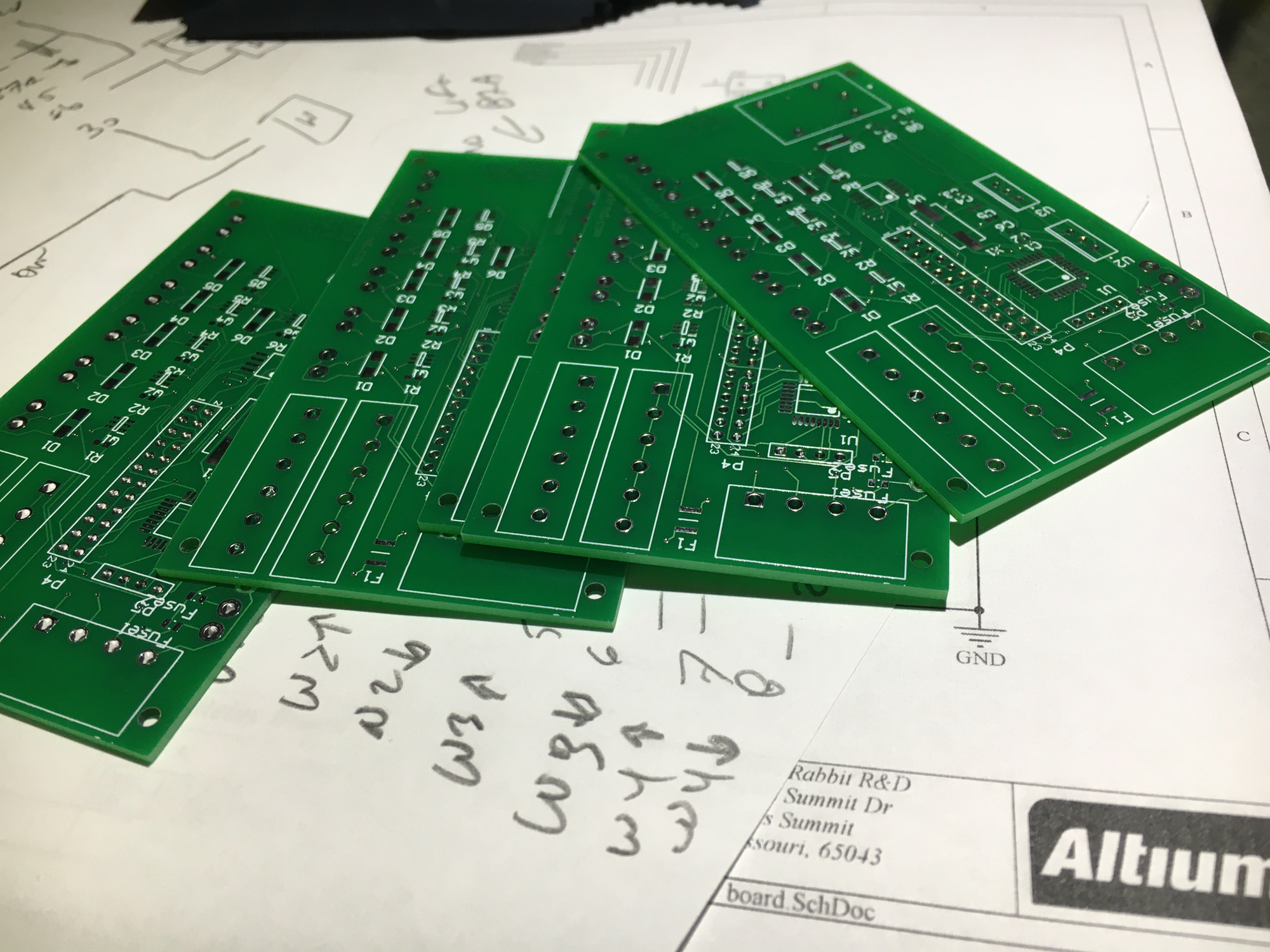

So I have been working on a new touchscreen control for my 87 GTA. I now have this working to control door locks and window control. Any thoughts? I am still trying to decide where to locate this and if I would want a larger screen. I am still working on mocking up the bezel also.

Is this controlling the original lock solenoids and window motors? Is most of the work done using software or hardware? Did you have to add any sort of limit switches or checks? I'm just curious how it actually works.

It controls the original lock solenoids and motors (I am replacing the relays). I have a safety limit in the window circuits to stop it from trying to keep going when it hits the limits of the window movement (or if you put something or someone in the way of the window).
It is an embedded circuit - basically there is a couple of microcontrollers in there to turn on and off some analog components. I also was able to add a power down delay so that when I shut the ignition off, the windows would be able to function for 5 minutes after (similar to newer cars).

Got some test boards to start testing and moving this project forward!
