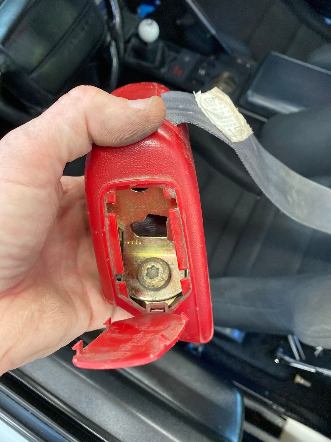

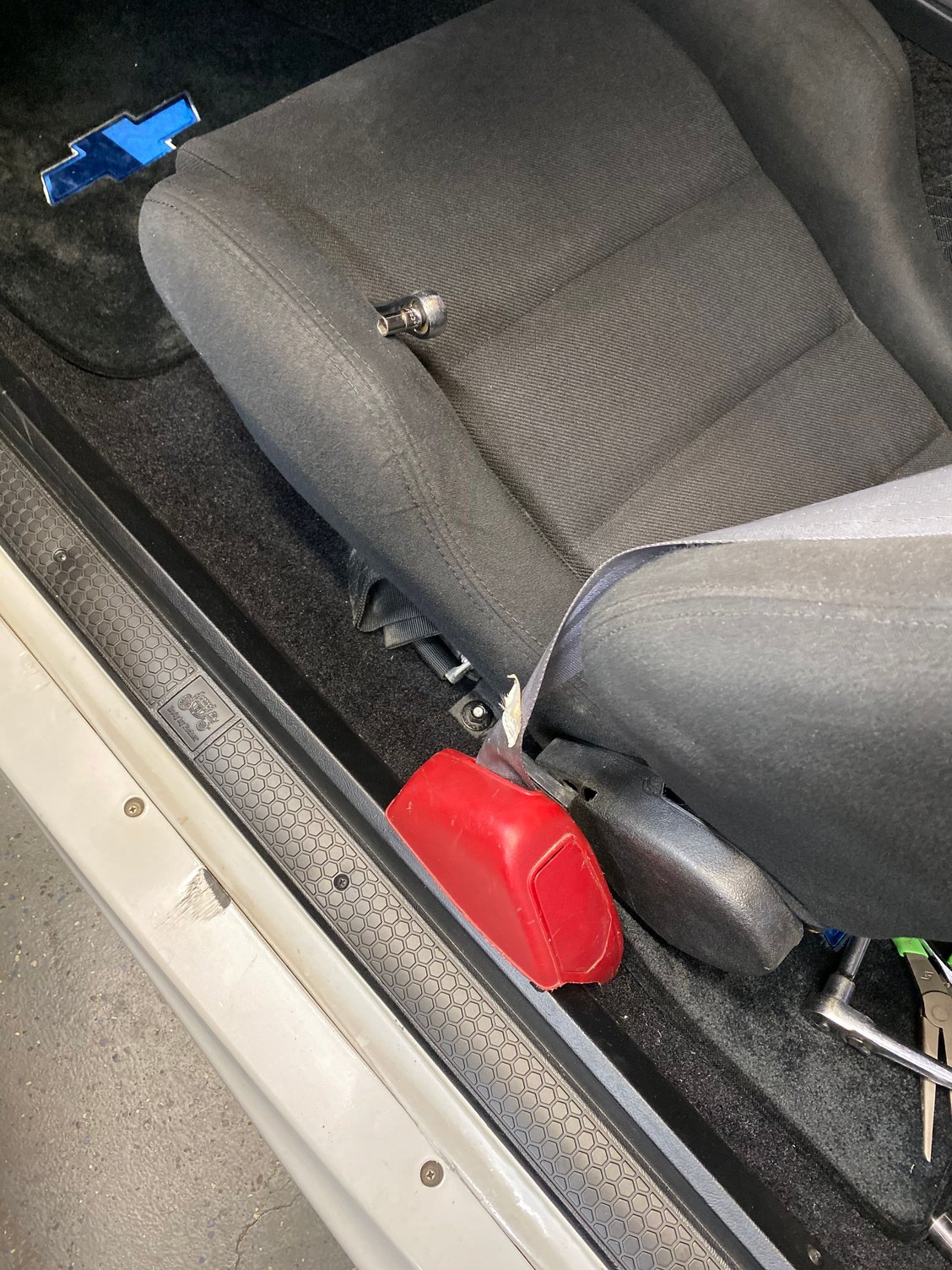

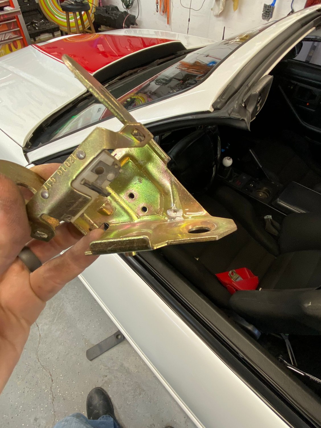

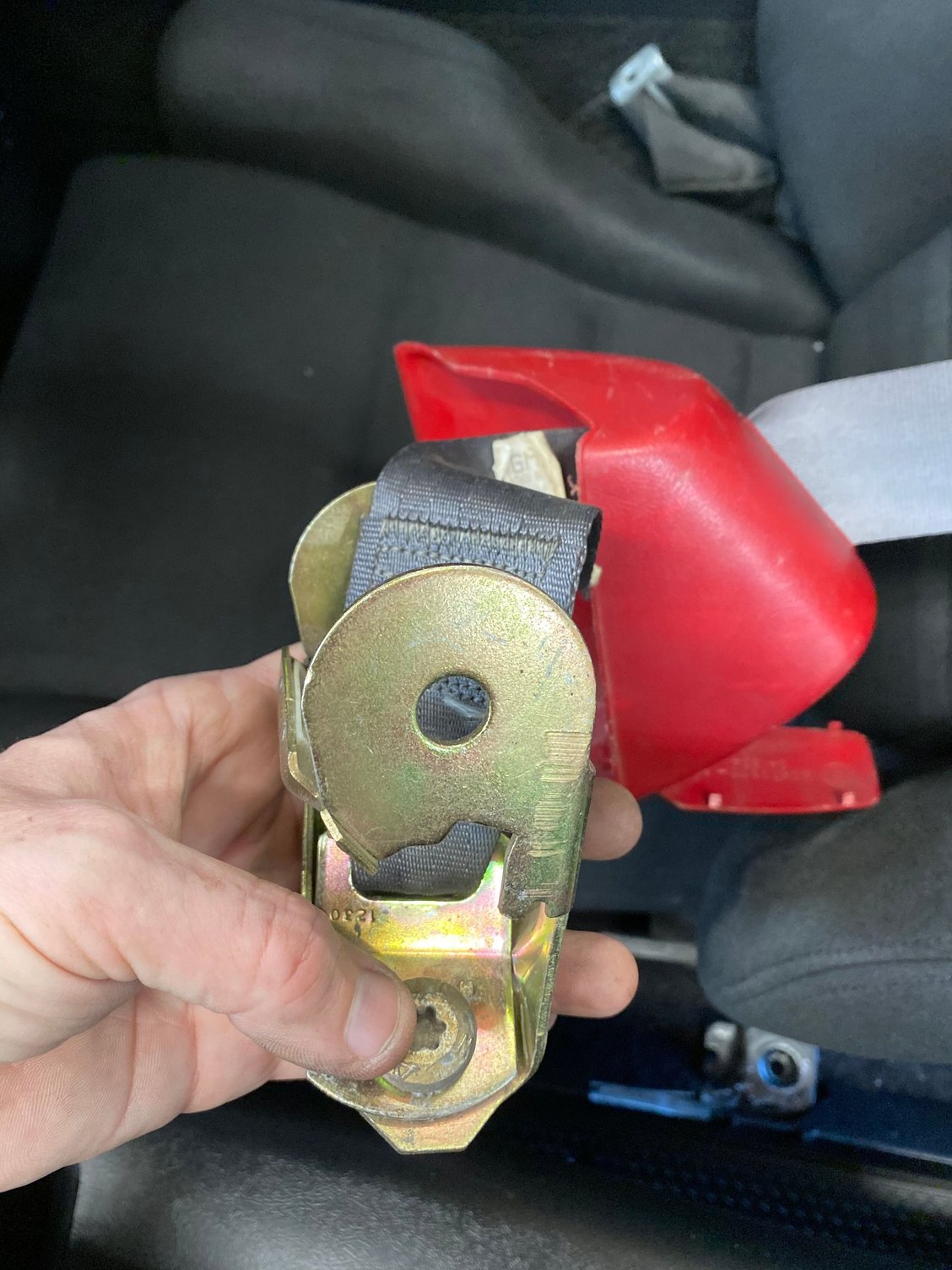

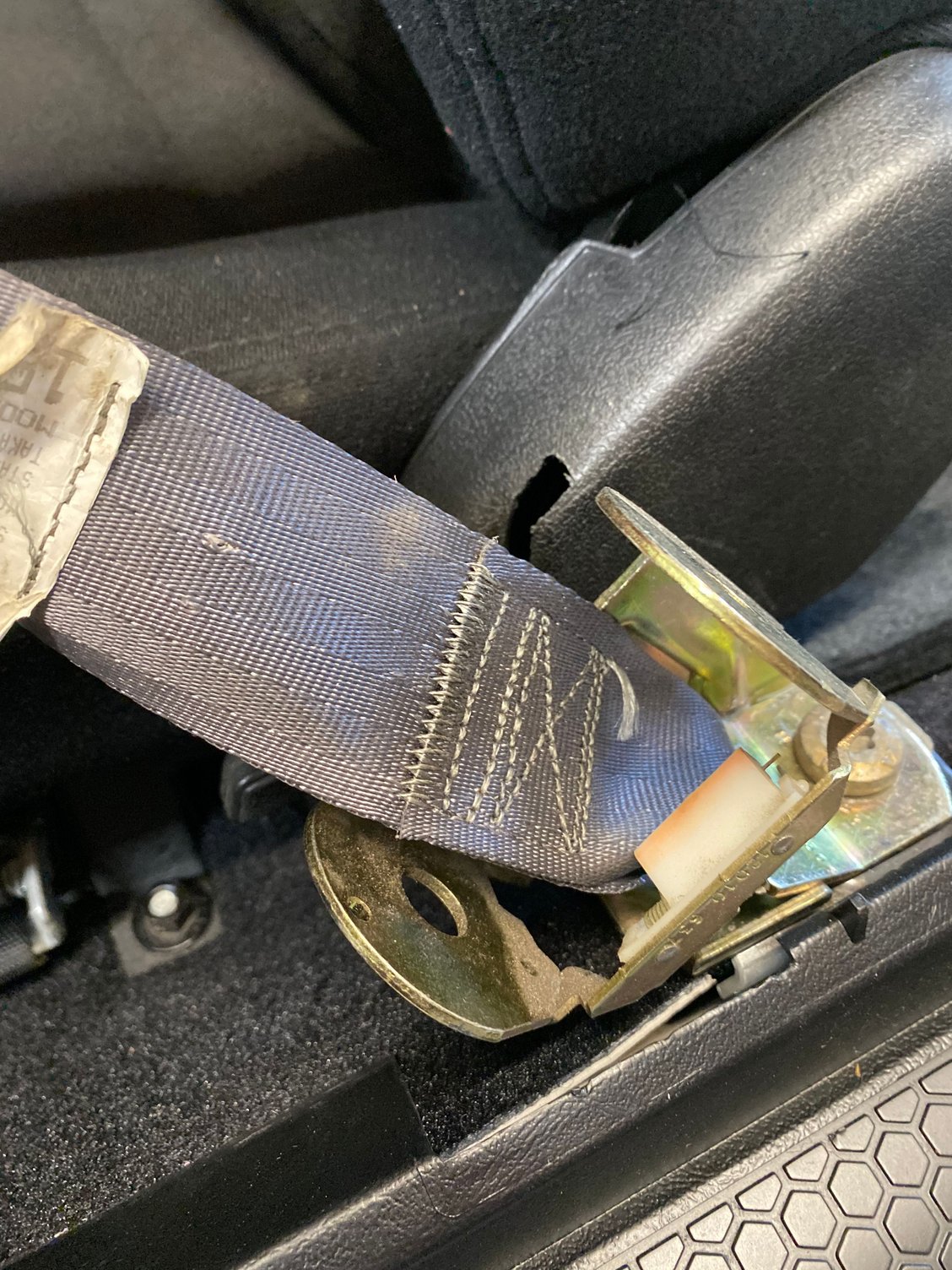

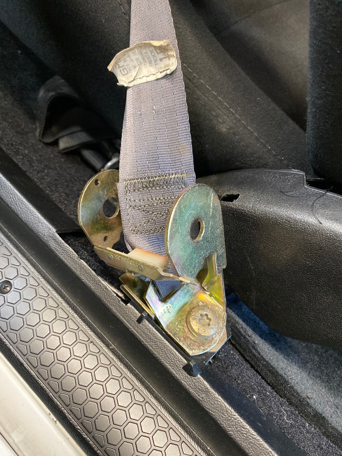

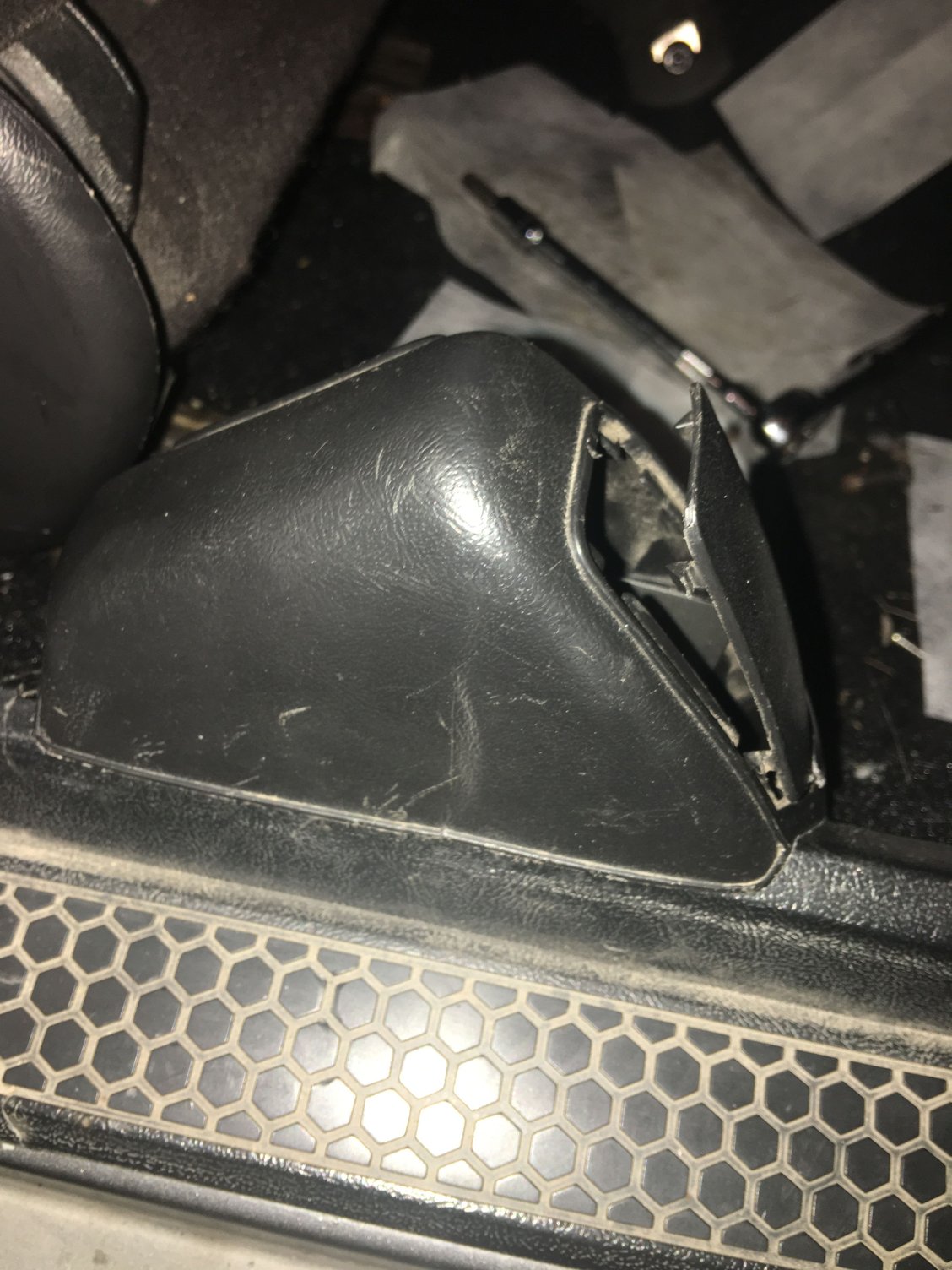

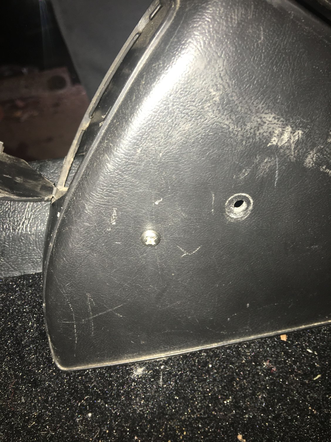

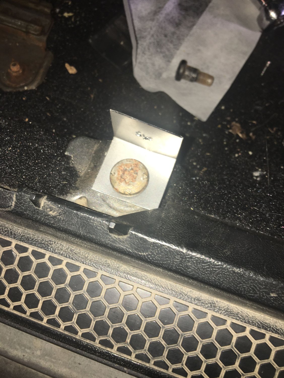

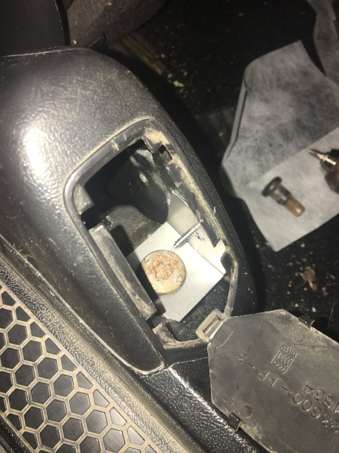

My original belts were shot so I decided to go with 4th gen belts. For one because they were easier and cheaper to find and because they only have a retractor in the roof. They are pretty much a direct swap. One thing you need to do is remove the plastic cover from the original lower retractor. Do this by drilling the rivet out of the cover to the retractor. You will then have to cut the belt to remove the plastic cover. The 4th gen belt will need the plastic cover trimmed some where it mounts to the floor so you can get it through the hole in the original cover. I don’t have pics of this but you will see what you need to do once you have the parts. The one issue you have to deal with is how to hold the original cover in place. I made a bracket that is held on by the seatbelt bolt. Then you put the cover over and drill a new hole through the cover and into the bracket. The seatbelt still needs put in there again but was just showing how I did this without the belt in the way.

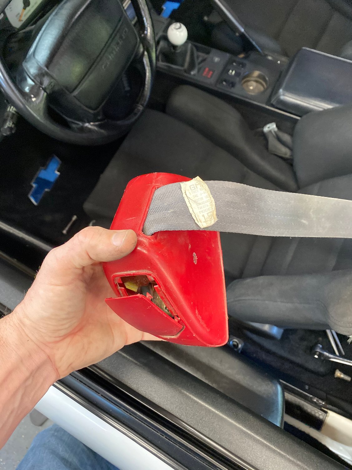

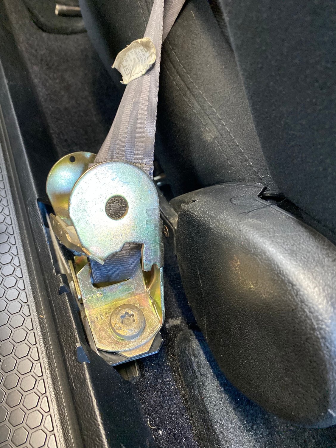

I just used the original bracket that held the retractor. I did grind a spot so the 4th gen belt hold down tab would fit where the torx bolt goes through.
