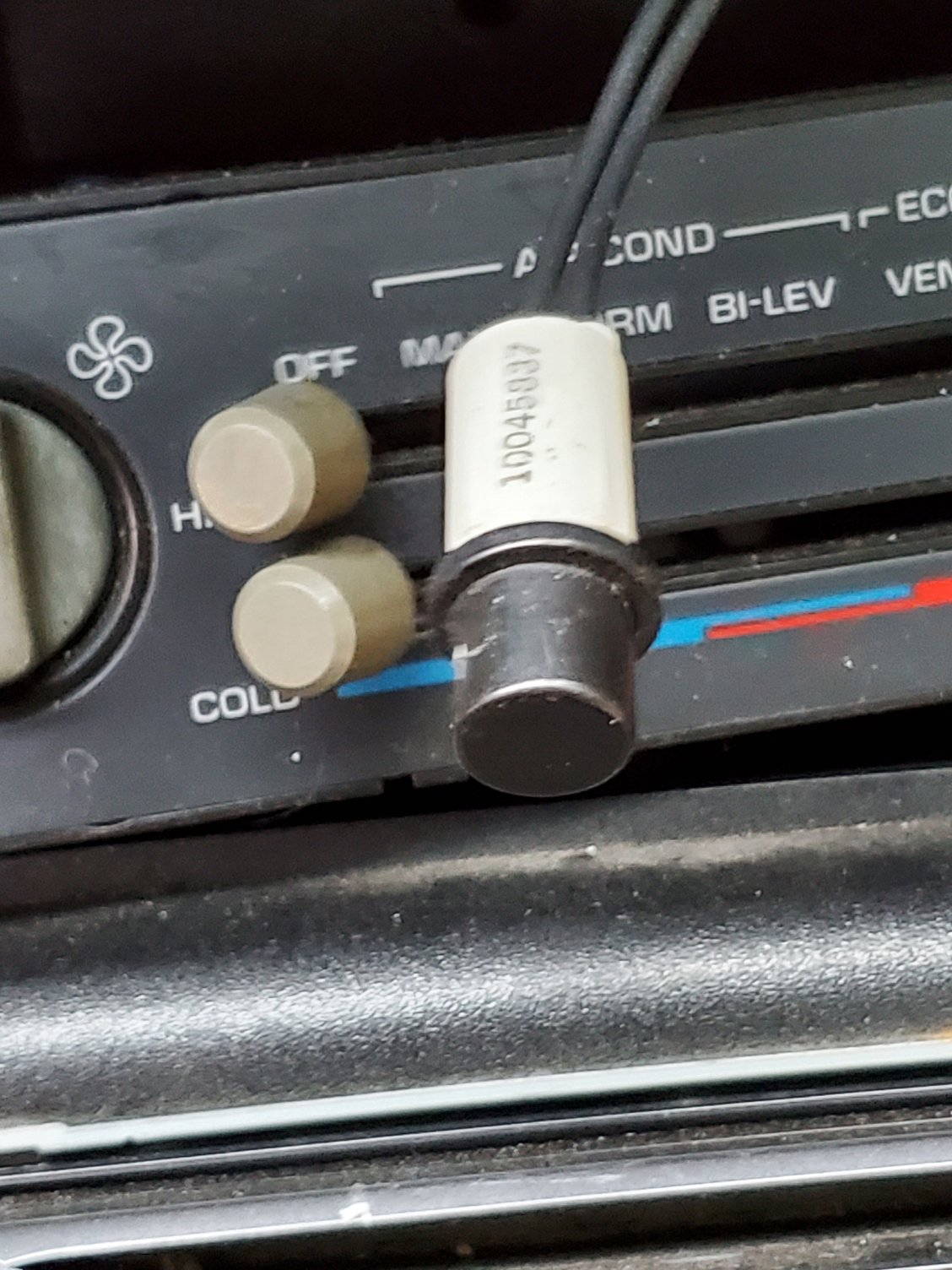

Good evening. This is the light thats shines over the HVAC and it doesn't come on anymore. How to you check or change the bulb

You unplug it from the harness and plug in a new one. It's a sealed light, the bulb itself isn't serviceable.

Could always install anything from a headlight switch light, to a marker light socket, or an LED to do the same thing. It shouldn't be a very bright light in stock form, the tinyest LED will be in danger of casting too much light.

yeah,i dont want anything to bright and i want it to angle downwards towards hvac

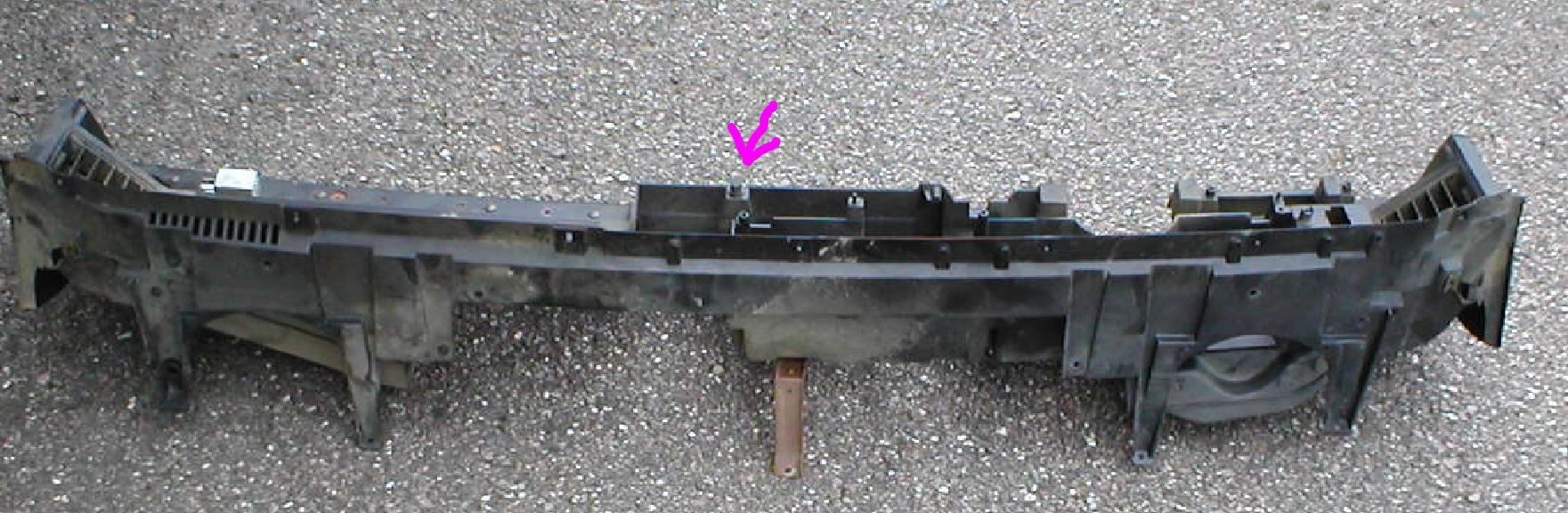

It's the stubby bit the pink arrow is pointing at, right? That pic is about 20 years old, but that dash shell is still in my attic. I might have to dig into the attic and see if the light is still there.

The book shows the Lamp, ashtray with the part number printed on the housing in OP's photo as 87-89. Which makes me wonder, the dash in my pic is from an 86, and as best I can tell it has or had the same light in it. Hmm.
