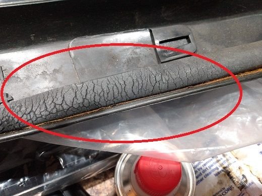

He all
So I am gearing up to get my interior fixed up for this spring/summer. My original pillars are in perfect shape plastic wise. However they both have an inside rubber seal that is cracked. See pic. Just wondering can I replace these seals and if so what woudl be best to use? A new pair is $139 listed on eBay. Trying to save some money!

I can't help directly, but I was just looking at those on my car this weekend. There are many companies that sell universal seals that could be made to work. I have found 90* L profile seals that I will probably go with. If you do a search you should be able to find something.
Alternatively, you could probably go to Home Despot and get a thick, closed cell foam, weatherstrip intended for home use that could be suitable replacements.

ok good to know. I will look for the same seals you are suggesting. thanks Scooter!

I can't find the site I had been looking at in the past. I was looking at an L profile for a secondary door seal for my 69 Suburban and truck.
Something like this should work though
https://www.zoro.com/search?variants...Rubber%20Seals
Oh wait, this was what I was looking at
https://www.trimlok.com/rubber-extru...iangle-section

the 2nd might be fine. Its obviously available being you can buy this pillars new with the seal on them already.

I found this:
https://therubbercompany.com/wp-cont...L-Profiles.pdf
look at number RCAP12X12L. Its 1/2" both sides. I emailed them to see if anyone can order a minimum length

You'll probably want to get a sample to determine if the rubber is soft enough to conform like weatherstripping.

Good point
The 3m seal Scooter listed is 233 bucks a roll. Might as well buy replacement pillars at $139 for the pair off eBay.

Or simply leave that strip out. It's not like it keeps water out of the car. It might make a minimal impact on the ability of the A-pillar trim to rattle, but it's more likely to fill the visual gap. Put a foam rubber donut between the clip and the hole in the sheet metal, and glue a strip of black paper the length of the A-pillar, and you'd probably have the same effect for a few bucks.

I kinda like the RCAP28X26L a bit further down in that link.It resembles more the stuff i bought from HD, but maybe not as thick.

Depends which adhesive you get. The other adhesive is much cheaper.
I was looking at that stuff for a different project
