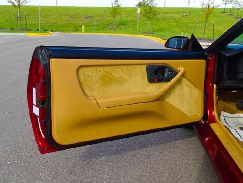

I just noticed that the 1987 -1989 TA's come with much better-looking door panels that 1990 -1992. I want to swap my 1991 GTA with these. Anyone know if this is a straight forward swap or will I need anything specific besides the obvious?

There is a different support on the door for the arm rest, but I believe they are a straight swap if you have the support piece.

It's not all T/A's in that year range, or even JUST T/As. Those door panels were optional on all Firebirds in the years they were available, GTAs came with them standard up until 90 when the cup holders came out.
That's it. You need the mating support for the arm rest, everything else is a straight swap. Done this myself years ago on my ex-92 Firebird.
