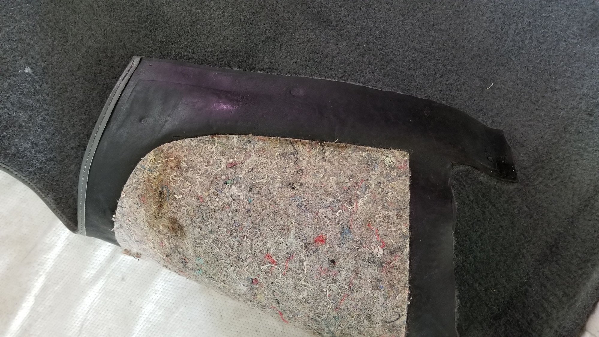

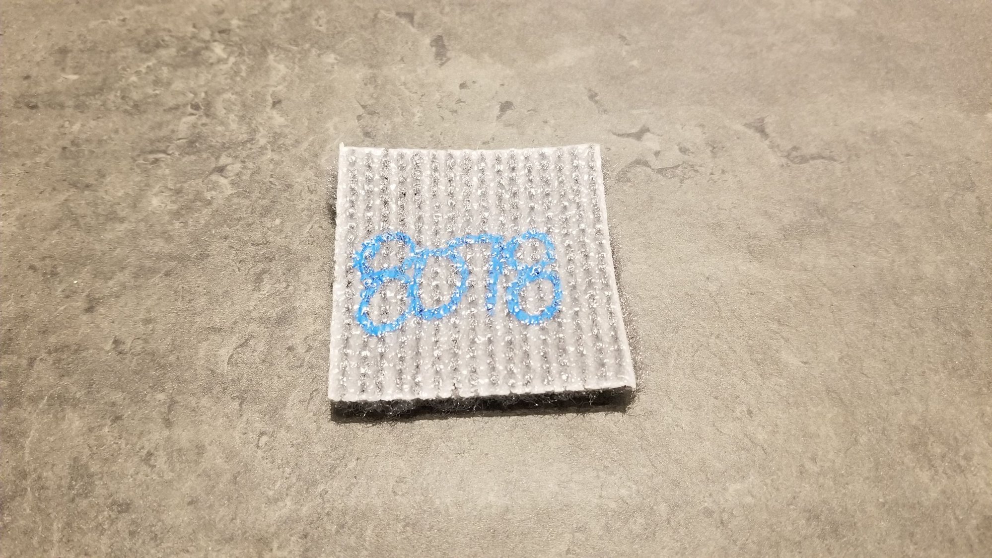

Jute is padding, not backing. It will come attached/glued to the back of the new carpet, as a standard feature, whether you choose the standard backing or the optional Mass backing.
The backing is a sort of semi-rigid plasticized material that the carpet is stitched/bonded to. Standard backing is as manufactured and is clear-ish looking, like on the backside of this carpet sample, I'd assume.
Optional Mass backing, which the factory carpet has, below,
and which I think most people get on new carpet, below,
is like a "rubberized" coating applied to the backside, kind of like being painted with Flex Seal lol. It's considered to have sound-deadening and insulating qualities.
But whichever backing you choose, the jute padding will come attached to it, as you can see in the two picture above. And the thickness of the jute padding is sufficient, far less of an issue than poor workmanship of the finished carpet, itself.
