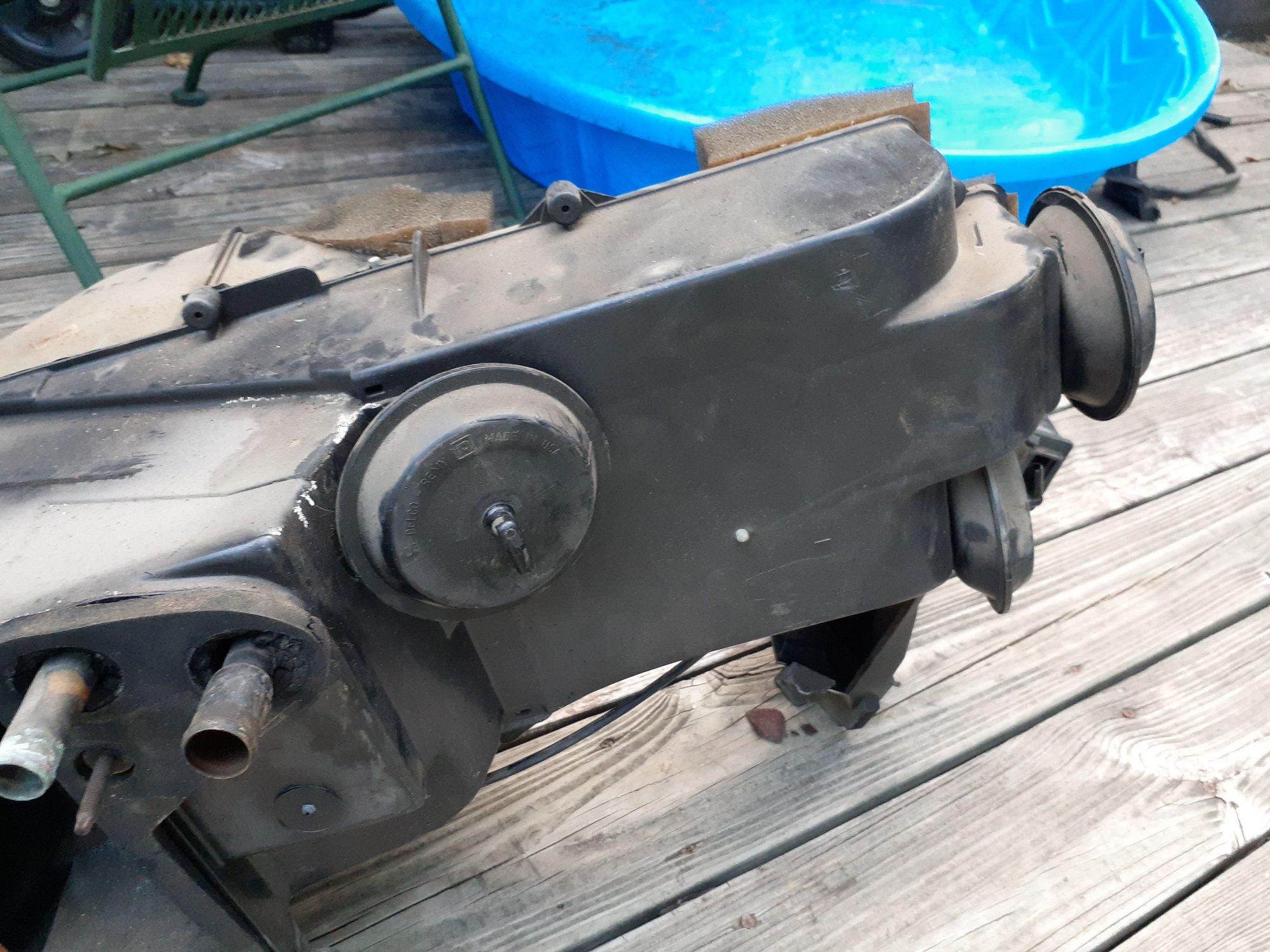

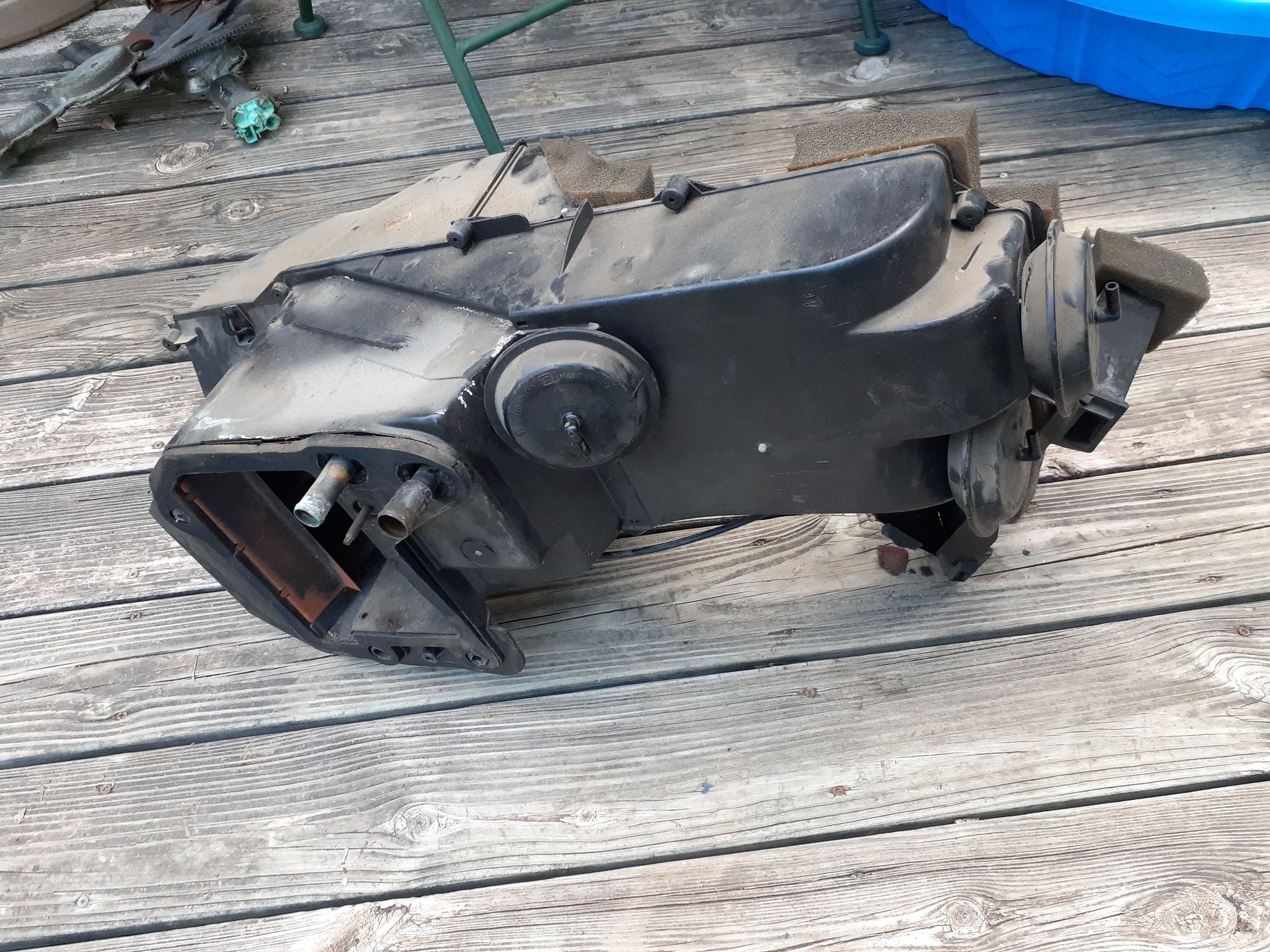

Which part u talking about? I just took off whole assembly heater box from an 88 IROC.

The lever you see on the video with the cable is what I need that's missing. It has a round flat washer that fastens it. That's the picture you see. In your pictures your box looks different or there isn't a picture of the bottom of the box. Thanks.

Send me a pic of the video on the part you are talking about

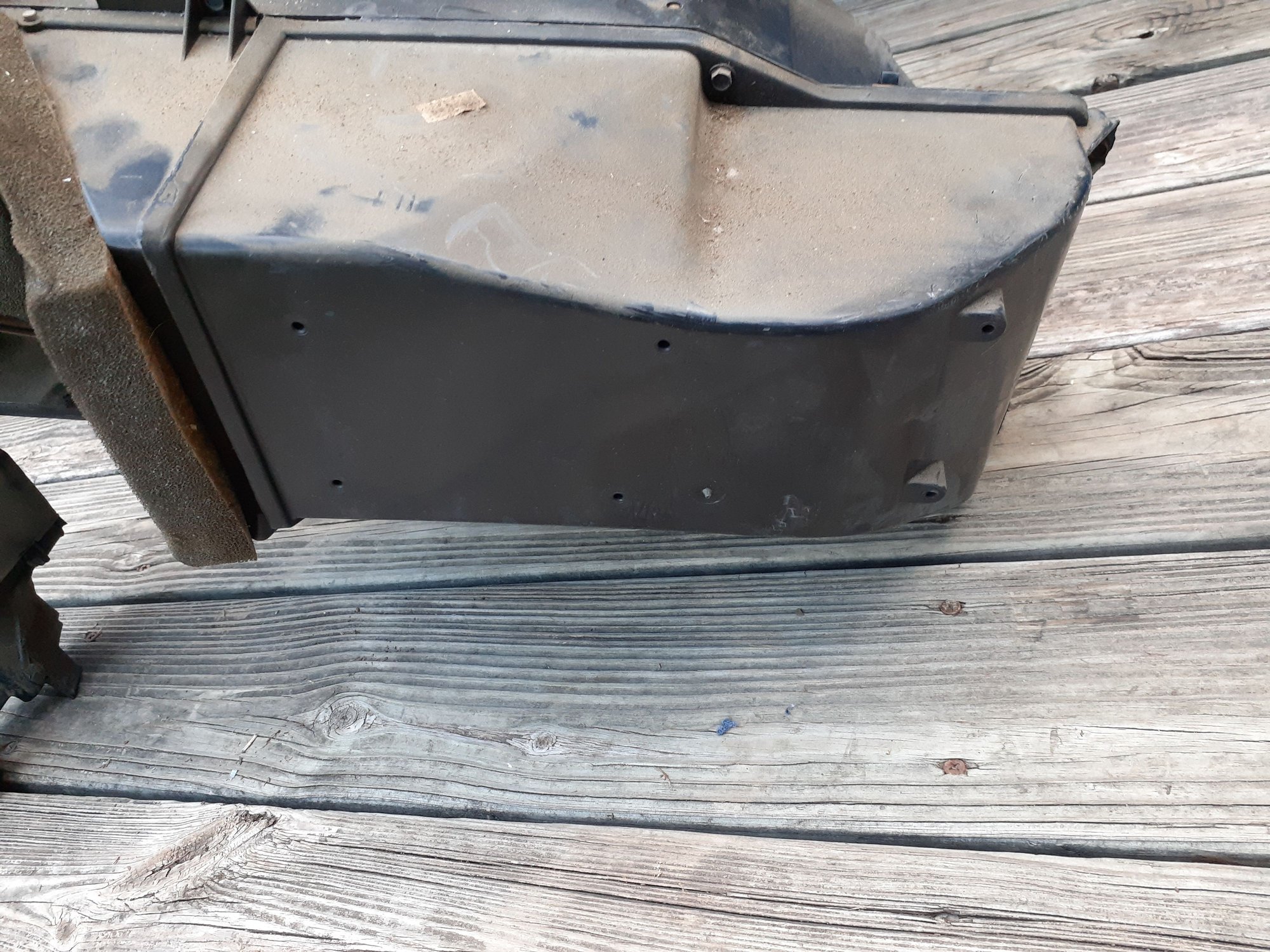

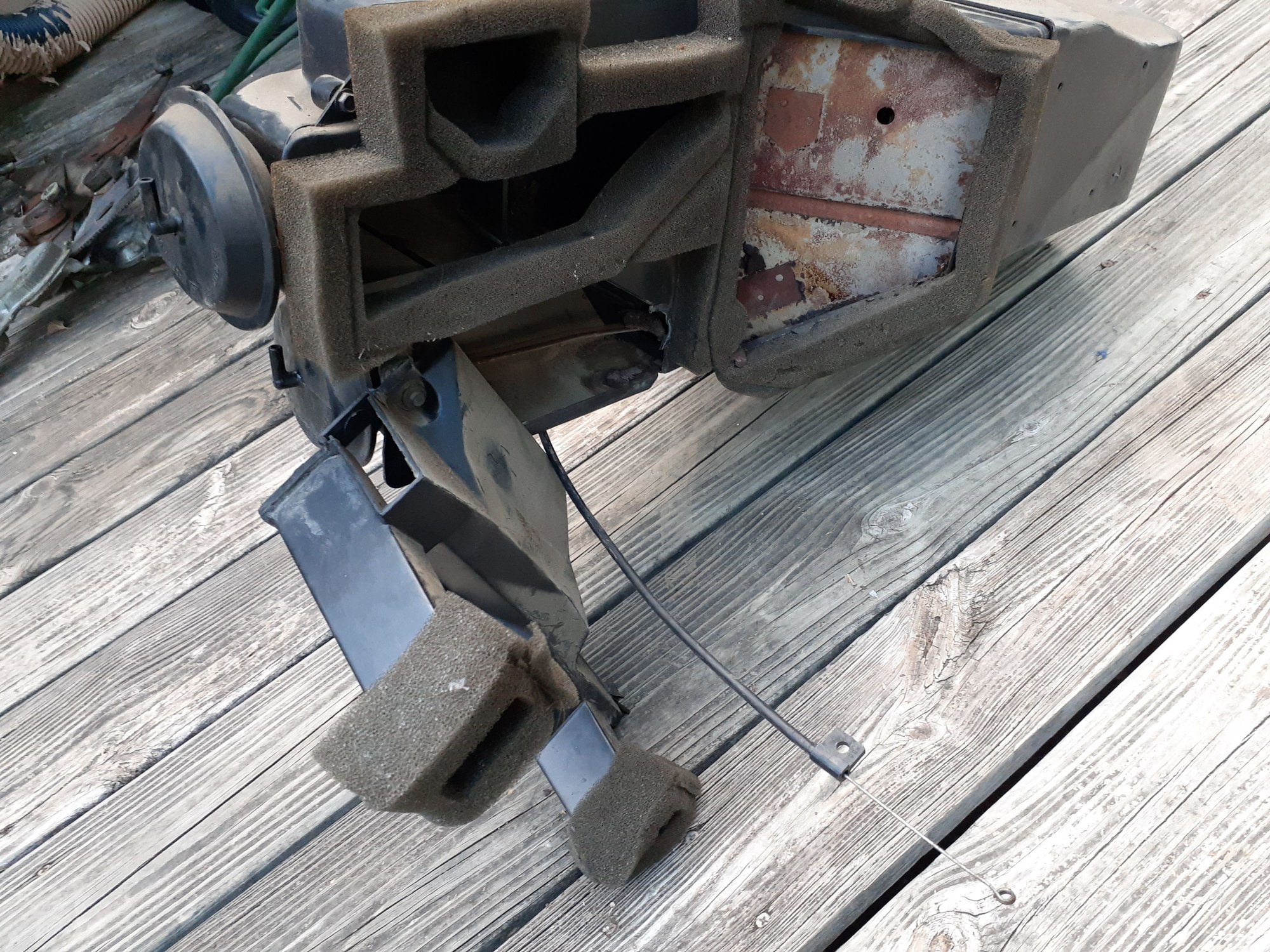

Are you talking about the bracket that the cable is clipped to

Yes that is the part seen in the 3 pictures. The bracket in the video I watched shows it with 2 studs about an inch apart which makes it a Y shape. It only needs one stud since there is only one cable that attaches. I know the rod that sticks out has a D shape. It sounds like it isn't reproduced but since it is pressed on it looks like I need to find one on an old heater box. I'll have to think about how to make one also.
