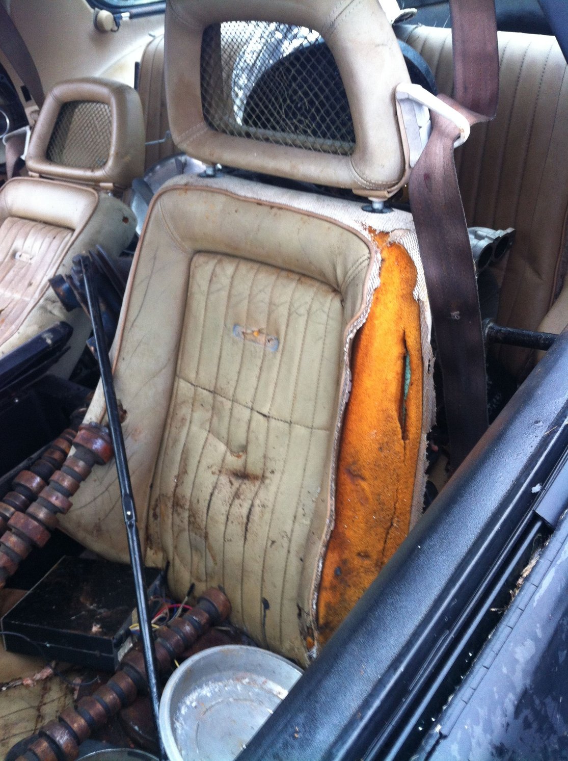

The donor car:
After TWO failed (40 mile) trips to get the seats, beaten by unassailable rust on the seat tracks both times, I managed to rescue them. As I was loading them up that night, the tow truck showed up to haul the car off to it's scrap yard grave.
RIP.

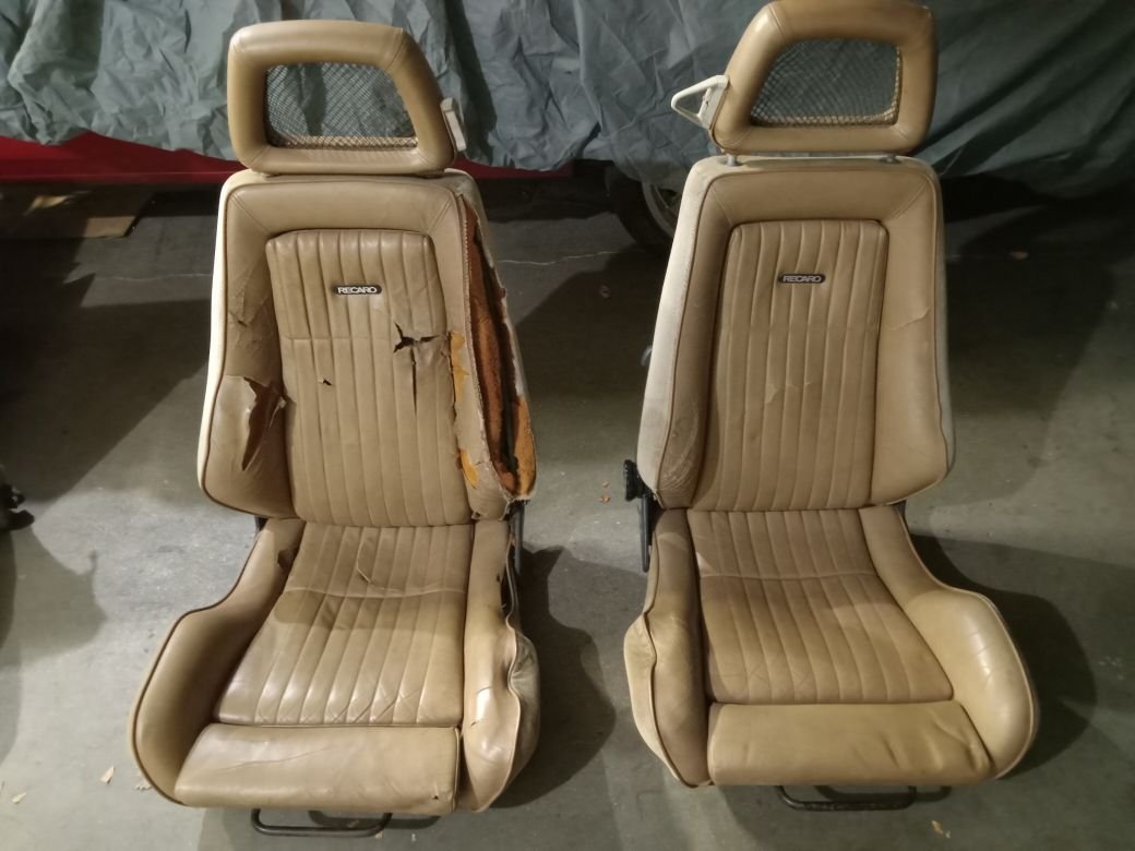

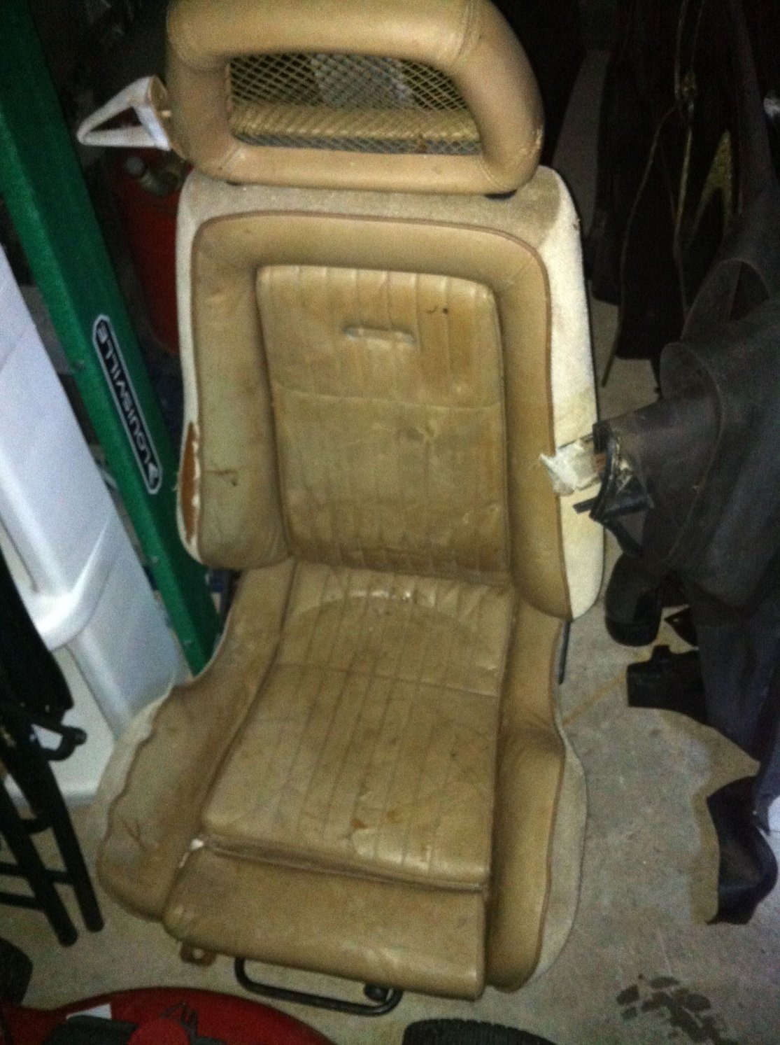

I got home that night and looked them over. They need some major work, but even in their current state, I feel vindicated for years of searching. I used to think it was stupid that Pontiac marketed a Trans Am named after the seats. Now I kind of get it. Back in '84, these had to be amazing.
40 years, and many owners later, and there's some wear, abuse, and missing pieces. Clearly they need bolsters, covers, trim, and paint. Maybe more...but there's potential.
I wasn't able to find any comprehensive resources for Recaros on TGO or really anywhere on the net, just sporadic threads and comments. Parts were never that common to begin with, and all of them have been long-ago discontinued.
I'm confident that I won't be finding another set to exploit for parts, and won't just be able to go down to Walmart to pick this stuff up. But some baseline research tells me that other brands have used the LX base as a seat (Fox Mustangs, VWs, etc.), so I'm banking on some parts interchangeability between those and the T/A versions. That expands the pool of options. Everything else will have to be improvised.
So I'm going to document the restoration in this thread. Lots of pictures, lots of details...should be fun (except for the bank account). And hopefully it can be a resource for others.

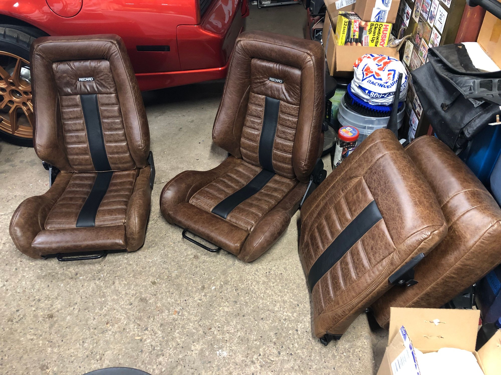

You should’ve taken the whole car. Looks like it had lots of good parts. The 82-84 birds have a lot of unique pieces that aren’t easy to find anymore.

Totally agree, and if I had a place to keep the car, I 100% would have. Was a damn shame to see it go.

if youre on social media the recaro seat groups have been helpful. I ended taking 2 rough pairs to make this one good pair. Cost me 1400 for front and rear at my local shop.

The other thing to possibly do is find an upholstery shop and see if they can make new covers from those. Carefully remove them from the seats and you have patterns for the new ones, time consuming, but is one way to make new covers. In the past I've removed all the stitching and than laid each piece on the new fabric, traced it and cut it out. I had a friend that had an industrial sewing machine sew them together.

that's exactly what my upholstery guy did - he used the existing covers as templates to make new ones. i decided to customize my seats and make them look a little more modern.

Those turned out great. Color goes well with the paint, assuming they're in that T/A.

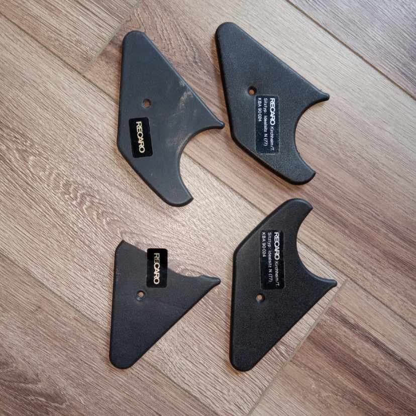

As expected, there aren't a lot of spare parts floating around for these seats. And there are a ton of variations on the LX style seat, with each version seemingly having different trim (shapes, mounting areas, etc.).
After some hours of research, turns out that some of the older 80s BMWs had similar seats from the factory. The BMW crowd calls them "E21" (I'm assuming it's an option code of some kind).
And good news is that the side trim on the seats is identical to the Trans Am versions. Bingo.
They actually share the same Recaro part number printed on the inside: 079.40.356.00.

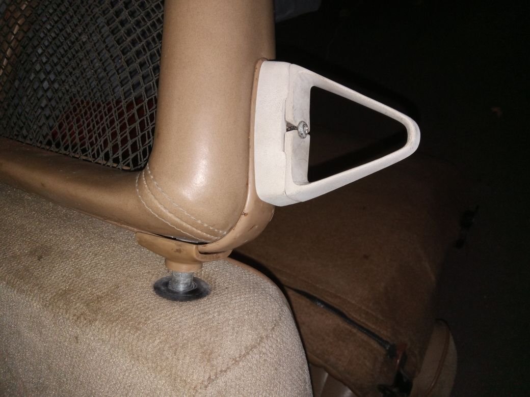

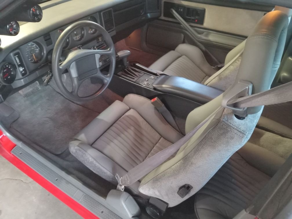

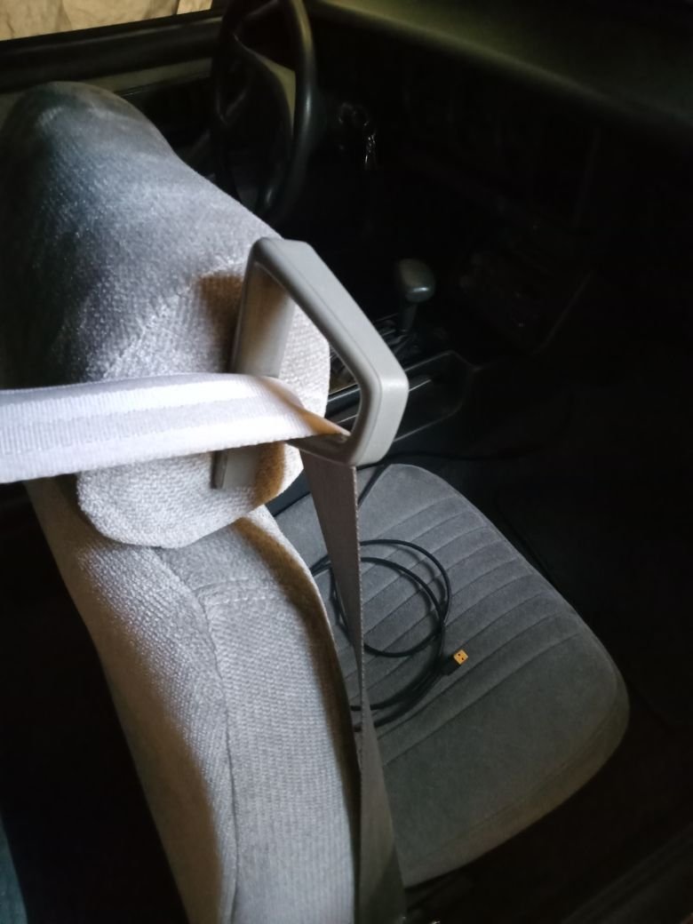

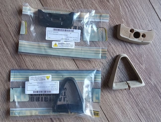

Next problem is that the seat belt guide doesn't match anything I've seen on a third gen.
Here's my Formula:
And here's the Recaro:
This one wasn't as difficult. The Recaro guide is the same style as the two-piece '76-'81 F-body parts, as well as a host of other late-70s GM cars. The left and right sides are different.
Classic Industries had them to me in less than a week. Cross another part off the list. Just need to find the right shade of interior paint to match my '89's medium-dark gray.

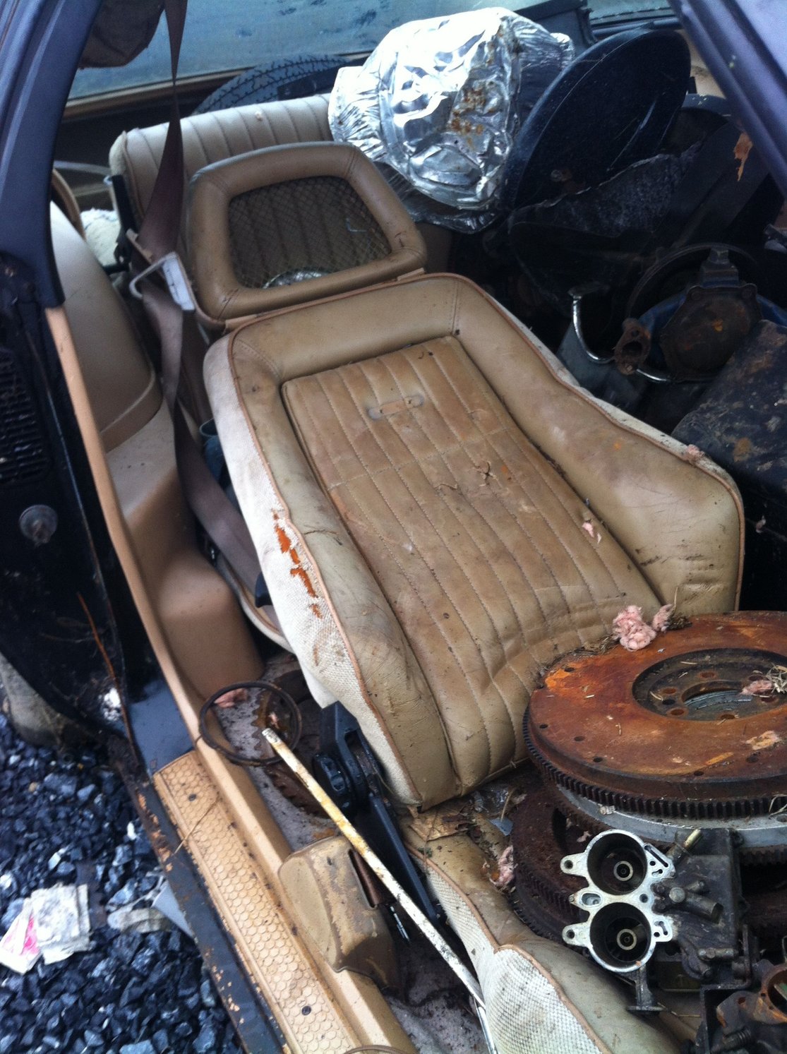

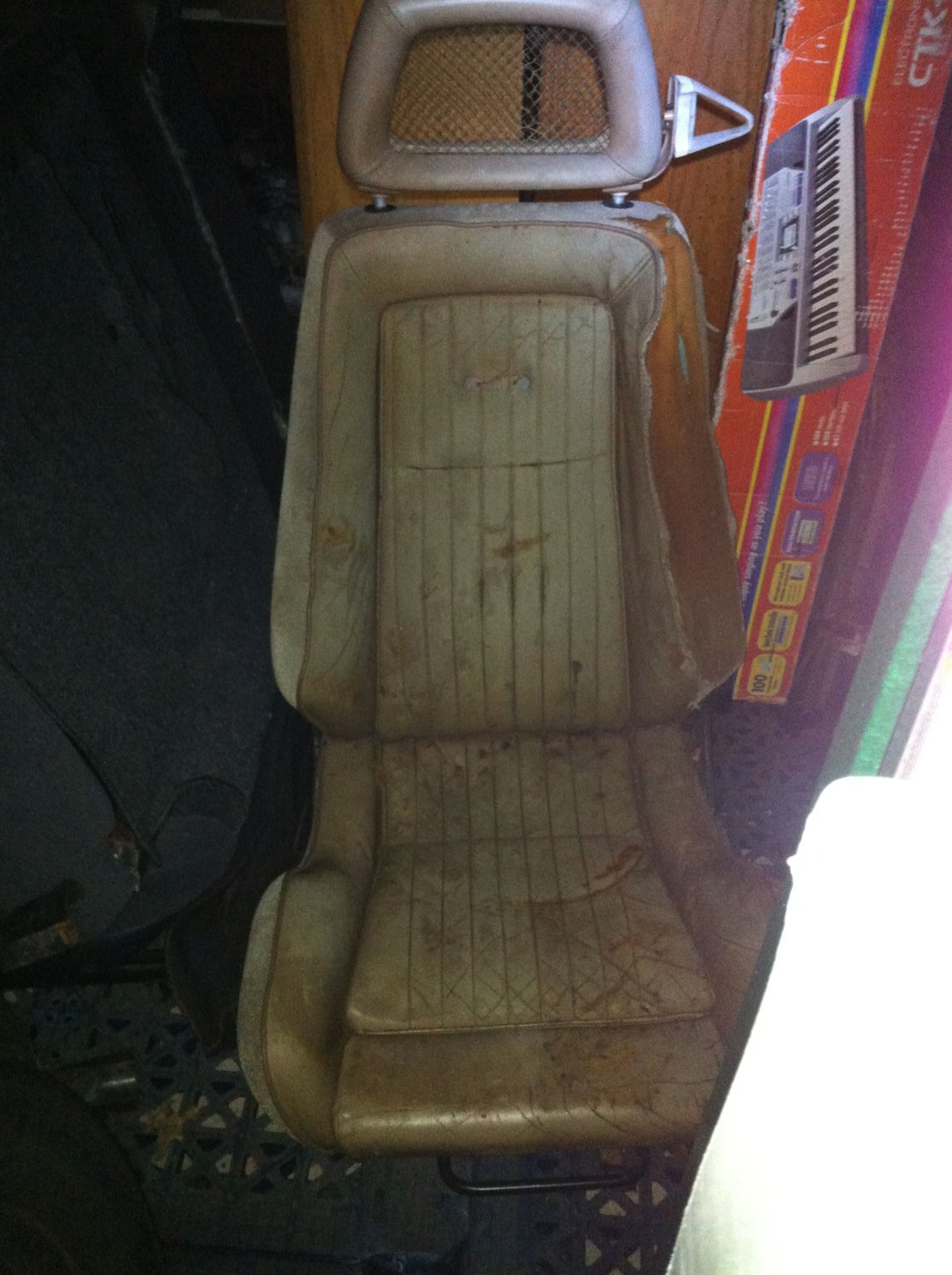

About 10 years ago I stumbled upon an 83 Recaro trans am at a junkyard about 2 hours from my house.First attempt to get them out failed due to the studs in the floorboards spinning.Came back the next weekend with a sawzall and cut them out.Cost me a whopping 10 bucks a seat.
They are still sitting in my shed as pictured

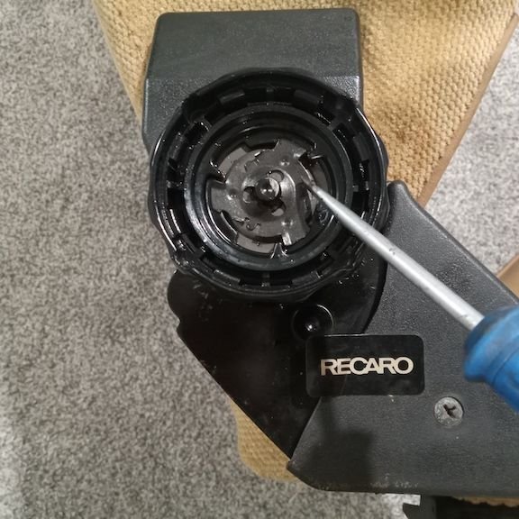

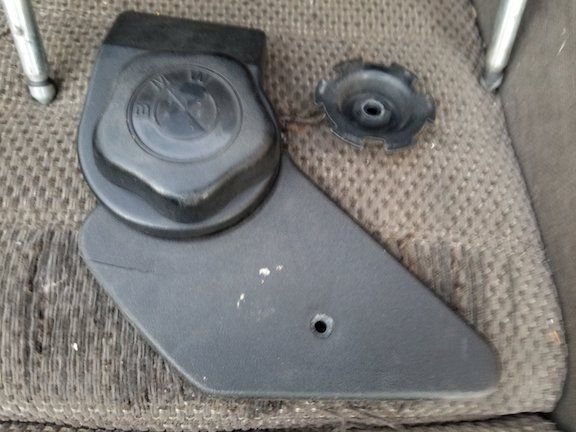

Some of these parts are HARD to find. I didn't appreciate how many different iterations of the LX seat were out there, but they're virtually all different.

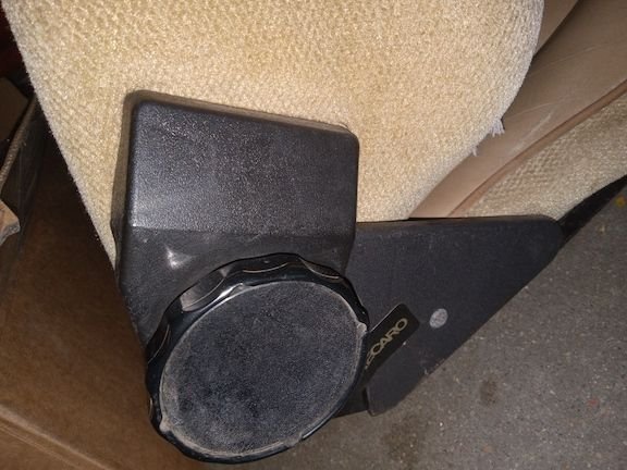

My driver side seat is missing the recliner ****. I was hoping that the BMW seats had the same **** to make things easy, but no dice.
Here's the T/A Recaro:
And here's one of the BMW's. There are about three different versions on the Bimmers...none of which match.
The recliner on the old Mustang seats is more of a triangle shape and isn't close either.
Days of searching later and finally found a match. Turns out some 80s Porsche 911s had the Recaros and an identical ****. Part number is 911-521-381-02. A company called Suncoast makes a reproduction also- part number SKUSK91.
https://www.suncoastparts.com/produc...gL7Zosw_xnnwm-
After some trial and error, I discovered the only way to get the **** off is to hold the retainer spring with a screwdriver (don't break it, you won't find a replacement) and turn the **** clockwise until the retainer drops into the recesses.
Hope this helps someone in the future!

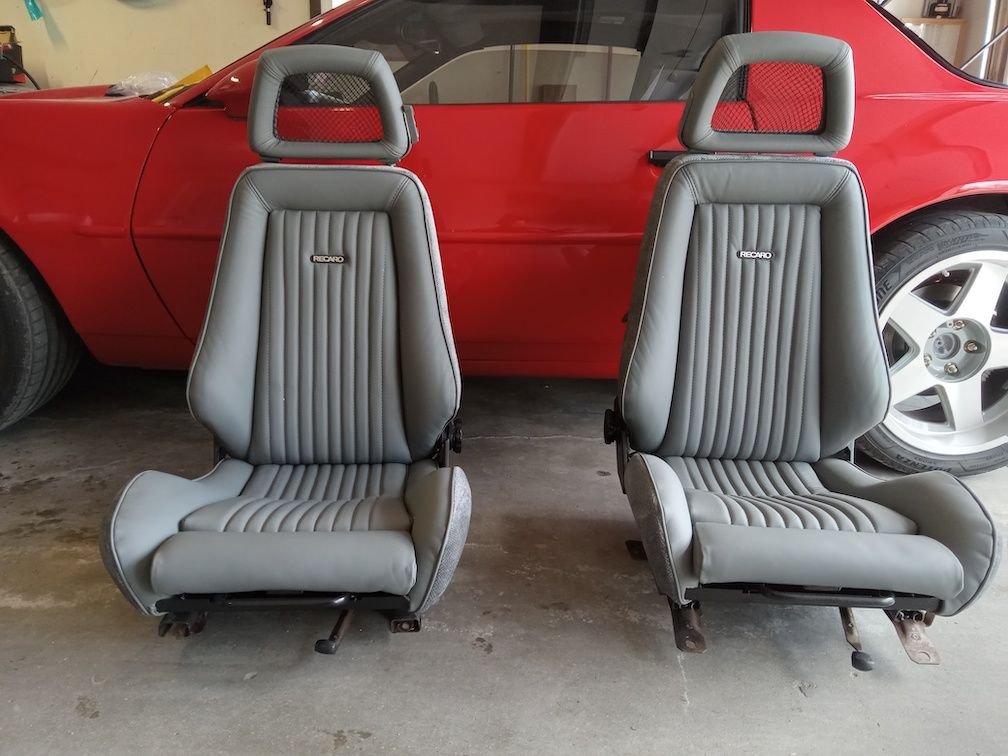

I made a call to Dave Varco at Aardvark Racing in CA. He had all the remaining trim pieces I needed, but he also mentioned that he does upholstery work on the VW and Porsche versions of these seats.
His quote was about half of what I got locally, and price was much lower even shipping back and forth from Nebraska to Southern California. A few months later and they were back. He was able to duplicate the exact look, with the factory-style combination of leather/vinyl, pallex cloth, piping, and carpet (back seats).
I'm super impressed with the work, and would recommend him to anyone looking to get Recaros redone in 2025.
Before:
After:

Wow those look amazing.

Looks good. Now that you've exposed his excellent work, and that he can get Pallex cloth, he might find himself getting more 3rdgen work. Did you give him such a heads up? Is he willing and prepared for that? A search shows Aardvarc Racing as permanently closed, but this came up, and it's at the same location.

Those turned out amazing!!

VERY well done! May have to give him a call, have a project i need done.

That is awesome! Your seats look great! Recaro seats are difficult to refurbish. I hope the Aardvark shop gets business from thirdgen owners now that you’ve shown what he can do. Recaro know-how isn’t common, and he seems to charge a reasonable fee.

Wow! Nice job!
