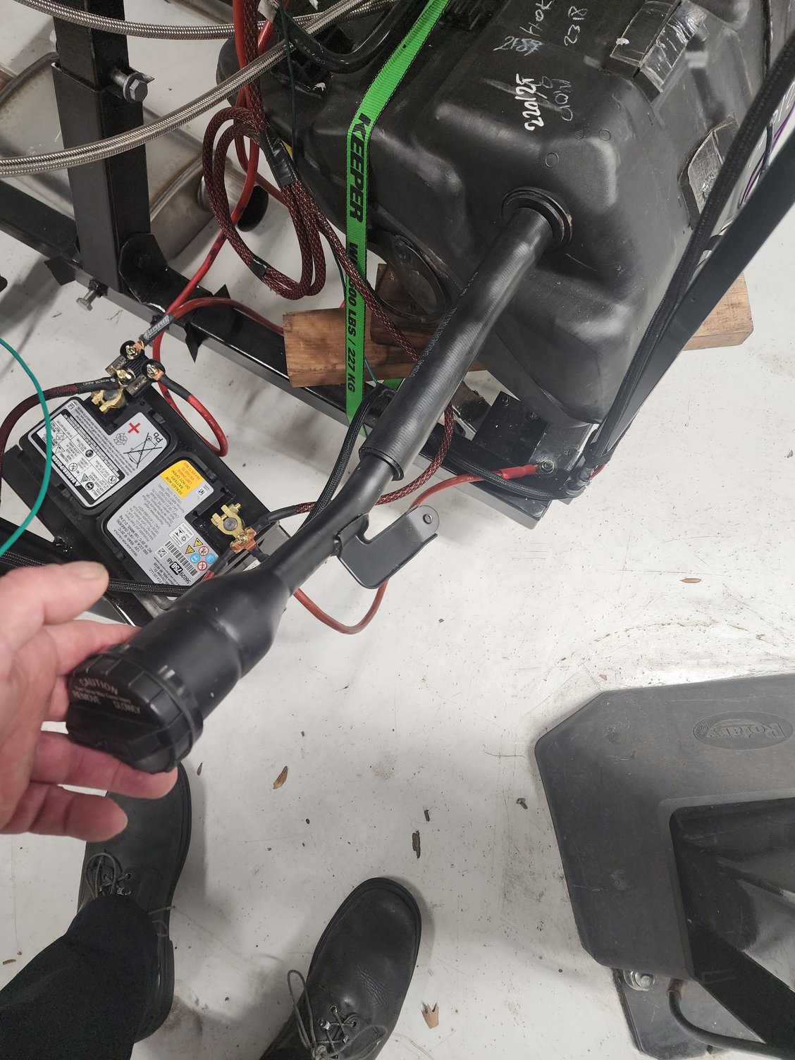

Well I found a solution that requires no modification.
Purchase the metal fuel filler neck and fuel cap from O'Reilly's
Precision Fuel Tanks Fuel Filler Neck - FF1022
Stant OE Equivalent Emission Control Fuel Cap - 10836
Then go to FillerNecksupply.com and purchase this filler tube:
Rubber Fuel Tank Filler Hose D125L10B01
This tube has a smaller end on one end to fit the filler neck and large one to go on the tank.
Perfect fit. Hope this helps anyone else that runs into this issue. Took me weeks to find the right parts.

Old Mar 9, 2023 | 03:05 PM
Blown_WS6's Avatar
Joined: Sep 2021
Posts: 109
Likes: 11
From: McKinney, TX
Car: 1991 Firebird Formula
Engine: L98
Re: 4th gen gas tank into a 3rd gen???
I forgot to attach the picture of the semi final product. The fuel tank isn't in the car yet but the angle and length matches the old 3rdgen tank filler neck perfectly.
