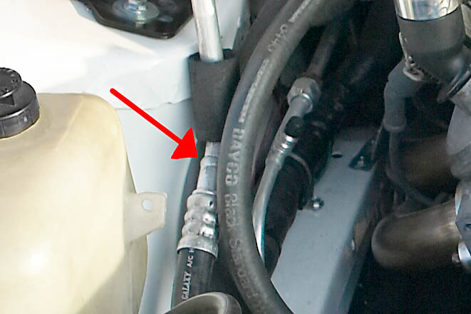

I dont have any real good pics of the lines on their own but this is a cropped out engine bay shot that I have from my appraisal and you can kinda see it. The other line is literally just one inch of line and the fitting from the third gen welded onto the LS1 line. I think I cut about four inches and a bend off the LS1 line there. I'll take some more pics of the entire project soon so if you want more just ask.

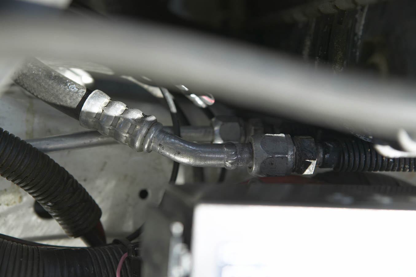

I used the stock LS1 coils and mounts. I made a small notch in my heater box with a zip cut and bent a piece of sheet aluminum to cover it. Riveted it in place with silicone then painted the whole thing black. So much gack in the way you cant see it so no pic sorry. It was soooo close I might have been able to get away without notching it but I did it anyways. Heres a couple more pics of the ac lines.

So heres one last pic showing the routing of the lines. I have some nice factory clips that go into the fan shroud bolts that held the stock A/C lines beauty **** but i cant find them hence the foam tape and ty-wrap solution there. I highlighted the lines as it was difficult to see what was what so much gack in that spot. Its tight in that corner but nothing rubs and from the top it looks great.
