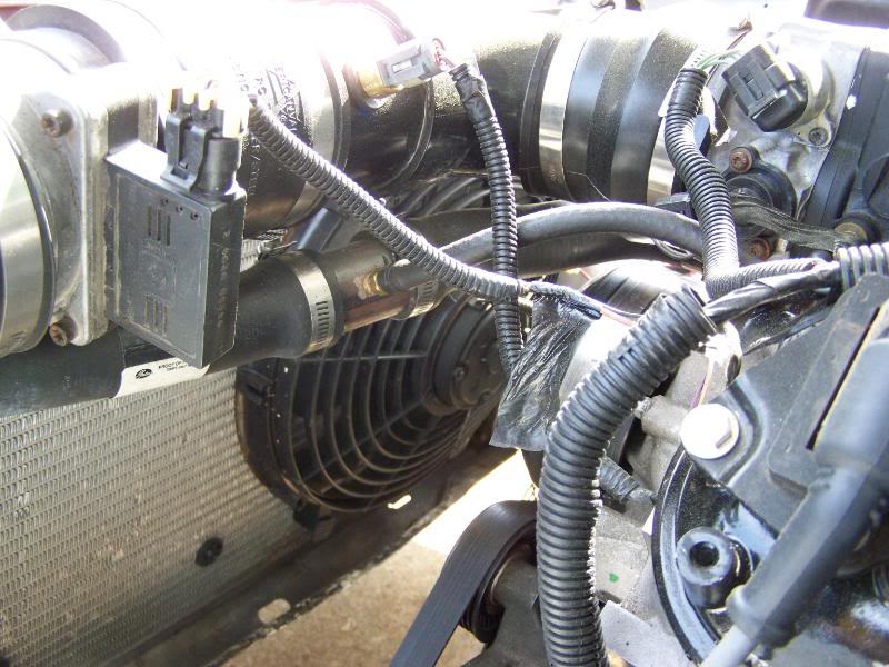

is that a GTO power steering setup? does it play nicely with the f-body stuff?
GTO CAI as well?
what upper rad hose are you using?

yes they are gto accessories. i used the iroc power steering pressure and return /cooler line. the iroc lines fit nicely with the gto power steering i did not have to bend the line at all. gto cai and it is the turbo trans am rad. line(i got the part number here). the gto accessories work well except the alternator plug is different than the fbody harness.

turbo transam upper radiator hose eh? hmm...that may just solve my upper hose problems.
how are you running the coolant purge line? where are you running it to?

i did the waterpump mod for the coolent hose.

oh, is that what that little nipple is on the top of the water pump?

yes. it connects with the coolent crossover.

i'll do that when i get my new upper rad hose, lol! i used a 01 camaro upper hose, and made a manifold for the coolant purge to go into with some 1 5/8" roll-bar tubing, and a brass nipple, then i spliced it in to the upper rad hose. wasn't a bad idea, but it's not the best way to do it i don't think. it's not very clean looking, and i had to stretch the crap out of my rad hose, and i think it compromised the integrity of the hose. one of the cool things about these motors is that they are relatively reliable per the HP they make, so i want the car to be reliable enough to make a decently long trip (at least a 3 hour one) no reason to do things that will cause reliability issues, ya know?

I digress... Im using the 4th gen rad...so steam line hook up was easy for me. However..I hate that steam line. Its two different diameters of hose. So its clamped in the middle. And it runs across all the other hoses. Ive been trying to figure out a good way to clean that up, but havent really gotten anything nailed down.
