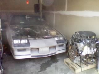

Well... Here it is. The 305 must wait until I get a cherry picker, but for now its alright. Ive got LOTS I can do until then . Whatcha all think? The body is INCREDIBALLY straight! It may be 2 toned but it works. My engine has 71k on it. All together, Ive got less than 1000 into my "project". If I can find someone who wants to buy the CrossFire and ECM (or is it PCM... ), I think I can make back some of my losses.
