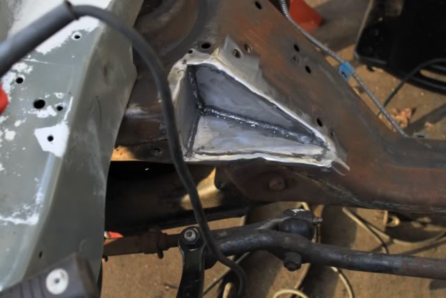

Old Feb 12, 2011 | 08:53 PM
hicksport's Avatar
Joined: Aug 2008
Posts: 77
From: Longview Texas
Car: 1991 vert camaro
Re: Pullin the trigger!!!
Ok talked with bruce at Hawks and I'm gonna order their complete system. I know it seems high$$$ but I just got to thinking about the system that I had on my 4th gen SS and I had about the same amount of money tied up in it and loved it. FLP long tubes off road y and 4 inch mufflex cat back. But for the begining Im gonna run these shorties and do a dyno run to get an idea of power, then install the long tubes and the full system to show the gains. Here are pics of the engine with shorties ready to install.

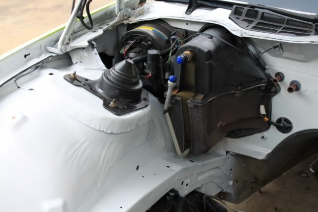

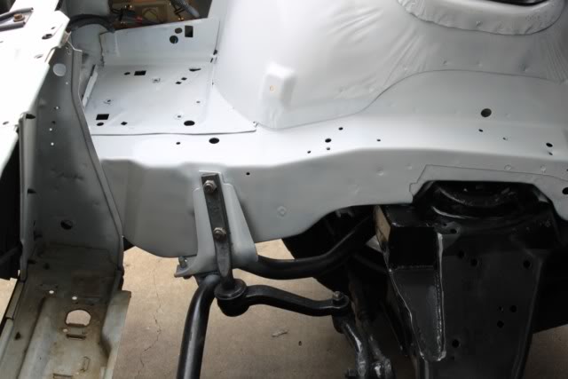

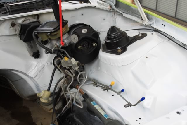

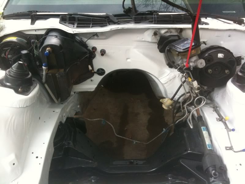

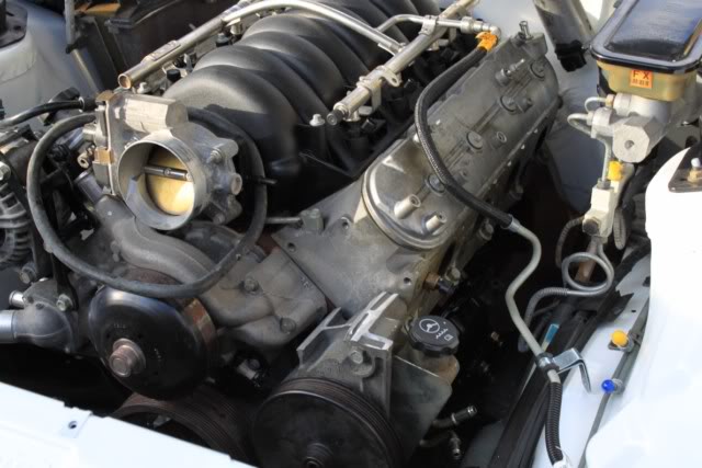

Old Feb 15, 2011 | 10:08 PM
hicksport's Avatar
Joined: Aug 2008
Posts: 77
Okay made alot of progress in the last two days, here are some pics!! I can't believe how well balanced the motor is on the mounts, very easy to rock back and forth? What have you guys been doing with cruise control and vacuum line harness?

I'd love to hear more about your accessory setup and alt brackets, and whatever spacer you needed to put the idler/tensioner pulley on the driver side.
Here's my stock LS1 compared to yours just for the hell of it. AC was removed in this pic even though I'm committed to AC in my car.
Also, what water pump are you using? The top hose exits at an angle compared to the LS1 pump.

Im using the LY6 truck water pump. Idk if you will be able to relocate your alt to the passenger side like I did. The LY6 has VVT which moves the front acc forward some. You can just set the alt on the water pump and put one bolt in it and then check for belt alignment.
The harness was just gutted and made into a stand alone harness, then I graphed it into my stock harness on my car. Nothing fancy.
