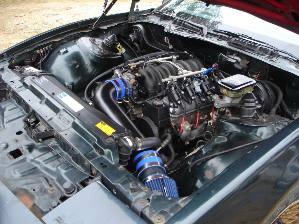

93-95 3.4 V6 upper hose. Put the long leg on the radiator and the short on the WP. Intake will fit underneath perfectly

Not a bad deal on the kit, quick glance looks like it may fit both the 3 wire and 5 wire MAFs. Mine was about $120, $30 x2 for the bends, $30 filter, $8 x2 couplers, $4 x5 clamps

Old Jun 29, 2011 | 11:17 PM
daddy33's Avatar
Joined: Mar 2003
Posts: 409
From: Cali
Car: '85 Camaro
Re: This air intake setup work for ls1 swaps?
Got that kit from ebay today. Fitment is pretty good actually, maybe a little tight though near the p/s lines. But $70 for everything I guess you can't go wrong. I eventually wanna get about 6-8" more of the piping and kick it out toward the fender a little more, then cut the tray area and extend it down there. Just kinda mocked it up for now though just to show you guys how it looks....
