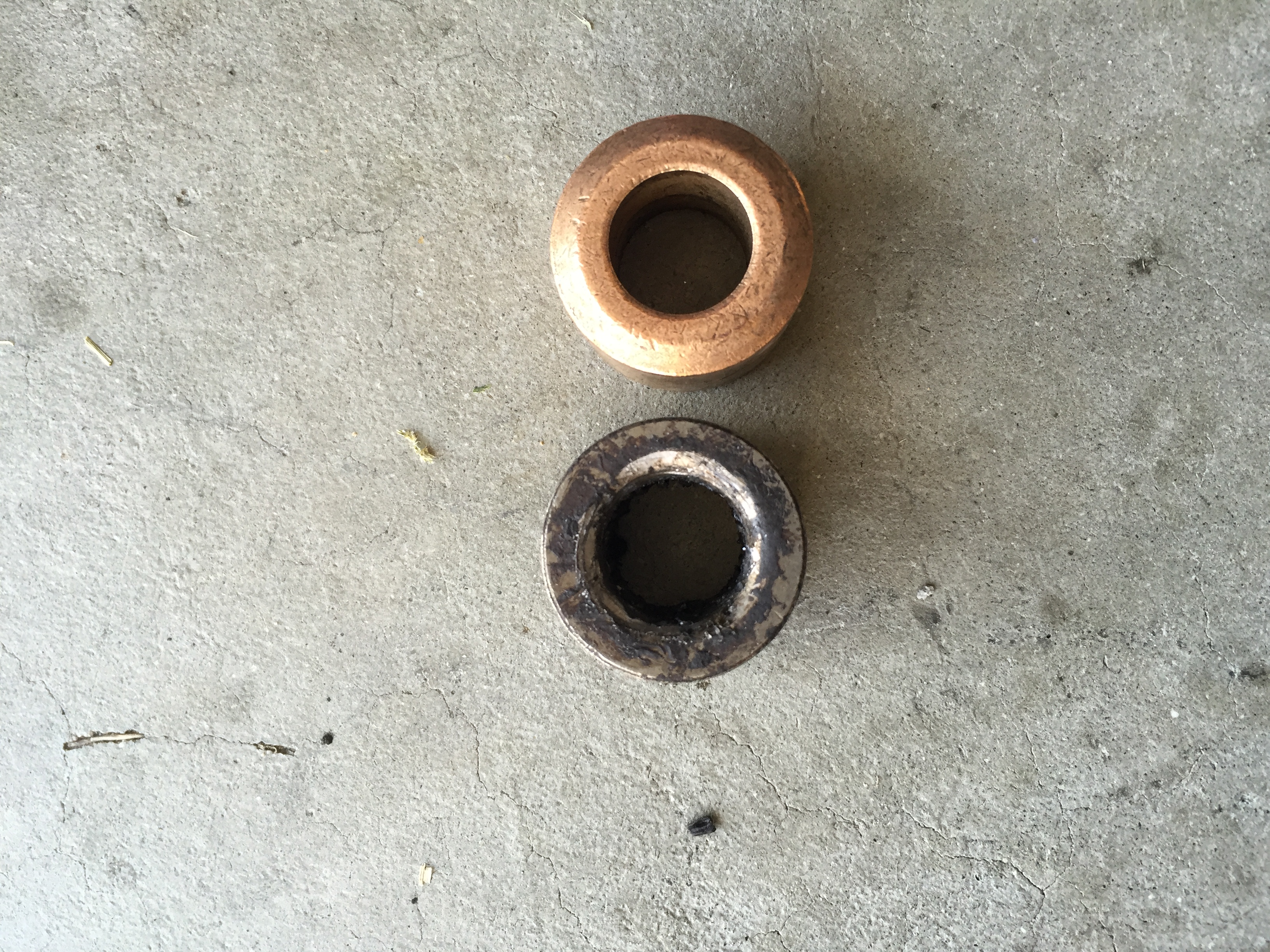

Update:
I woke up very early this morning, took the trans apart and found 3 out of the 6 pressure plate bolts were loose. The pilot bearing looked a little damaged on the front side from the trans shaft. Trans shaft showed no play. I took the complete clutch out to include the flywheel and took it to Clutch Masters in Rialto to check. They said the clutch check out fine with no problems. Also, the clutch has very little wear and in very good condition.
They told me to change out the stock pilot bearing and replace it with a (I believe) he called it a brass bushing?? It is a solid piece instead of the other with needle bearings. They also said, if they were to guess, the three loose bolts were the problem along with the damaged pilot bearing. They sold me the bushing/bearing and alignment tool.
I just installed the trans back in and it engages again at the stock location where it should.
Now to put everything back together.
I'm so relieved.

Pilot bearing.

Good to hear! Definitely make sure they are torqued correctly! I've gotten mixed reviews on the bushing/bearing, but I went with the bearing and made sure it was lubed up properly. /shrug
