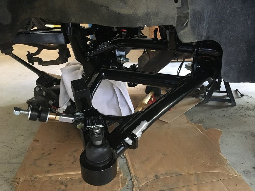

I also picked up the Spohn K-member kit for the full front suspension
Spohn-Performance
Car is near stripped right now, so we will be rebuilding the front end as soon as that comes. Hopefully dropping the engine in should not have any clearance issues with the oil pan.

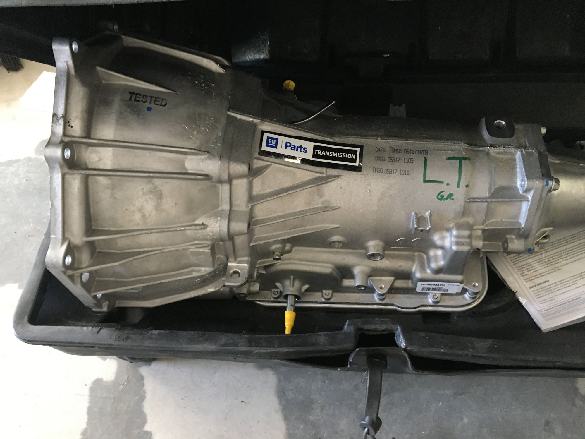

The EROD and 4L60E are here! I just got done tearing apart the front-end for the new Spohn kit coming later this week. We are also going to replace the steering center link and tie-rods as they were in bad shape. So all suspension and steering equipment will be new.
Also picking up a 4L60E crossmember, mount, and driveshaft loop from Spohn.

Just got the EROD sitting pretty in the IROC. Spent the weekend installing the Spohn performance Tubular front suspension kit and rebuilding the steering equipment with new ball joints, tie rods, etc.
The engine went in pretty easily. Driver's side exhaust manifold was tight against the firewall when we were trying to seat the engine mounts, but once we got lined up, it cleared it nicely.The engine has studs that stick up from the valve covers a good amount, of which, on the passenger's side, was making contact with the air conditioning box. We had to cut it back to clear and line up the motor mount. The only problem I see now, is the clearance from the fuel injector next to the AC box. Its close, and depending on which way the engine torques, might hit. We will see.
Now we are on to hooking up all the smog equipment, wiring harness, etc.

Looks good with the new suspension upgrade in there. What are you doing for the transmission back?

Thanks Jay and Robbie, yeah we are really happy with how it came out. The suspension kit really lowered the car, but it has a raising collar at the base of the coil if we want more height whenever. Really looks like a funny car at some angles. We need to get the new wheels and tires sized, but that won't be for awhile.
The Transmission is a 4L65E that I will be mounting to a Spohn Performance LSX/4l65E trans mount with driveshaft loop. The driveshaft will need to be measured and custom made later. Before I get there I will be swapping the rear end for a Moser 12bolt with new Torque arm.

Drive Shaft Pro, formerly Coast Driveline, is a very helpful place that makes very good drive shafts. I have gone to them on several occasions. For my current build I had to have a longer drive shaft made to hold me over until the motor and trans swap. They had one built in less than a day. I ordered it in the morning and had it installed before dinner. I am not sure if Ventura is too far for you, but I highly recommend them.
Edit: It was only a few hundred bucks to have it made.

I used Hawks piece w/ holleys blackheart system, good ground clearance, but the mounting holes barely line up, so some re-engineering is required.
