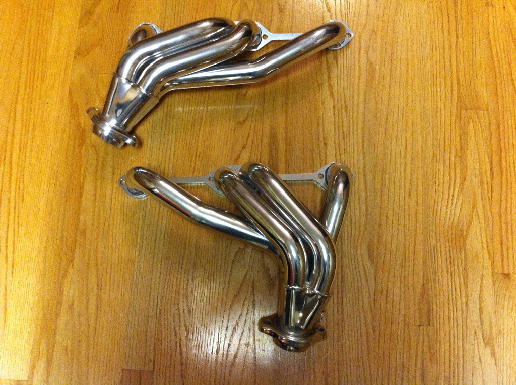

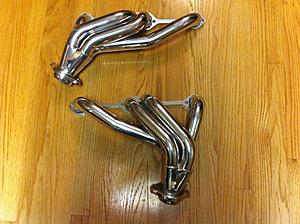

The headers I make fit LT1 "D" ports
Attached Thumbnails cant find LT1 headers???-headers.jpg   cant find LT1 headers???-dcp_1261.jpg
