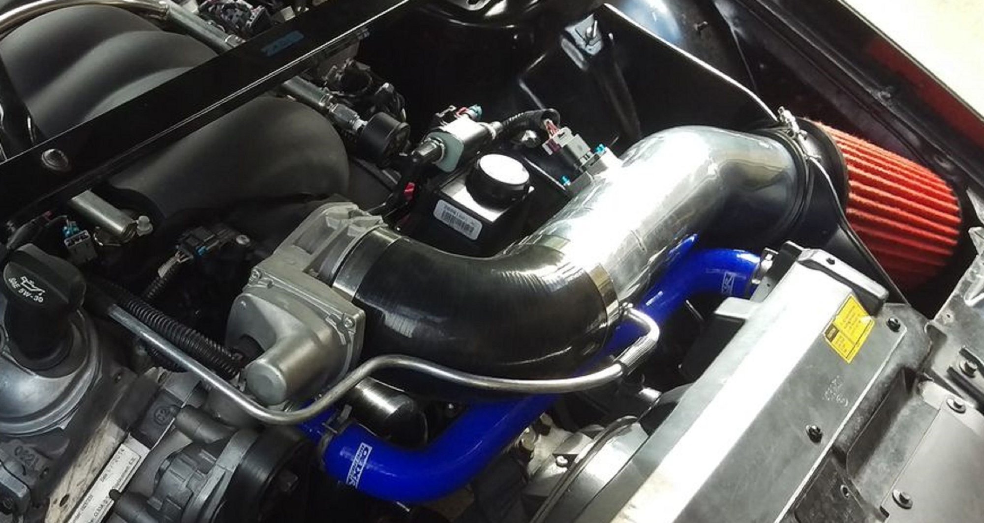

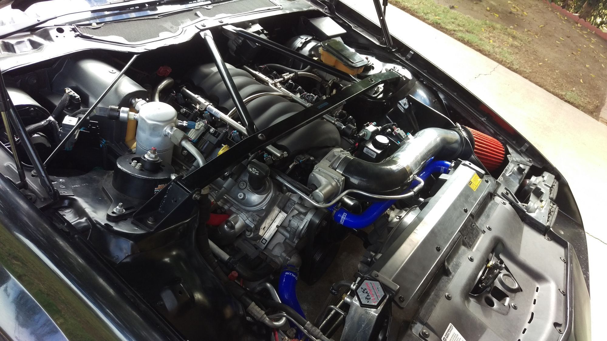

Re: Hawks 4" Air Intake Kit
Old Nov 17, 2018 | 08:03 AM
Big&BadGTA's Avatar
Joined: Jul 2013
Posts: 1,208
Likes: 153
Engine: 5.7L L98 TPI
Transmission: 700r4 Automatic
Those pictured all draw hot under hood air. Cut the battery tray and put filter under, behind fog light (on TA) and it draws Cold Air. The one I’ve pictured, I installed in 1991, Worked very well

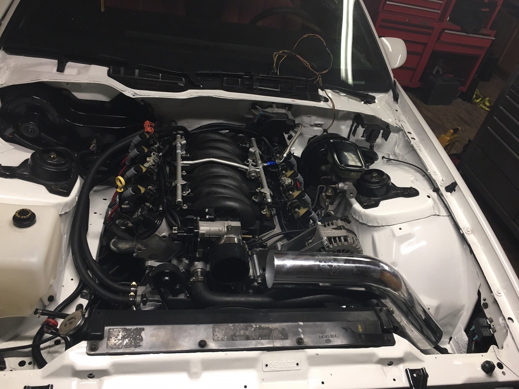

I like the silicon because it doesn't pick up as much heat off the upper radiator hose as the thin aluminum would, however it also heat soaks more and takes longer to cool if it does absorb heat off the radiator. Here is mine its a combination of parts, I started off with a ebay intake for an Escalade, but didn't like the cheap rubber boots. So the 90 degree reduces from the intake size to the MAF size in the 90 degree turn (amazon), the coupler from the MAF to the first straight pipe changes from the MAF size to the 4" (amazon) the next coupler came with the original kit, the 45 degree elbow was part of the original kit I cut down to fit. I had a much larger filter on the end from the original kit but ended up with a spectre filter (autozone) that has the outer cone as well as a inverted inner cone on the end so you have alot of filter area.
I need to get a different upper radiator hose or a small extension so I can pull my radiator hose closer to the radiator so its not touching the intake pipe. Ignore the heater hose... I'm not quite done there I'm installing AC right now and then will finalize the routing, but my engine is too close to run the hose down the back side of the engine so it looks like I will have to keep the eye sore. Also the wires in the back pass side I still need to finalize routing and loom them. I think I may paint the aluminum tubing and get someone to Tig on a flange I can bolt it to the wind shield washer tank (where the TBI intake screws on to it). I also want to make a filler panel to box it in so its not sucking hot air in (aluminum with some head shield). I have fuse boxes and the A.I.R. injection pump below the filter as I built it 100% 50 states smog legal... for now... I may remove the A.I.R. and EGR all together since I don't have to do emissions where I live. The IAT sensor I drilled a hole in the aluminum tubing and used the original bung from the donor car. Its on the back side (intentionally) so you don't see it.
LOL the flimsy rubber boot is in the bottom right of the picture.
