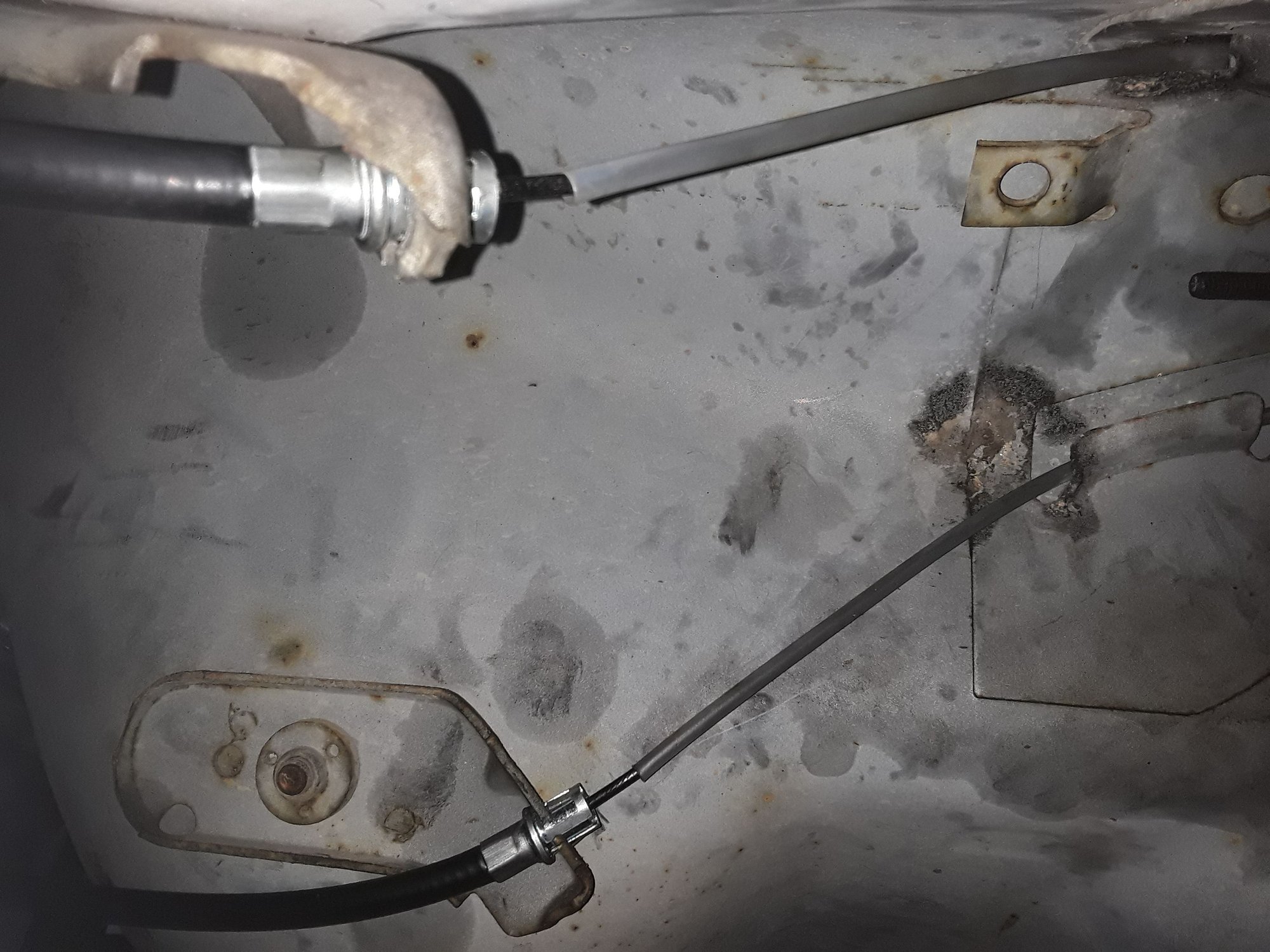

cool deal. I scored my rear for $300. What did you do about hooking the cable up? I heard some fabrication is required

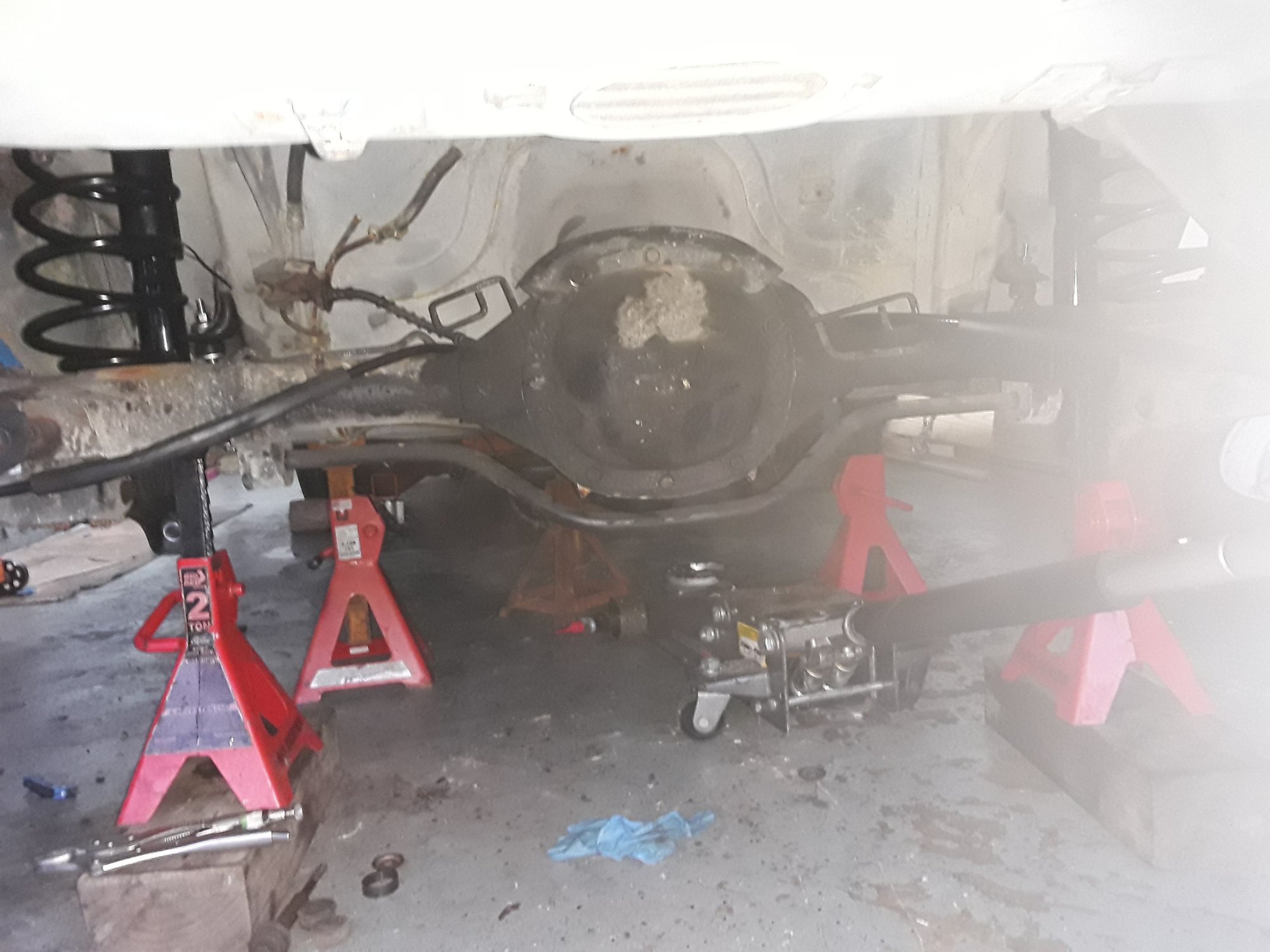

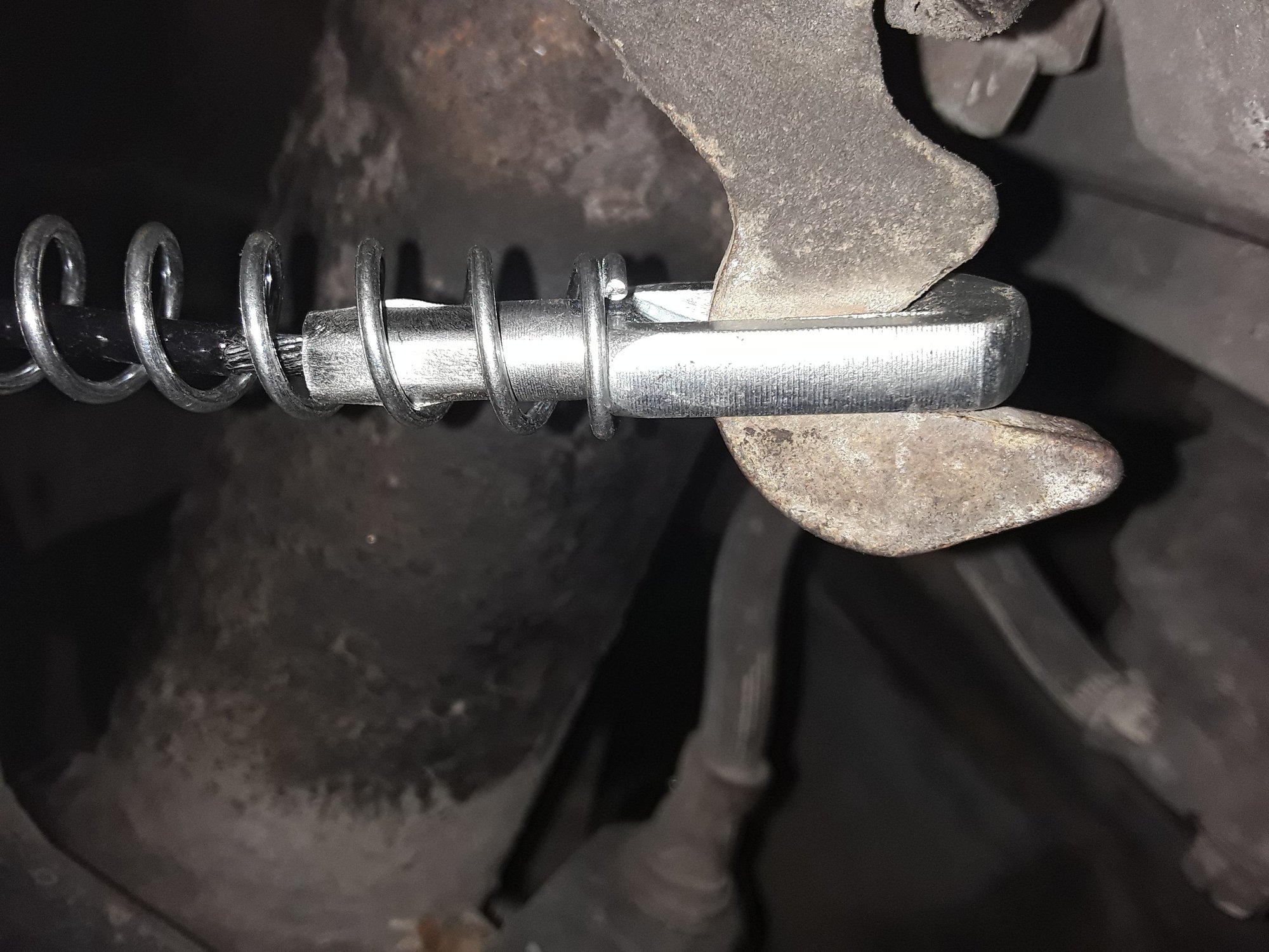

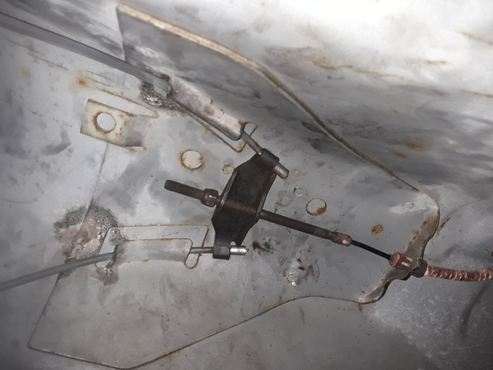

Re: Gen 4 rear end for ls swap
E Cables
ACDelco 18P1104
are a direct fit for this swap
