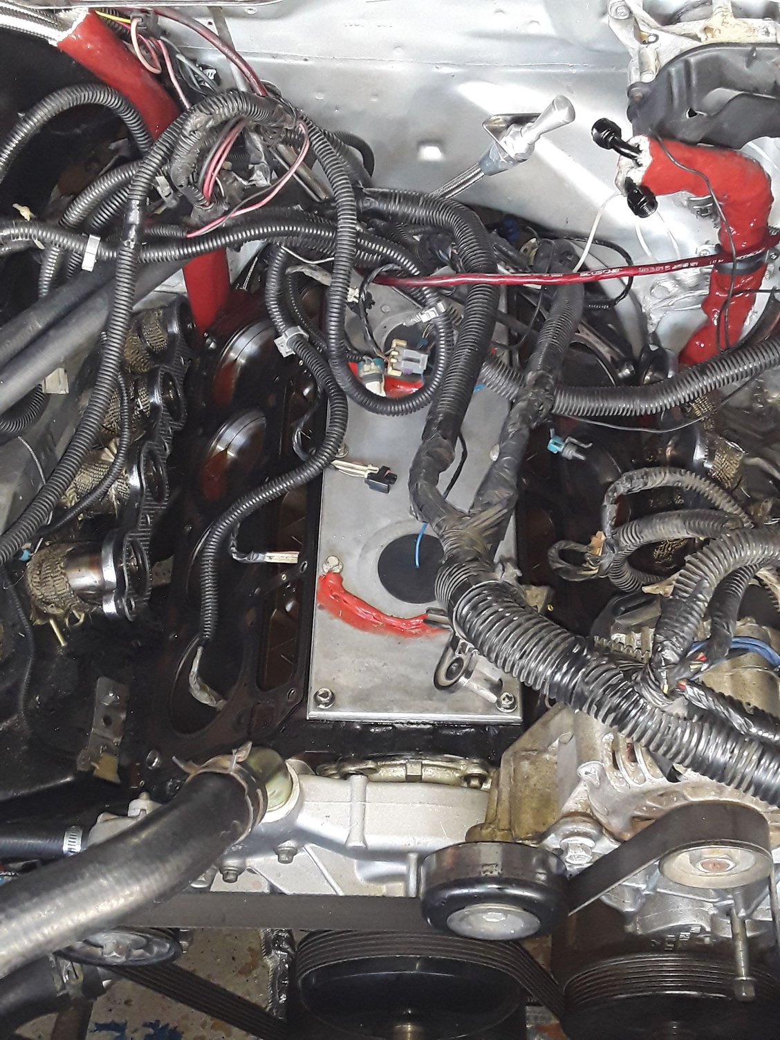

Originally Posted by dixiebandit69
Yup, I'm using the later oval connector with the pull-lock on it.
After doing a little research, I found out about the range sensor details we were looking for.
You and I will only be using the wires going to the PCM, and the ground. That stuff tells the PCM what position the shifter is in, thereby changing idle speed.
The following wires will not be used: 1 - Clutch start, 9 - PNP signal, 10 - Backup lamps, 11 - Ign. voltage, and 12 - Ign. Voltage.
As mentioned before, you won't be using this switch for reverse lights (unless you want to do things the hard way).
Clutch start, PNP signal, and power input #12 are all for neutral-safety starting. Once again, that stuff is handled by your factory shifter.
I didn't figure this out on my own; you can thank the guy who made this slick diagram on one of the classic truck boards:
http://67-72chevytrucks.com/vboard/s...92&postcount=8

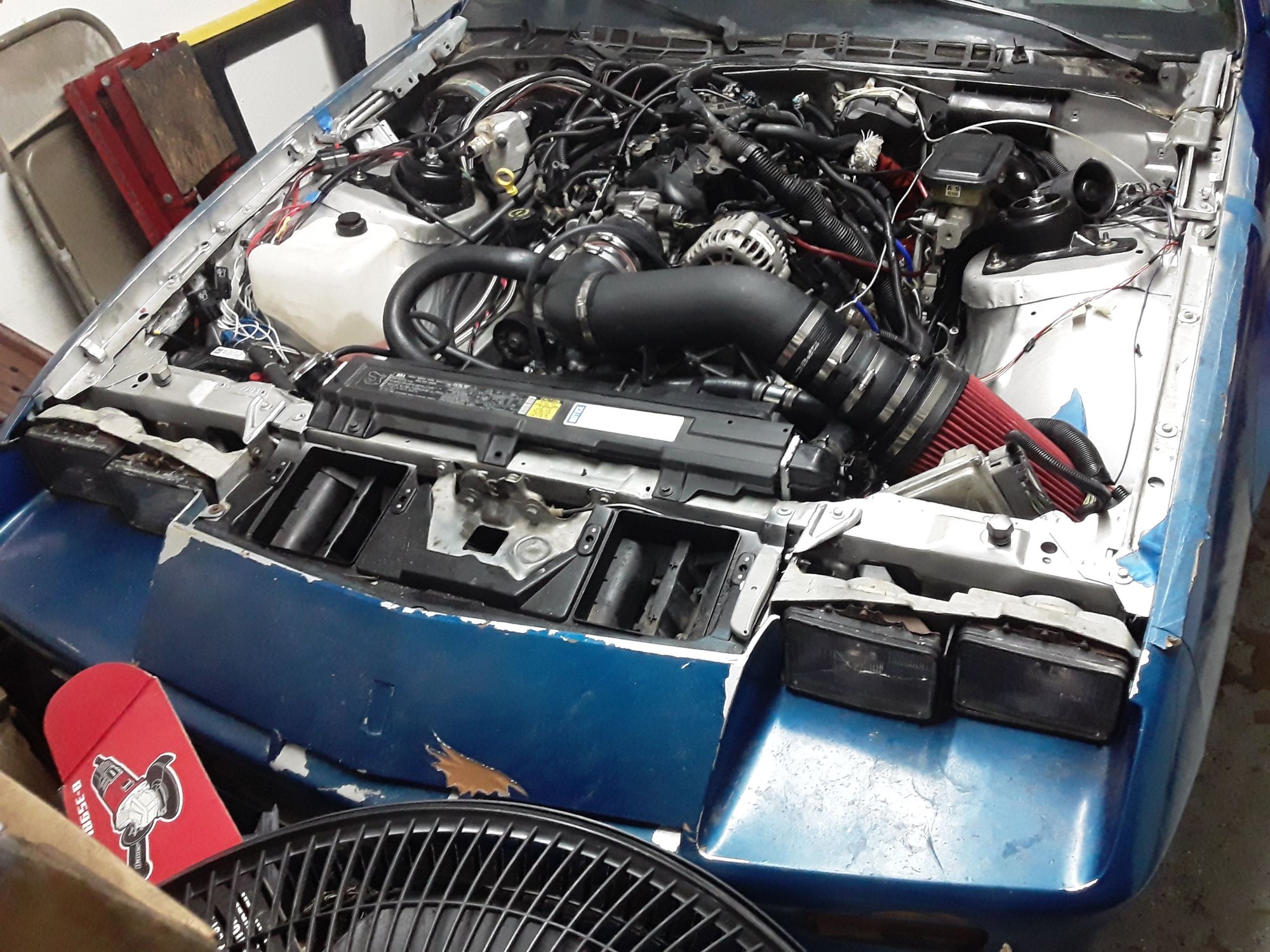

Well, I got to finish up and drive it. Everything works as it should including the transmission, rides well...but I'm leaking a nice amount of coolant somewhere on the middle of the engine. Its leaking down on oil pan..No visible leaks on top of engine at all...

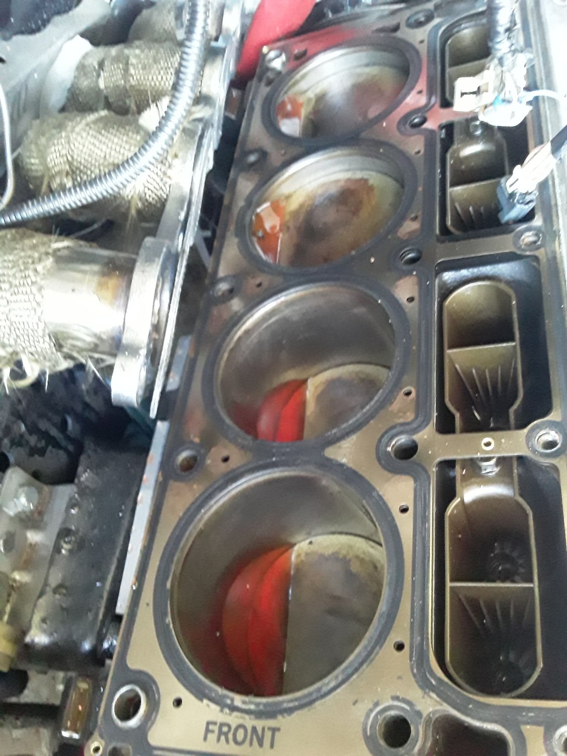

Originally Posted by cmiller2014
Check the 4 steam vent ports (2 on the top of each head) and see if they are leaking.

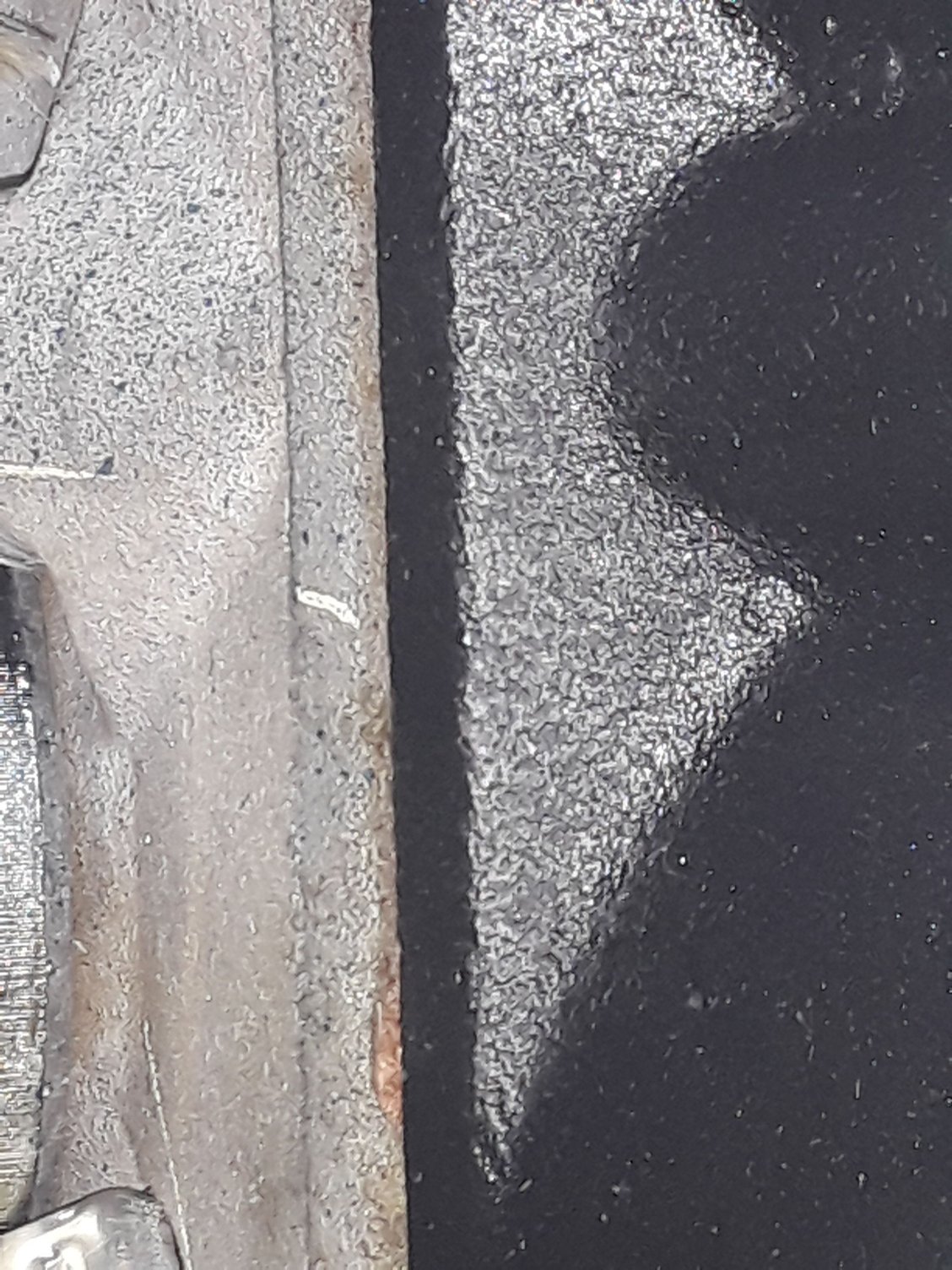

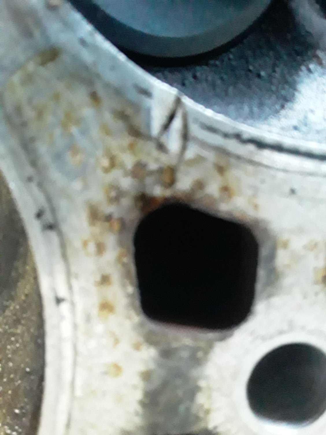

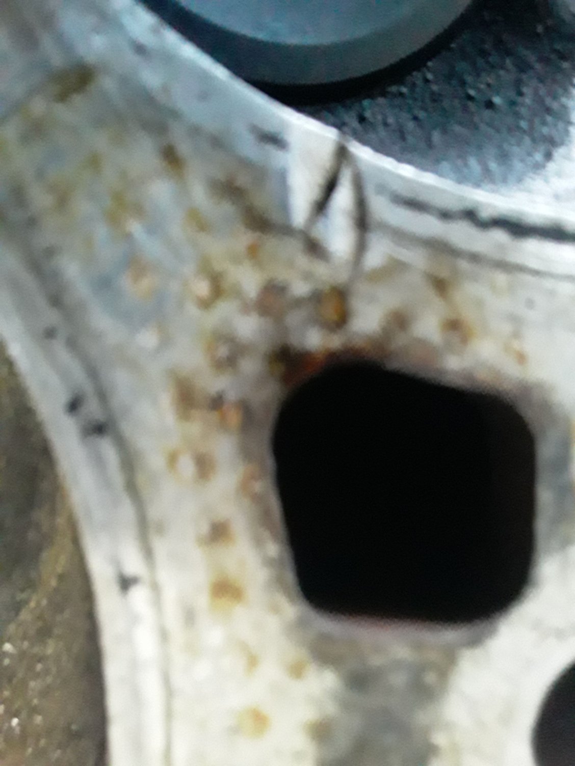

Looks like the heads are leaking going to the back... no water in the oil...
Some background on the heads....
Got them from a friend (862) .
We checked them with a straight edge and seemed fine
Rebuilt them with lightly used ls6 springs... new gaskets installed, and torqued down to sequence and spec...
Cant believe this... It seems like a tight space with engine in car to change the heads..

Kool. I don't know if I installed the head gaskets wrong or the heads are bad... I have some 243 heads that tested good from a machine shop I can use if needed

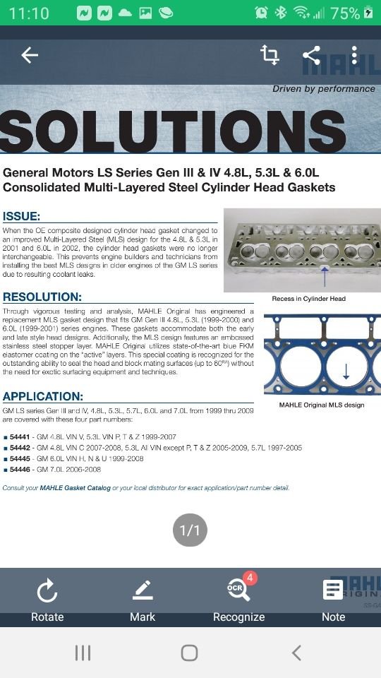

I know that some of the early LS heads were known as "notch heads, because they had a notch cast into the deck by cylinders 3 and 6.
If you use the wrong gaskets with those (or maybe it's if you use notch gaskets with un-notched heads... I forget.), you will end up with a small coolant leak that will never go away.
Let's hope it's something else.

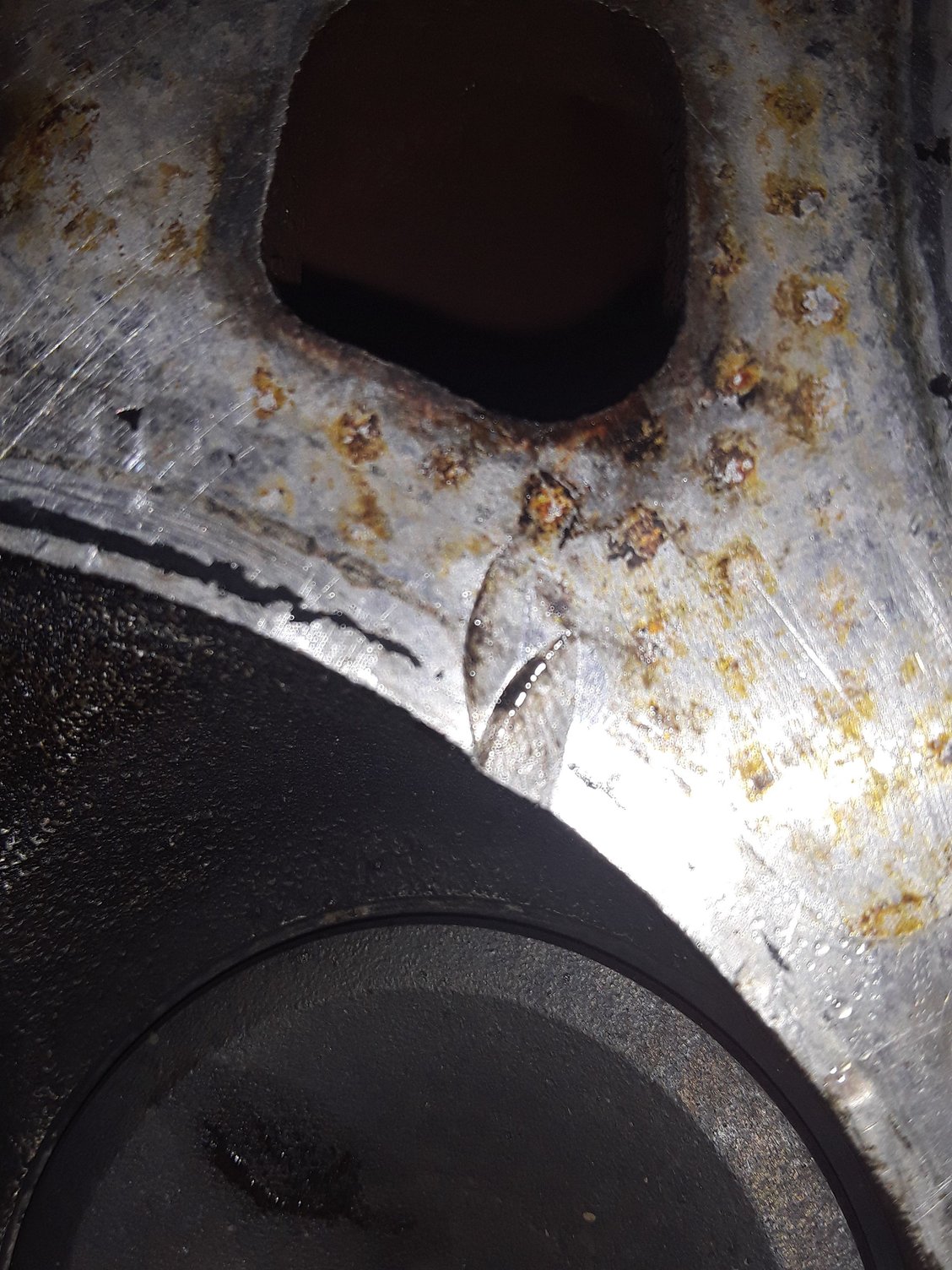

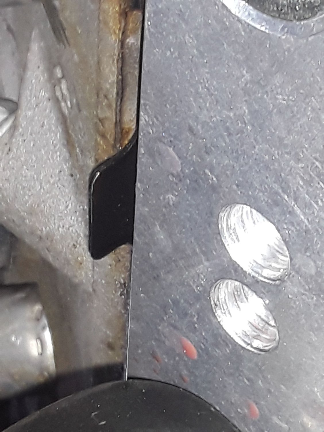

EDIT: Upon reviewing the pictures again, it kinda looks like you have the notched heads; which cylinders did you take these pictures on?
If you have notch heads, you either have to use graphite head gaskets, or get special MLS gaskets that have a notch.
I'm using graphite gaskets with my 862s; I didn't even know about the problem at the time, I just ordered a gasket set for a 2002 Camaro so I could get the O-ring intake gaskets.

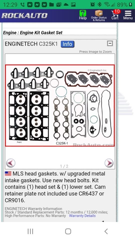

Which head gaskets did you use?

They were MLS from rock auto... naw.. they were leaking pretty bad on both sides...

What year of engine did the 862s come from?
My quick research says that '01 and prior were notch heads.

Yea these are like 99-02 maybe

this is the kit I bought from Rock auto for a 2003 chevy silverado 4.8

Re: 1986 Camaro LS Swap build
Ehhh, I wouldn't bet on that with a 4.8.
243s have larger chambers, so he's going to see a loss in compression. The 243s have larger intake valves, but that's going to reduce his intake port velocity at lower RPMs with an engine that small.
There are lots of guys on LS1tech ditching the 243/799 heads for 706/862s for street builds because of the boost in compression and torque.
If he had a 5.3, it might be worth it, but I think it will be a loss on a 4.8.
I just re-read your post and also seen your edit, so I see your response about the 243s.
It was leaking on the back cylinders between #6-8, and 5-7.
Yeah its leaking when the car is not running, so obviously there's a problem somewhere...
I've never heard of the notch heads, it's all new to me.. I thought besides the material, they were all the same for 4.8, 5.3 gen 3...
You remember where you got your gasket from with the part number?

Ok kool. Yep, I posted a pic of the heads on ls1 tech and I think I do have the notch heads. I can see it on the passenger side but cant see it on driver side.. but I found a pic I posted that shows a notch... and I definitely bought a gasket kit for a 2003 assuming the heads were all built the same...
Well, now the mystery is solved; glad that didn't take too long. Just get some graphite gaskets and slap the 862s back on.
I know that a lot of people don't like graphite head gaskets, but that's what I started off using in the '90s, and they have always worked for me.
You could still reuse your headbolts, too; they haven't been on for very long.
Instead of the angle method, just torque them in a three steps: 25-45-65 ft. lbs..

What you think about these
Those are MLS gaskets; they might leak. Let me do some research on those, because I'm curious about this.
About TTY bolts: you can find some good information about this on LS1tech. Draw your own conclusions.
I've reused them plenty of times, and never had a failure. You just don't use the angle method.
I found some information on them.
Also
Looks good. Try them out.

Got both sides off.. do you guys think that coolant spilled in the cylinder when I took the heads off?? I drained as much as I could before I took heads off..
Old Jun 11, 2020 | 07:40 PM

Yeah, it got in the cylinders when you pulled the heads. Most engines (especially V-type engines) will do that even after you drain the radiator.
EDIT: Get all of that stuff out of the cylinders before they rust.

This. Dont wait and if you can get a film of oil on the exposed cylinder walls. I would turn the engine over a few times too. I've seen rings rust below the surface from coolant that sat too long.

I got it off, put some oil on a rag and wiped each cylinder around, then spray wd40 lubricant in each cylinder. Hows that? I'll rotate it tomorrow

I also check the deck of the heads.. found a few blemishes

Can you catch your fingernail on those blemishes? If so you can try to gently sand them down. If not, you'll have to have the head decked.
Turn the engine over with a breaker bar on the crank bolt. You should see more coolant spill out.
Will do. Shouldn't be too hard with the heads off.
Yea I can catch fingernail.. I think I will just use the243s get them mill and decked since I know those are not cracked 4sho

Is that damage all on the same cylinder?
How did those "blemishes" happen?
That looks like some stuff that would compromise cylinder sealing in the long run.
I still think you should stick with the 862 heads, just get them decked.
I decked mine .020" with no interference issues.
I dunno how it happened.. I think it was already there.. I'll drop the 862s off at the machine shop today
Dropped them off at machine shop.. showed it to them.. it's only by one cylinder, he said it's bad but he can fix it... both heads probably be milled between .020 - .030 which would still be safe he says.. should be done about Tuesday..

Update:
Installed the new gaskets, added coolant , changed oil,oil filter , finally got the heads back from machine shop that were resurfaced... took of .005.. used same pushrods.. and no leaks... at least so far.. I'm plugged the hole in the head and ran a radiator adapter for my coolant gauge...
My shiftworks trans shift cable worked great a few times, then it wouldn't shift the gears.. did everything I could.. i.e. adjusted bulkheads... it seems the outer rod dislocated from the inner cable..so I emailed tech support for a resolution
I got to drive it around the corner, my 160 stat is working fine, stays cool, ecu operated fans working correctly... all is good. Just waiting on the shift cable problem then I will clean up the engine bay wiring, and it's going to the exhaust shop..
My alternator is not charging battery... battery reads 11- 12.5 volts
Also, Any ideas on mufflers?
