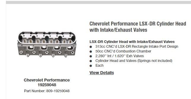

The LSX454R was discontinued although the specs are here:
https://www.gmpartsdirect.com/oem-pa...ngine-19260835
The R version used a CNC'd port and chamber although I can't say if it was a Lingenfelter program.
Old Dec 27, 2019 | 04:43 PM
QwkTrip's Avatar
COTM Editor
iTrader: (22)
Posts: 10,438
Likes: 2,093
Car: '89 Firebird
Engine: 7.0L
Re: 4.8/5.3 Boring
Wow, that LSX-DR is so much different! It has a tiny 50cc combustion chamber with a massive 313 cc intake port volume. Definitely nothing in common with the factory LS7 head.
