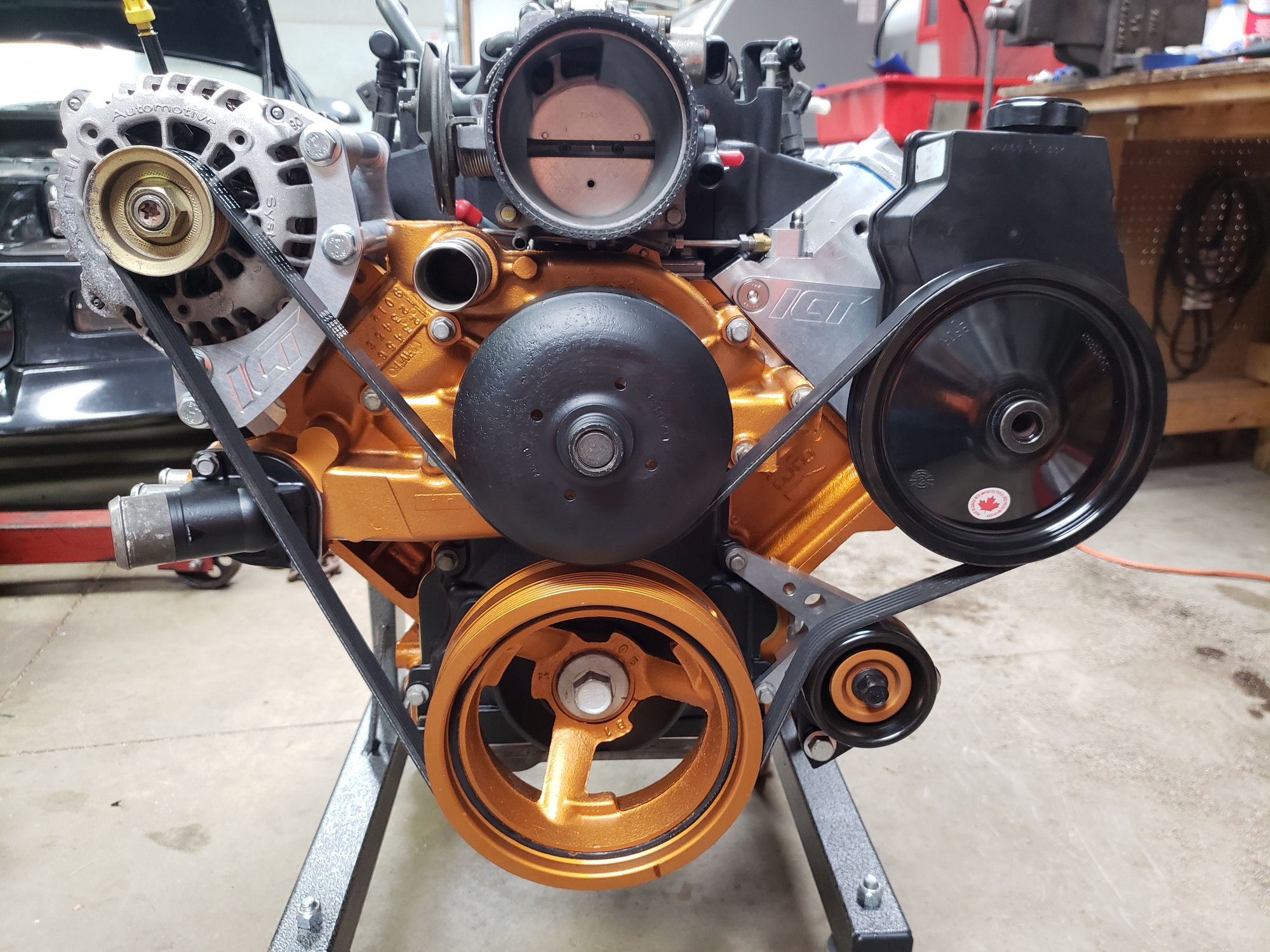

No ac here, but this is the ICT Billet truck alternator relocation kit. It was about $100 - $150 they probably have something for ac also. This uses the truck balancer and would require the above mentioned spacers, they are included with the kit. To avoid the spacers I swapped a truck pulley onto a car water pump. The car and older truck water pump housings are the same, it is the outlet that is different. The truck outlet comes out of the top and the car outlet come out of the front.

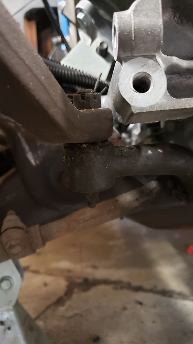

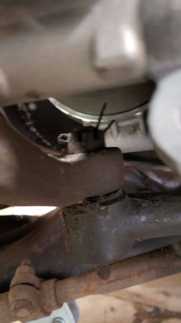

I was able to use the truck a/c pump and bracket in the original truck a/c location using the Hooker Blackheart mounts. The steering arm clears both the pump and the bracket by about 1/8" at full lock but I am using ICT 4th gen solid motor mounts. I may be doing a little clearancing just for my own piece of mind but those not using solid mounts would definitely wanna do some trimming to both the lower front pump bolt boss and the truck bracket.
