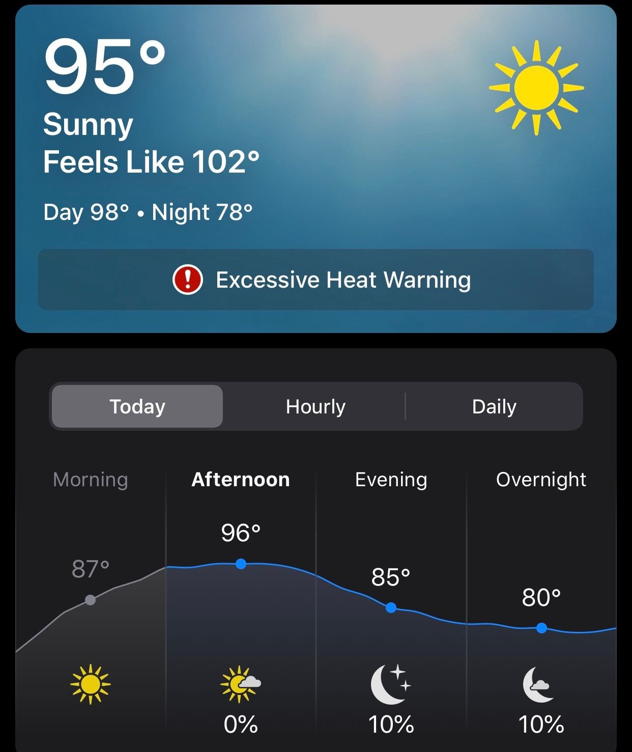

Been busy re-doing my fuel system so sorry for the lack of updates. The news is pretty good though. I drove the car down to the tuner a few weeks ago. Its an hour drive each way, most of it is highway. We hit some traffic along the way and we had the a/c blasting the entire trip. I took this screenshot the day of the tune. I’m happy to report that the coolant temp never passed 206 the entire day! Thats driving in the city, on the highway, and even in the crawling traffic we hit. Never turned the a/c off and never got hot. At highway speed it sat around 198, went to 206 in the stop and go traffic.
Now I was very pleased with this, but the following day was a little different. I took the car to a sonic drive in and sat there eating for about 25 minutes. Had the car idling with the a/c on the whole time. This day was a little warmer than the screenshot above, and the coolant temp SLOWLY made it to 217. I mean it was the slowest it ever climbed.. After leaving, the temp came back down to the normal 198-208 area. Now these were pretty extreme circumstances, and I was sitting there with the a/c on for way longer than I normally would. Regardless with the results from the day of tuning, I’m calling this pretty much fixed. I’m planning on sourcing the rest of the airdam I’m missing, so that may help a little more. I also ordered some more 5 inch piping to move my air filter out of the engine bay so that will help my iat’s a bit as well. I’m sure I can get it idling under 200 if I add some hood vents and wrap the headers, but honestly this is a massive improvement and I’m perfectly fine with it. Its literally running 30 degrees cooler.
