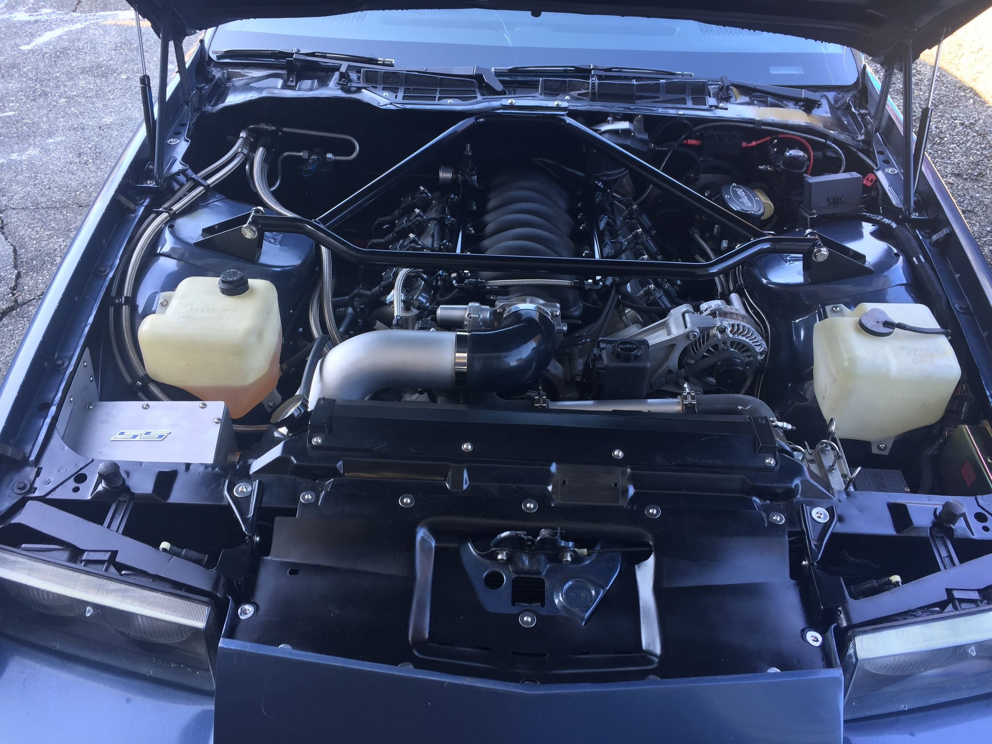

I prefer this as well. I did install a cutoff switch and although my current one is ugly, there are a few coated billet ones out there that will blend in better. With the camaro taillights you can cut into the inner shroud piece. I can always do away with the switch and get a new shroud cover. My biggest reason for adding the cut off swtich was for safely disconnecting all power when adding custom circuits and such to the car. It saved me from a fire early on in my wiring adventures.
exactly exactly. I love having the ability to park the car and flip the switch and have all the electronics be dead. if I am doing work on the car, or welding, or just want the power off, its a flip of the switch. My battery is in the back also, for the performance purposes, weight distribution, and mostly because it allowed me to really clean up the engine bay. it was a hassle (and a bit of added weight) to run all the heavy 1-gauge power/ground cables back there, but everything has worked just fine and I am glad I have it this way. I have a distribution block and a jump-post up where the battery used to be.
edit:
better photo showing what the area looks like with no battery.

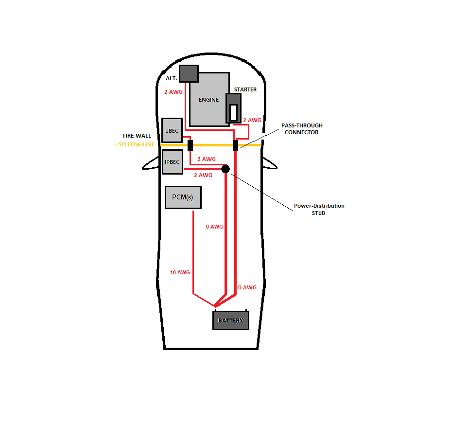

With the Battery relocated to the Rear of the Vehicle; Power-Distribution should look similar to the 2 Images below:

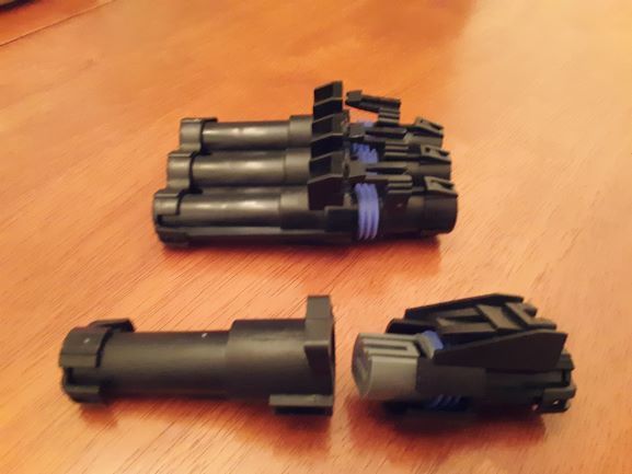

The Images below will show one of my favorite Rear-Mounted Battery Power-Distribution Connections...
This works well for a 0/ 2/ 4AWG Cable being split into Three-Branches (8AWG or so) that can be Locked with CPAs or completely disconnected quickly:

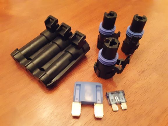

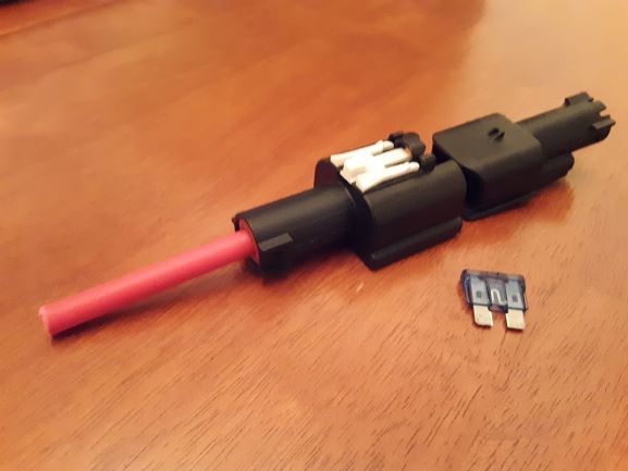

Further down the line, individual Connections can be made:
Each of the 3 Branches have a maximum continuous Ampacity of 60A, which supports Power-Distribution Systems up to a combined 180A.
If Higher Amperage Branches are required, the next size up is for 125A:

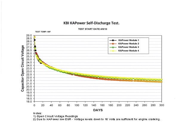

Does that thing have a super capacitor in it? That might explain the higher voltage during storage, and the Mighty Mouse punch for short crank

Well actually capacitors are quite leaky and it would drain the battery quickly if there was a cap inside, you can't just leave a cap charging its constantly losing energy
Also if you charge a cap at 12.65v the maximum a cap can charge to is 12.649999v it can never charge to supply rail fully due to the leaking
If you want to take say 3v or 12v and turn it into 15v or 200,000v that takes some doing. Either an oscillator with transformer type of deal or some creativity involving diodes and transistors. I used to play around with stun gun circuits here are some voltage increasing circuits
No, often times the super cap will have an isolation switch that preserves the charge after engine shut down so it's at 14V or whatever the alternator was charging. Not all are that way but the better units are. Super caps used with starting systems actually have extremely good leak down rates and hold high charge for many months. But yes, units without the isolator will be at battery voltage.

Oh , maybe
http://pwkqn.ldcje.servertrust.com/K...Paper_s/30.htm
I never tried it or used it before, we don't get the cool stuff at school
Symmetrical EC’s, supercapacitors, or ultracapacitors, are powerful devices but have shortcomings when used for engine starting or high pulse-power applications. The shortcomings of a symmetrical design include a high self-discharge rate, the need for voltage balancing between the cells, the type(s) of electrolyte, and the methodology used to enclose each of the cells.
I guess days is possible from the nickle version?
Thats amazing if its truly a cap. I see 13.25v after a couple months I think. idk whats inside but they are good
It says supercapacitors will "Modules will leak down to 0 volts quickly. Must be “re-charged” prior to use, causing un-due stress on the batteries in the circuit."
But the KApower nickle carbon "Will not “drain” batteries if left in a parallel connection" so its not a supercapacitor exactly?
The reason caps scare me is their rapid discharge rate can be deadly. In a vehicle where we come into contact with the battery and charging circuits I don't think such a design is wise. I just don't know the safety issue there.
And being a cap I don't see how it could charge above supply rail voltage anyways.
I think the cells inside are just higher voltage than typical lead acid is all. I think the starting power is just from higher resting voltage.
