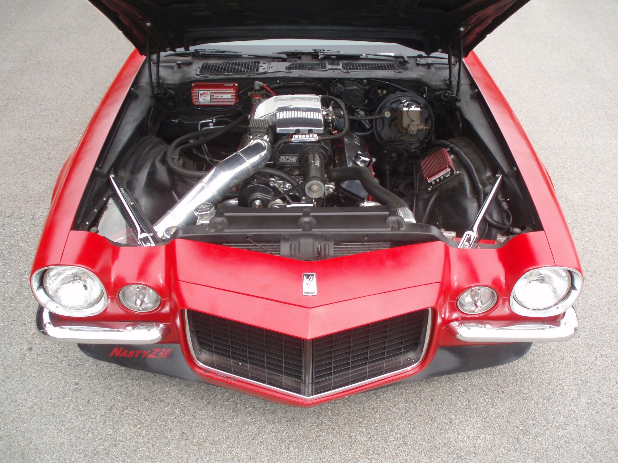

here's a picture of one i made using their pieces on my old '72 camaro

Originally Posted by battmann
Shifty is right - these are pretty easy to fabricate on your own.
Spectre's website shows all the different pieces that are available - there's a ton:
https://www.spectreperformance.com/c...Kh58Xx6jTrxSZ1
Thanks I think that I will be going with this company

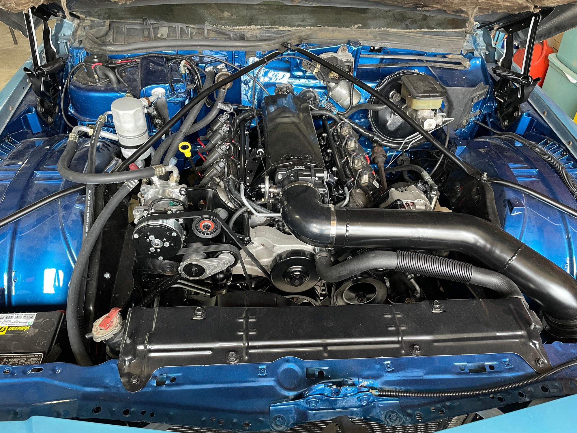

I keep a few cheapo silverado intakes in stock like this. Use it like a parts kit, not a direct fit part. Throw the filters away as they're huge and terrible. Buy generic K&N 4" for $30
Cut the mounting tabs off and polish the areas after. Mix/match couplers. Buy better worm clamps from lowes (dryer vents), they're much tougher than the chinesium ones
Can make some really nice intakes from those kits for not much money
Amazon Amazon
These are all based on those cheapo kits
