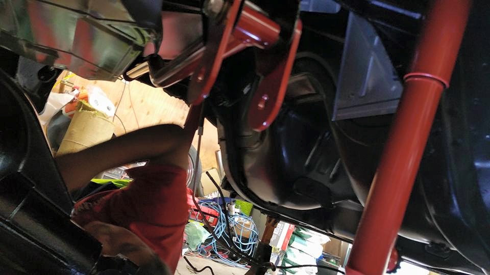

Got some pics with the wheels on and finally on the road. Found out that the S60 I bought wasn't broken in right and now I'll have to put a new carrier in in spring. Guess that's the chance you take buying used. Hoping in spring to do a new sound system, fix the S60, aluminum radiator, 4th gen leather power seats( If I can find some perfect), new dash pad or cover and really looking at doing the Megasquirt and meth injection.
Any recommendations on the megasquirt would be greatly appreciated.
Attached Thumbnails Decided to start a build thread!-camaro-trans5.jpg   Decided to start a build thread!-my-rs6.jpg   Decided to start a build thread!-my-rs5.jpg

I just ordered the Founders Panhard bar relocation kit this weekend. Glad you posted a picture of it on your car it looks great.

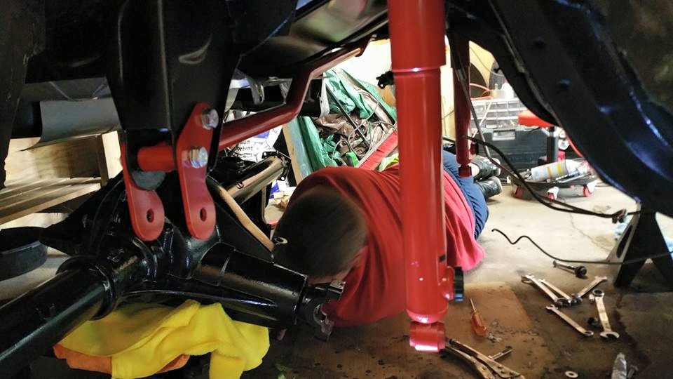

It's been a while since I've been here. Just put some Founders performance extreme rear control arms in and decided to wipe down the underside for the first time this year. Lol. Found my steering shaft to be very sloppy.
Have any of you used the Detroit Speed shaft? Trying to decide which way to go with it.

I've used the Astro Van steering shaft and have been happy with it.
If you set the car on level pavement and put an angle finder on the panhard bar is it level (or pretty close to) or is the body side lower? The picture makes it look like the body side is lower because of that bracket that lowers the mounting position to gain exhaust clearance. If it is, you might want to look into one of UMI's axle side panhard bar lowering mount.
