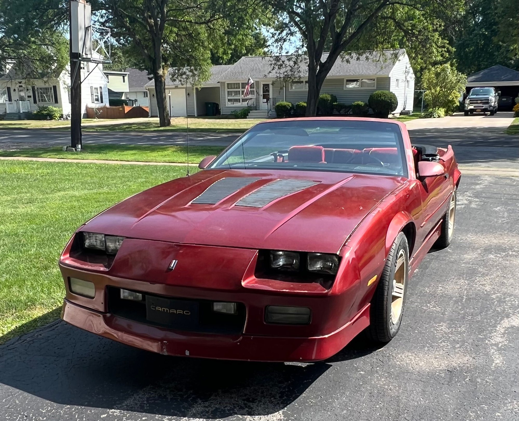

Hello all,
At one point in time, I went by G92_Z28 on the forum. I had a 1988 Iroc-Z which I still have (hopefully will also start a thread for this car, doing a lot more work in a more restomod style) and a 1991 Z28. I unfortunately sold the 91' a couple years ago now and have still been working on the 88' but I've had the itch for another.

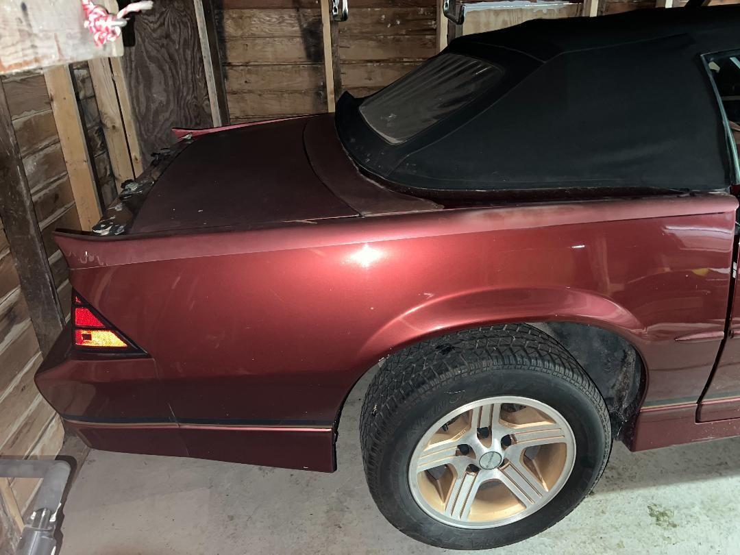

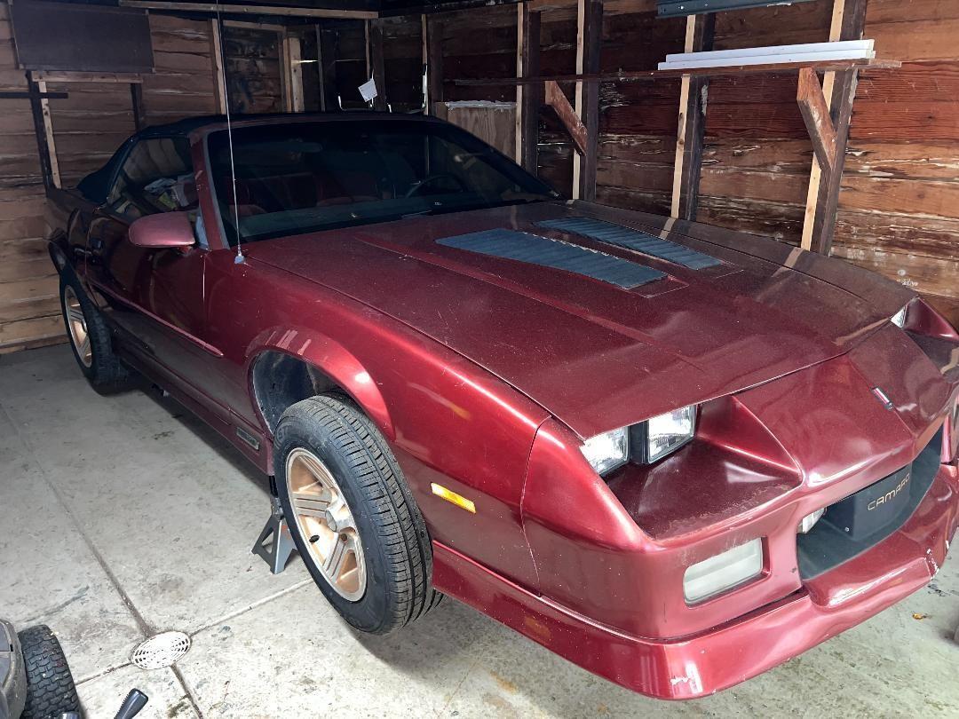

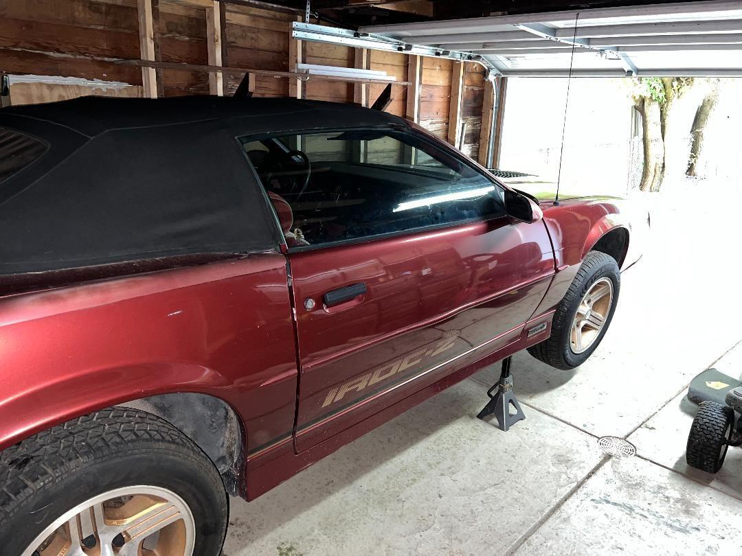

Recently while going on my daily stroll through Facebook Marketplace, I came across an 89' Iroc-Z convertible with a 5 speed. According to the description the input shaft was destroyed, and all the gears acted as neutral. The car also unfortunately had been in an accident with a deer in the early 90's, which I verified with carfax, and it currently has had a rebuilt title in Ohio since 2005. Although knowing these issues going into it, something about the car drew me in and I knew I had to save it. After a Saturday road trip to Ohio from New York, I was towing the car back home.
A few things became clear immediately, whatever had happened to the car during the salvage claim must not have been too bad and/or repaired extremely well. All of the body panels still have the original vin stickers for the most part and the doors actually close the best of all 3 third gens I've owned up to this point. I was initially told the car was indeed an original 5 speed car. I was not too concerned if the car was originally a 5 speed or auto as I wanted a manual anyways, I also began to have questions when I looked under the car to find cutoff transmission cooling lines. So long story short the car was originally an auto, and someone swapped in the 5 speed at some point.
NY requires any rebuilt car brought into the state must undergo a salvage inspection in this state (thank you NY!) which essentially is a check to verify there are no stolen parts on the car in order for them to issue you a new title. Therefore, to pass the inspection I am currently doing a rebuild on the T5. Once the inspection is passed, I have several other plans involving paint, interior, suspension, etc. I know I may get hate for the fact the car is a rebuilt title and the fact that I'm rebuilding the T5 for the time being, however, I'm building the car I want and that's what's important to me. Just hoping to share some of my knowledge and document my build here for others to see.
Below are some pictures in the garage once it was unloaded from the trailer:

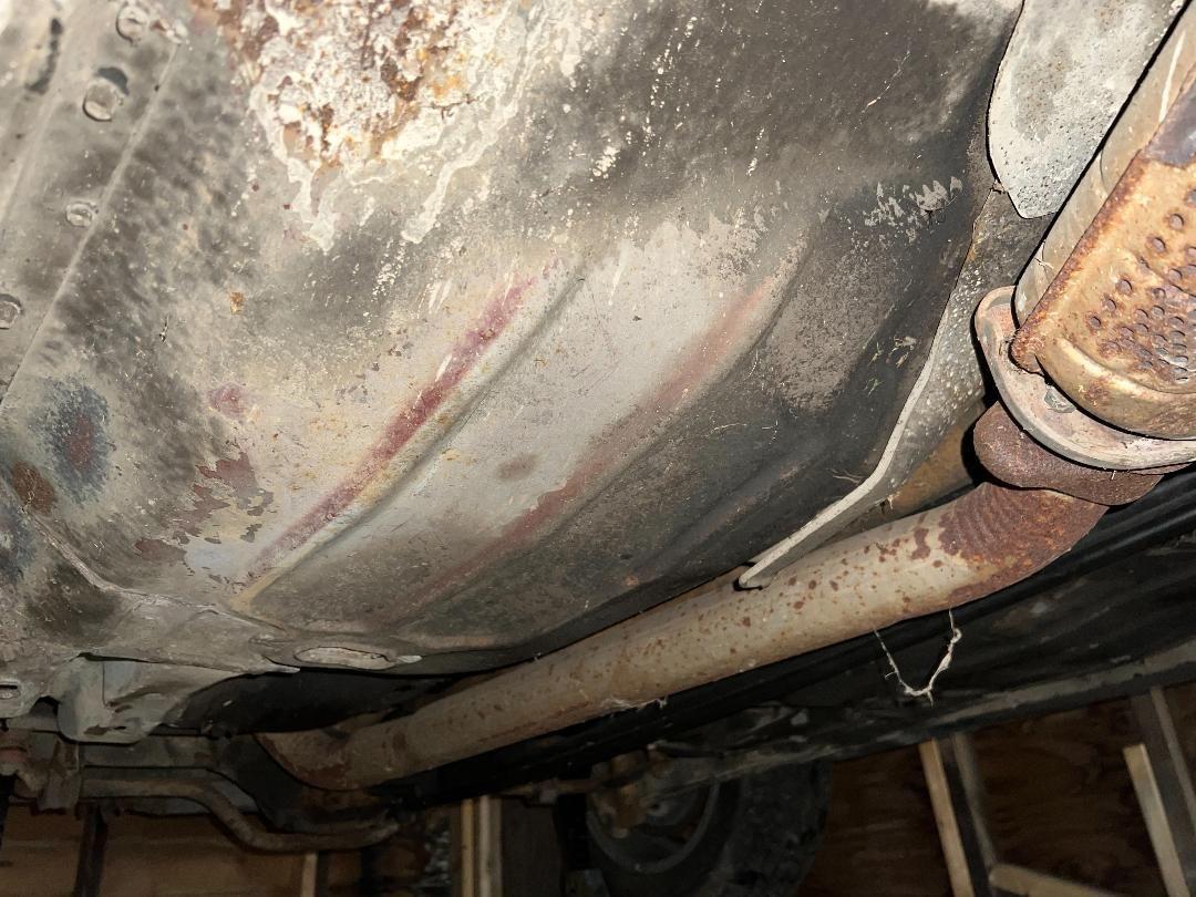

Good news is that the floors appear to be solid, just dirty, nothing I can't clean up:

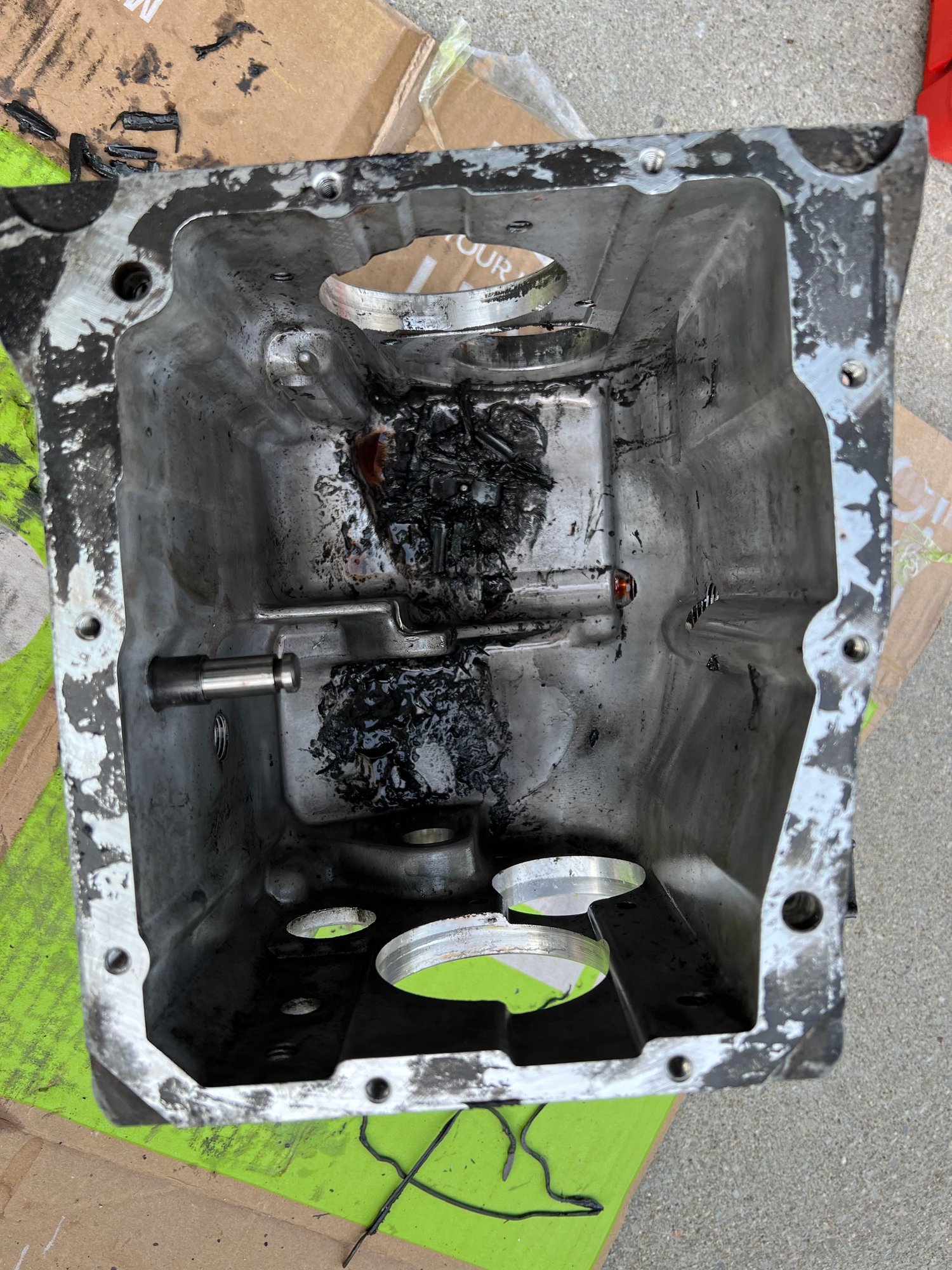

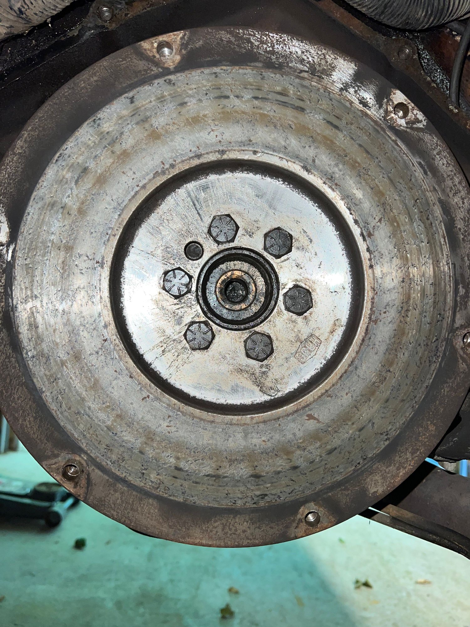

Over the last few days, I began with removing the transmission to diagnose the supposed broken input shaft and cause of every gear being neutral. Upon removing the transmission, I did a complete disassembly and discovered that the 4th gear on the input shaft had lost all of its teeth. Unfortunately, it appears that during explosion it also caused damage to the 4th gear on the main cluster which is expected due to the mesh. Below are some pictures of everything disassembled.

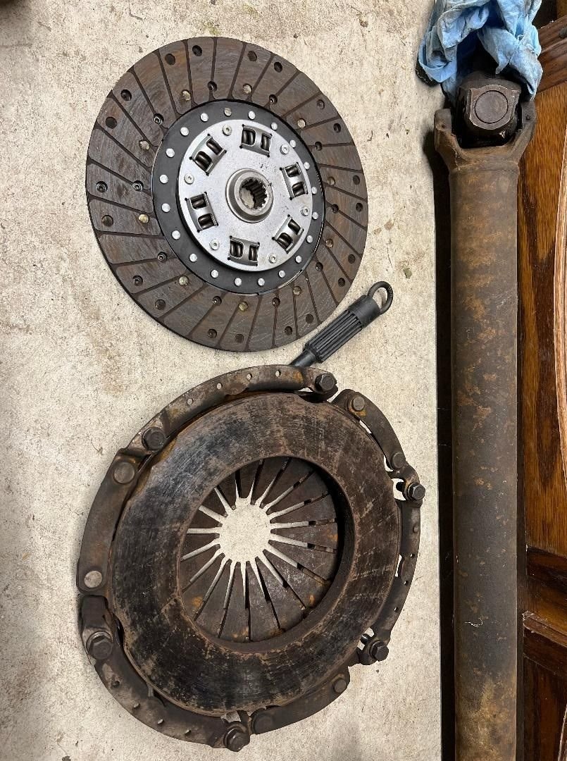

After removing the bellhousing, also found a rather spent clutch/pressure plate and flywheel as seen below.
Now before moving anymore forward, I will have to order up some parts to rebuild everything and hopefully get her moving under her own power. Other than ordering parts I will post an update once I get everything in and cleaned up!

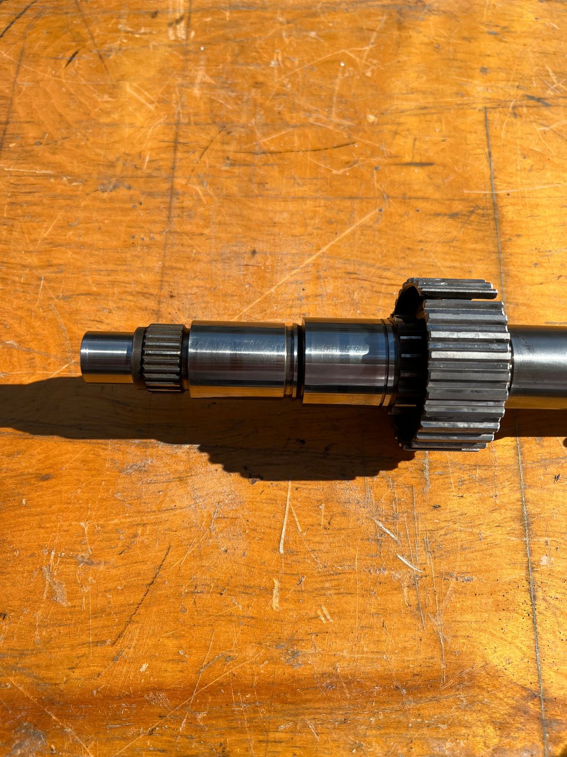

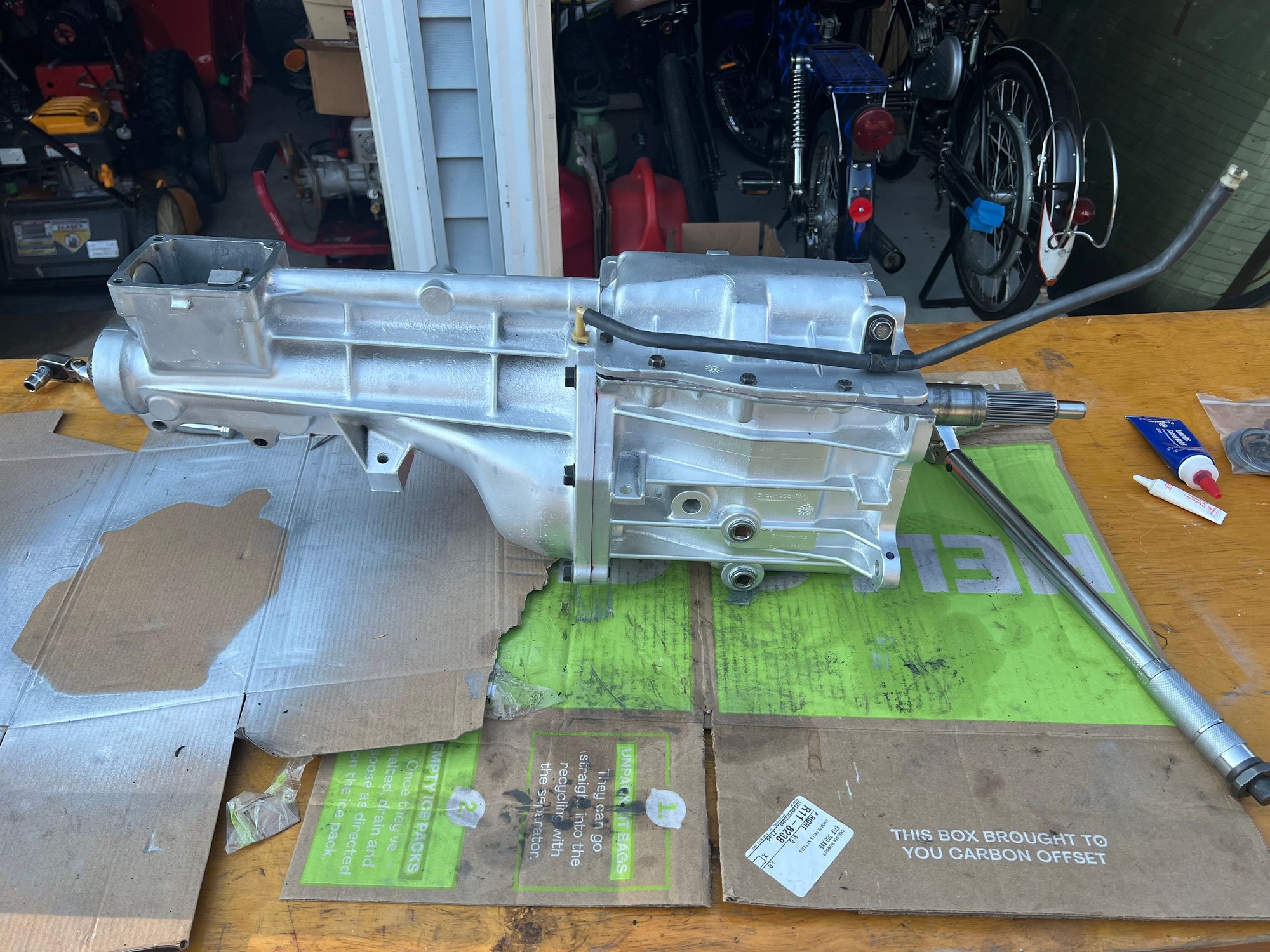

Finally getting time to post an update. The T5 is rebuilt. As expected, upon paying more attention the T5 they swapped in was from a V6 car so I put in some effort to make it a custom V8 trans. Gear set I went with was a Z code 2.95 heavy duty gear set rated for 330 ft/lbs and 350-400hp. Knowing the case is a week point and I only have a 305 in it for now that’s more than enough. However, I kept the .63 overdrive vs the .75 or .83 that would have come with a V8. This should help with some of the highway driving I’ll be doing as I’d like to put in 3.42 or 3.73 gears (still undecided) to help off the line. Essentially going for a stop light to stop light get up with the occasional highway trip to work or cruise.

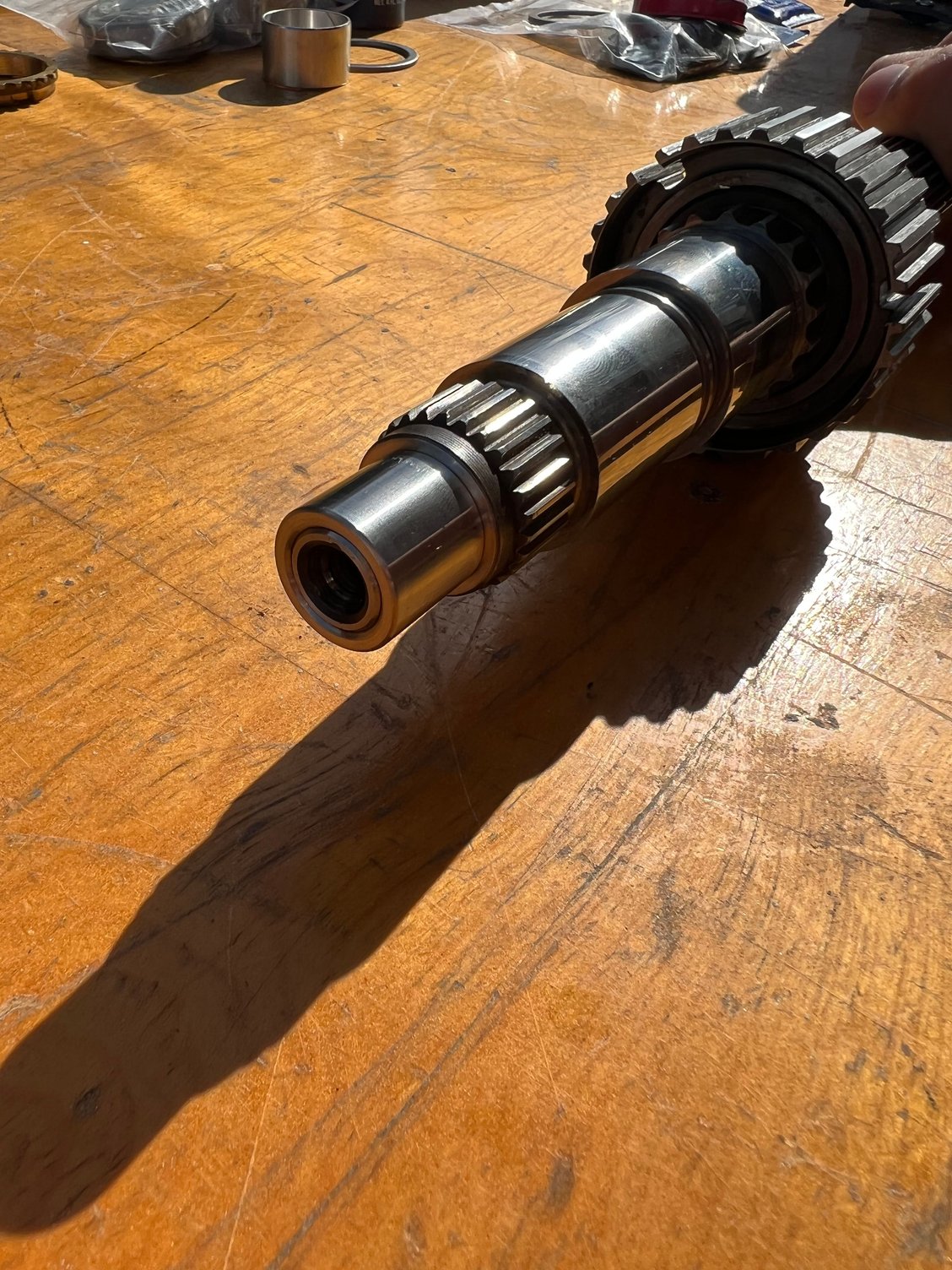

As is common in a high mileage T5 the tip of the main shaft was spalling. From some reading and talking to foxbody T5 guys, and since my father is a machinist, we turned the main shaft OD down to .600” and made a new race for the rollers from a hardens drill bushing with an OD of .831” and just under 3mm wall thickness. Also upgraded the cluster bearing race retainer to a heavy duty retaining plate. Pics of trans and repaired main shaft below, just realized I never took pics of the gears inside:

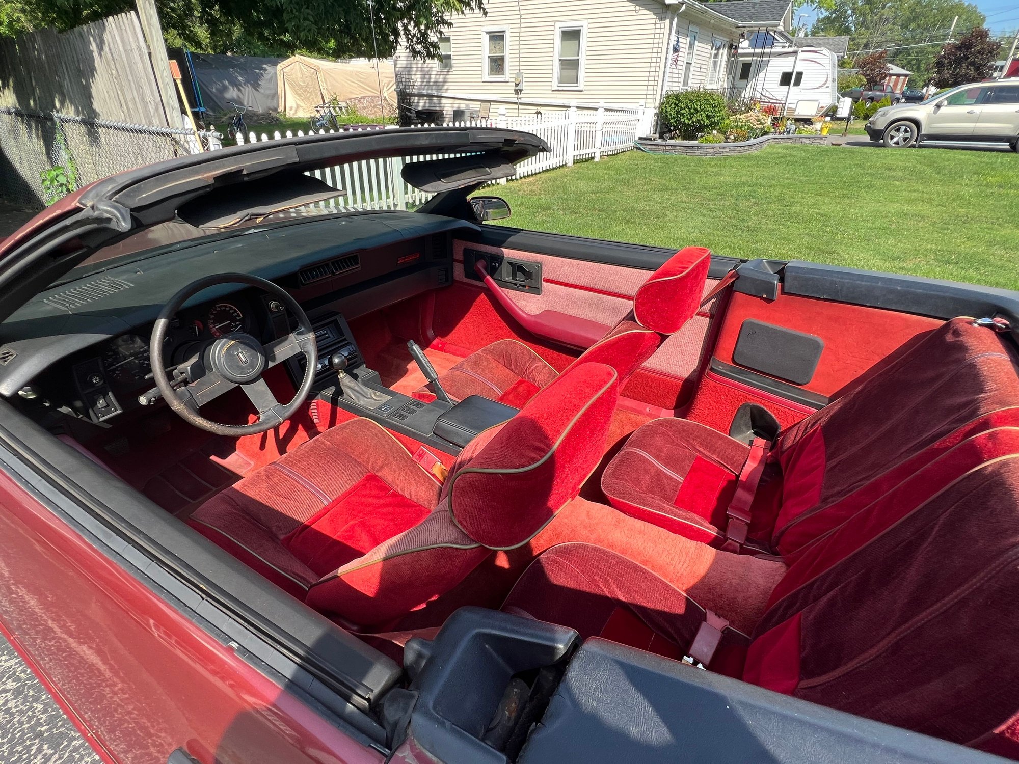

Well, made some more progress ...
Got everything reassembled and started diagnosing regular operational issues. Again, the goal is to get the car to a drivable and operational state and then work on appearance (paint, bodywork, interior, wheels) and suspension and performance after. Once testing the turn signals, I knew I had a faulty flasher. Replaced the flasher and the passenger side marker bulb, I had fully functioning lighting. This also included my fixing of the reverse light circuit which was left out by the previous owner during the T5 swap they performed. Then I picked up a new horn pigtail from AutoZone and had a functioning horn. I believe I am at a state in which I have a fully operational/drivable car now. Granted it may not look the best but, it will eventually. I currently have a set of Alston inner subframe connectors on the way from a member of the boards here and have a potential lead on a new spoiler center section.
Next big project will be a rearend/rear suspension rebuild. Decided to keep the 10 bolt and swap in a Torsen Posi unit and 3.42 gears from a 4th gen. I also have a set of 28 spline axles to go with it from a 91 Z28 and will be doing a rear disc conversion well I'm at it. I am going to go with Founders for their panhard bar, panhard relocation, and lower control arms. I also have a set of vogtland lowering springs from my old 91 Z28 that never got installed before I sold it.
Here's some updated full car pics for those following along...
