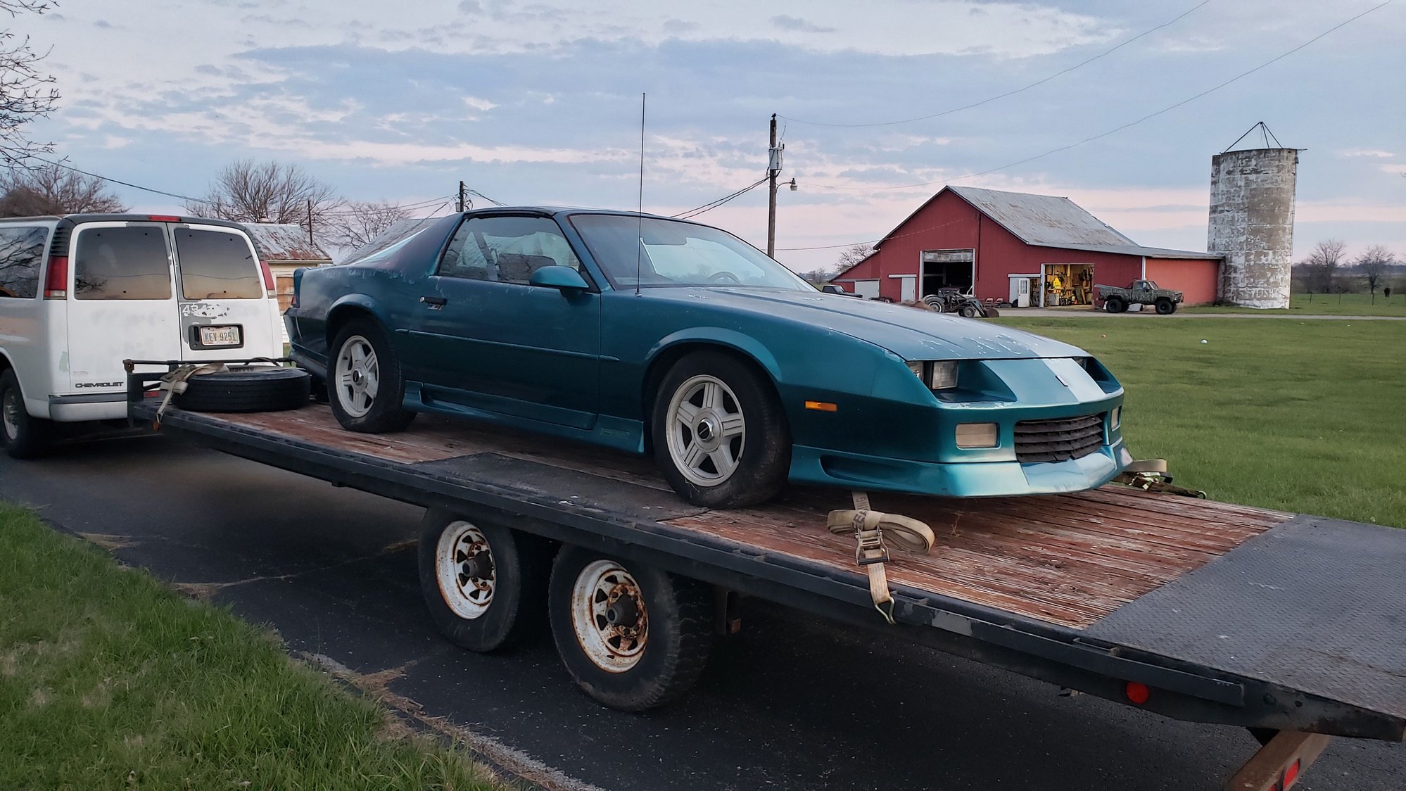

So then nearly two years ago now, my wife found a near twin to the car on marketplace. The only difference was the new car has the custom cloth interior and t-tops. It had been sold to a private junkyard in '00 because the engine was "bad". The car had been sitting there until around '21, when a local guy bought it. Then we bought it (still not running) in early '24.
Here it is when I brought it home:

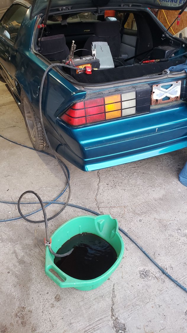

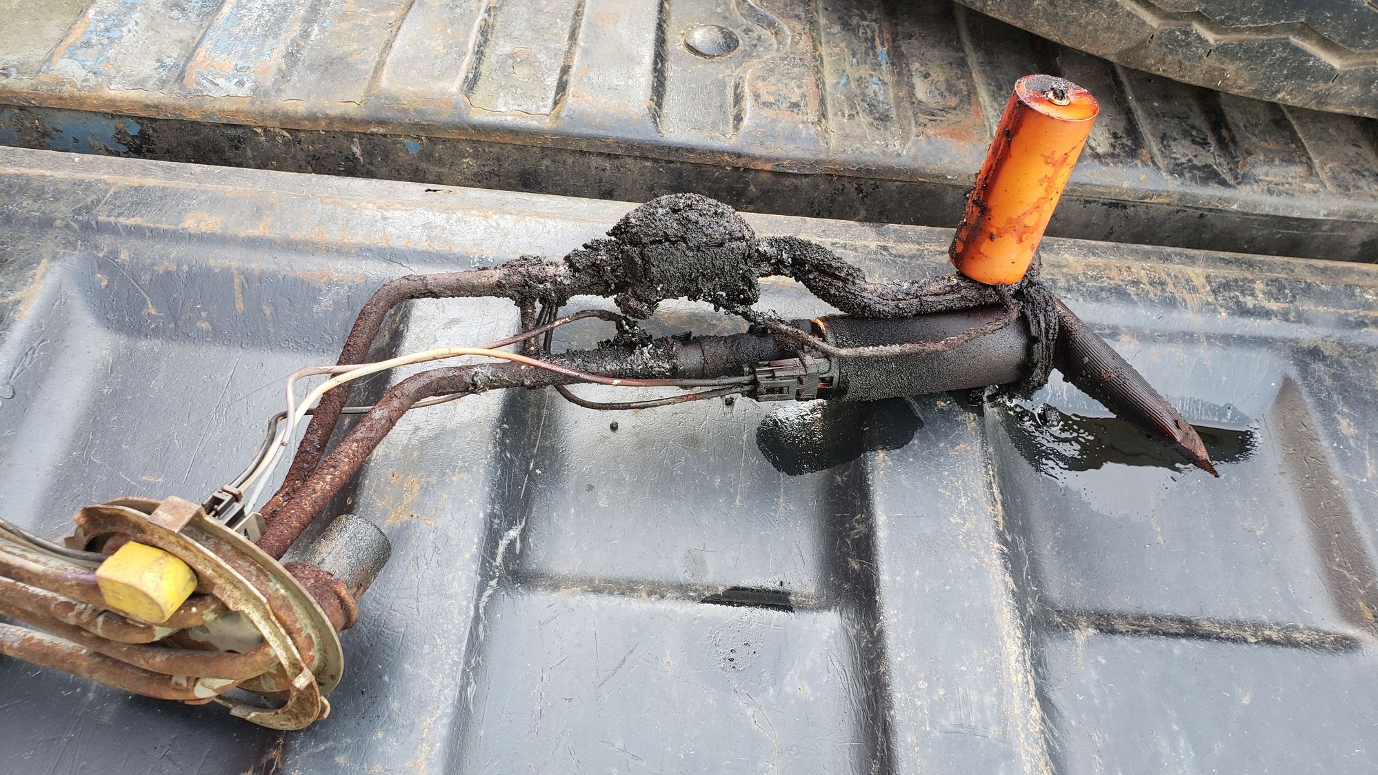

So then I went to replace the fuel pump. When looking to see if someone had hacked up the rear floor... yep, someone sure as heck has. And it's ugly. Upon taking it apart, I discovered the ugliest fuel system I've ever seen.

According to the date code on the fuel hose for the hacked up sender, someone tried to get the car running in '08. Knowing that the fuel system was full of trash, I blew out the fuel lines to and from the throttle body. I also replaced the fuel filter. The inside of the tank was full of piles of rust, which I vacuumed out (although the tank is still VERY ugly inside). I bought the cheapest fuel pump I could find in town and installed it on a used sender. It just needed to be a sacrificial pump so I could drive the car and see what else was wrong with it.

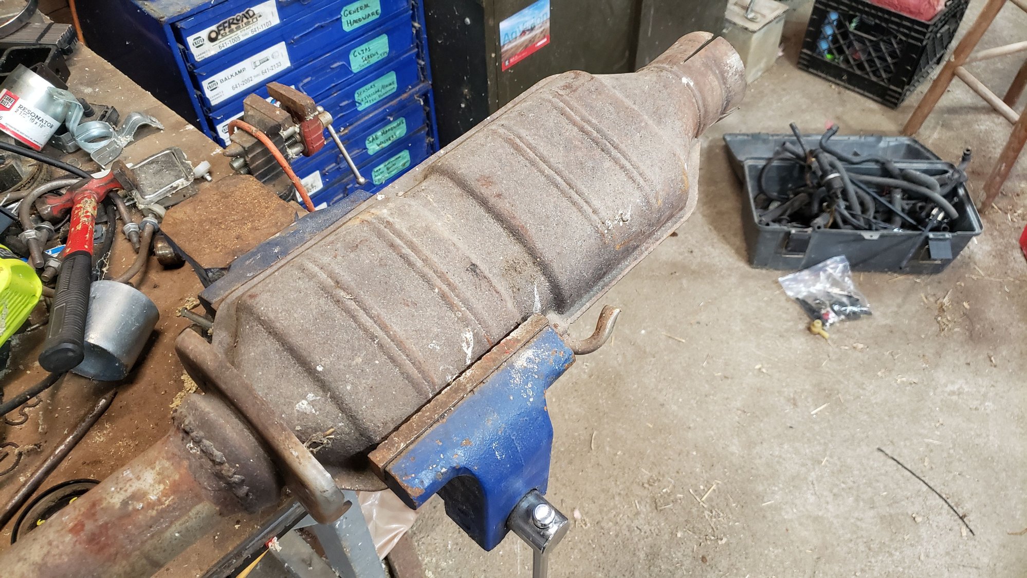

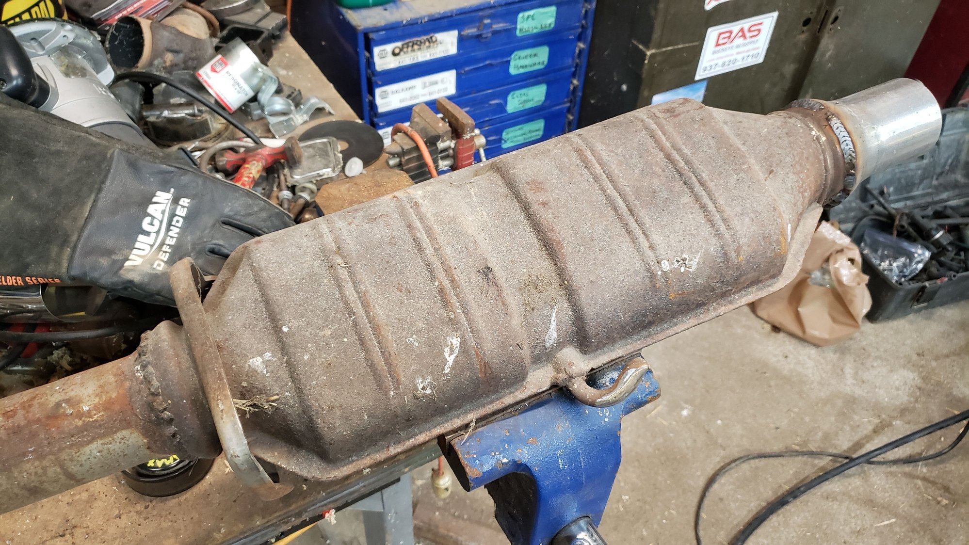

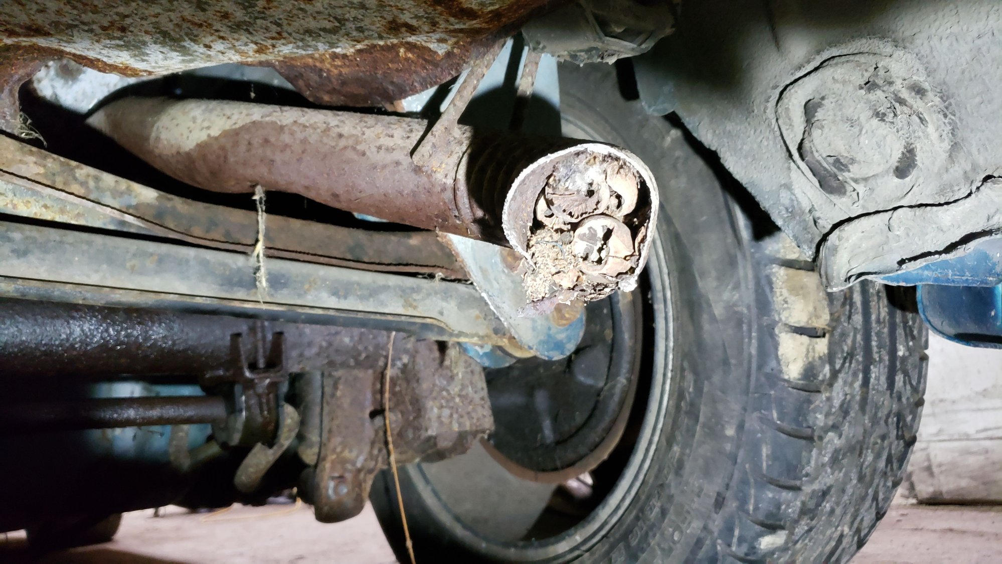

As it turned out, the exhaust was rusted and falling off. It was also full of mouse house. The converter, the intermediate pipe, the muffler... all of it. I cut it all off and installed an old flowmaster Force II catback. It was originally on an '86 LG4, then I rigged it to work on an '88 L98, then I used it here. I don't recall what all I did to make it work, but I'll post the pictures and we'll find out together.
Looks like I had welded the small inlet catback right to the large outlet L98 cat. And more recently I simply downsized the cat's inlet to work with the L03. Looks like my welding has also improved in the last 20 years, lol.

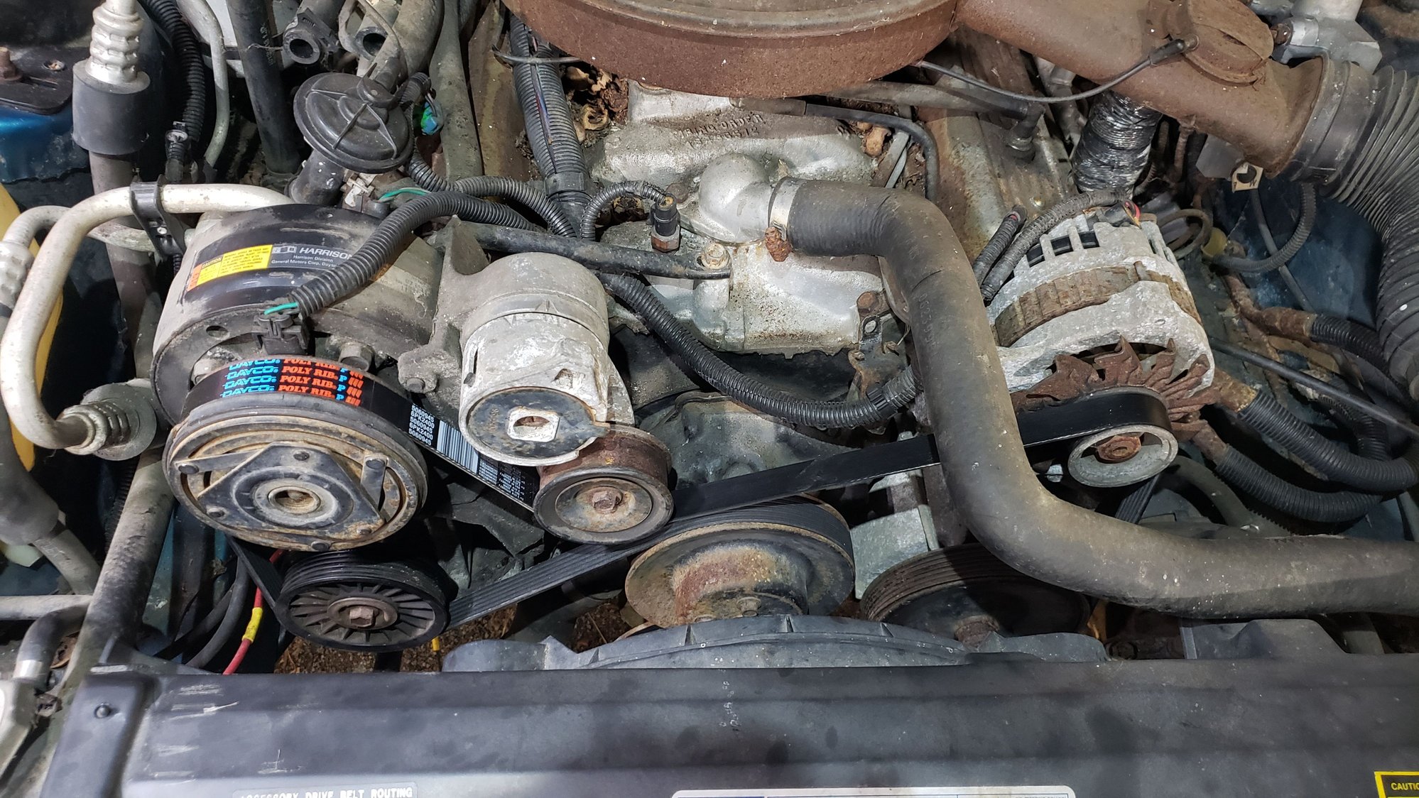

Oh, I forgot. The smog pump was locking up, so I had to replace it with a delete pulley. The lower bolt was seized in the pump. It shouldn't require that many tools to remove it, lol.

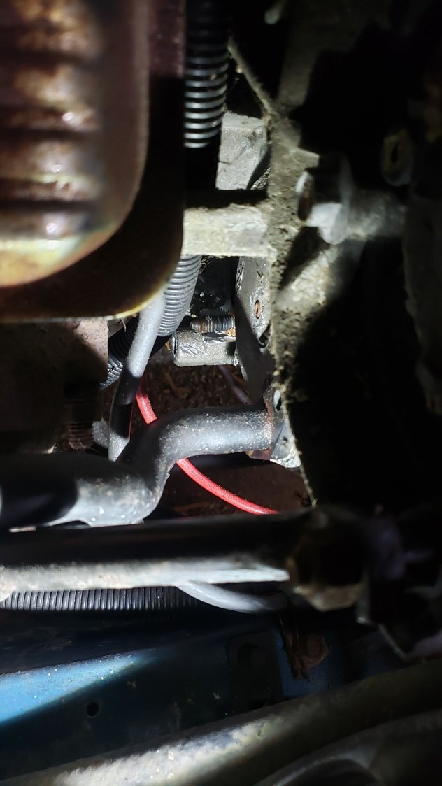

  • So then after a couple days of driving, things started getting ugly. Lots of inconsistent idle speeds, constant stalling, a noticeable miss, then popping through the intake. I pulled the plugs, but don't recall now what they looked like. But pulling the valve covers revealed two broken push rods and a couple sticking valves. When replacing the push rods and trying to free up the valves, I discovered that someone had overhauled the throttle body and replaced the intake gaskets too. Maybe someone in '08 discovered what I had just discovered? Who knows.
BTW, that one missing piece of push rod is still somewhere in the engine. It must be down in the pan now.
But anyway, the car ran ok again, but it still had a miss that wouldn't go away. The weather got cold and I parked it in the barn.

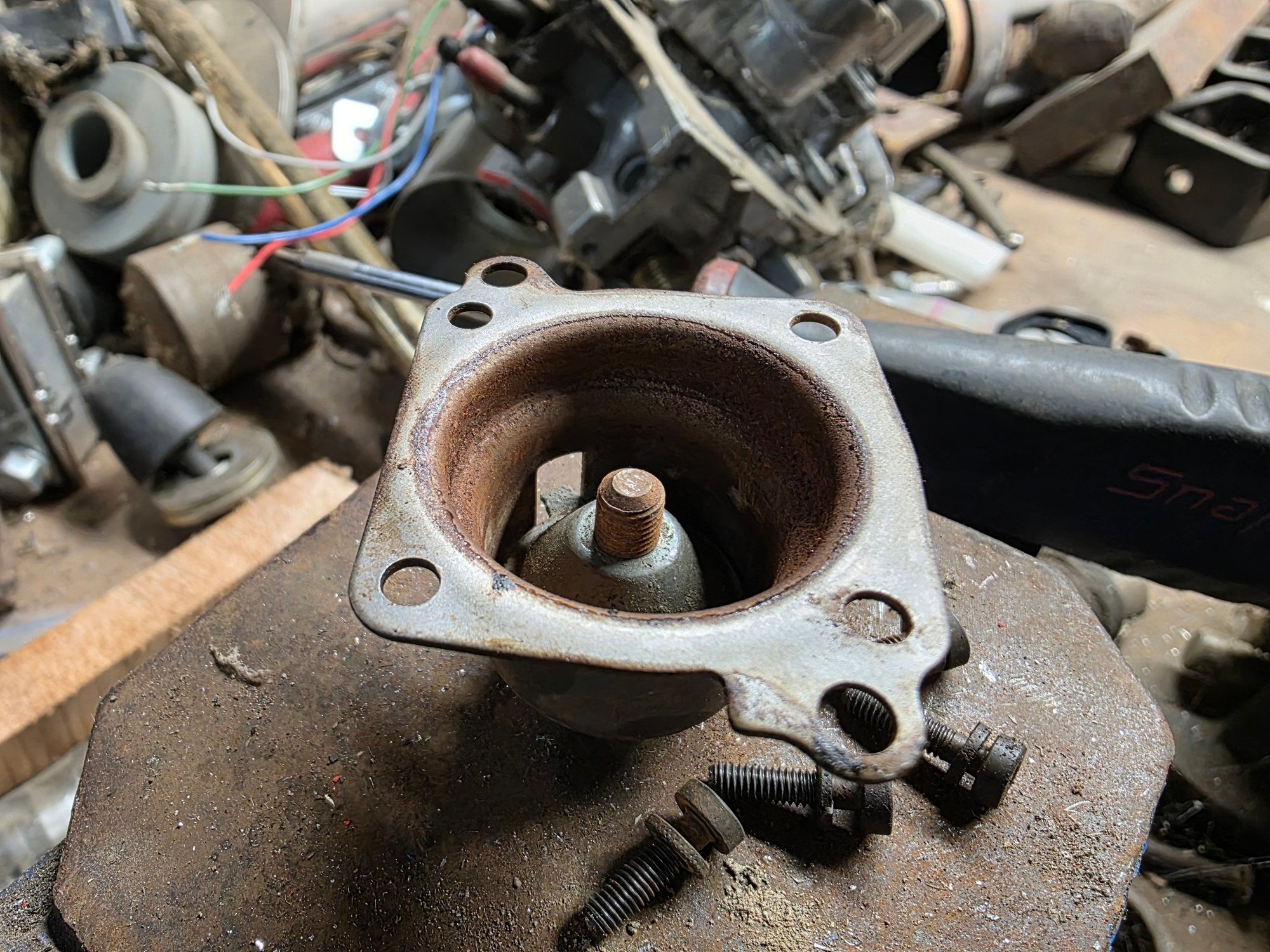

Come spring, the car would no longer run, unless it was fed starting fluid. Not surprisingly, the cheap fuel pump had failed. Let's face it... it did not stand a chance with the way the tank looked, in addition to being an unreliable cheap pump to begin with.
So, I warrantied the pump and installed it in a nice tank, although temporary.

Thanks. Did you happen to notice the color of the fuel that I pumped out of the rotten tank? Lol.
