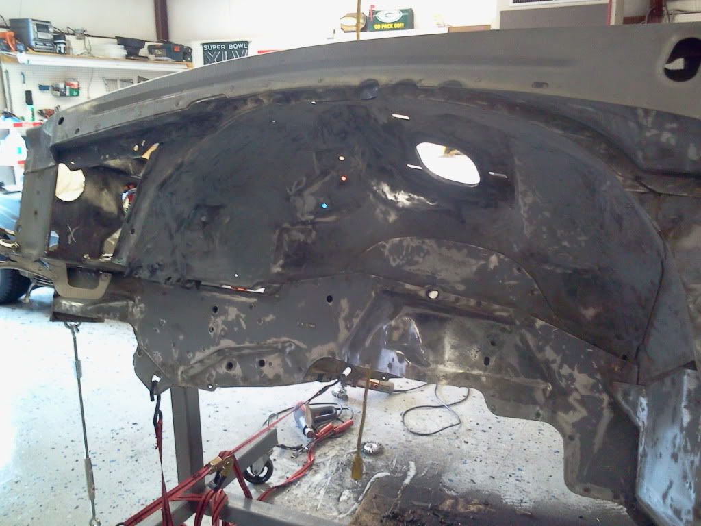

Step 2 - build rotisserie.
I'm currently working on the rotisserie. It will be made from 2.5x1/8" square tubing (which I've since decided is overkill, but better too much than not enough). I'm using the front spindles and rotors for the rotating components. I need to move the pivot points up with respect to the attach points. It's currently pivoting way too high above the vertical c.g. and it's not high enough to rotate all the way around without hitting the bottom cross tube. But it does rotate smoothly.
It's going to be a pretty long and slow process, so this thread will likely go stale from time-to-time, but I'll do my best to keep it updated.

The rotisserie looks like two engine stands, facing each other, with a long, center leg connecting them. I used the front brake disks and spindles so the car rotates on the wheel bearings. The brake disks are welded to the tubes that bolt to the bumper attach points (via 1/4" plate). The spindles are bolted to the "engine stand" side, using the existing threaded caliper mounting holes and the A-Arm mount. The whole thing rolls around on five 6" casters, rated for 330lbs each. One guy can maneuver it around the shop pretty easily.
The car currently rotates through about 30 degrees without any difficulty. It will go all the way through about 60 degrees with some muscle. As I stated earlier, I need to move the pivot points closer to the vertical c.g. This will both make it easier to rotate and let me rotate through 90 degrees.
I'll try to get some more detailed pics up in the next few days.

I spent the last couple of weekends stripping the front fenders. There was more bondo than expected, but no rust. I decided I'm going to shave the marker lights, so I'll spend the rest of the weekend welding patches in.
