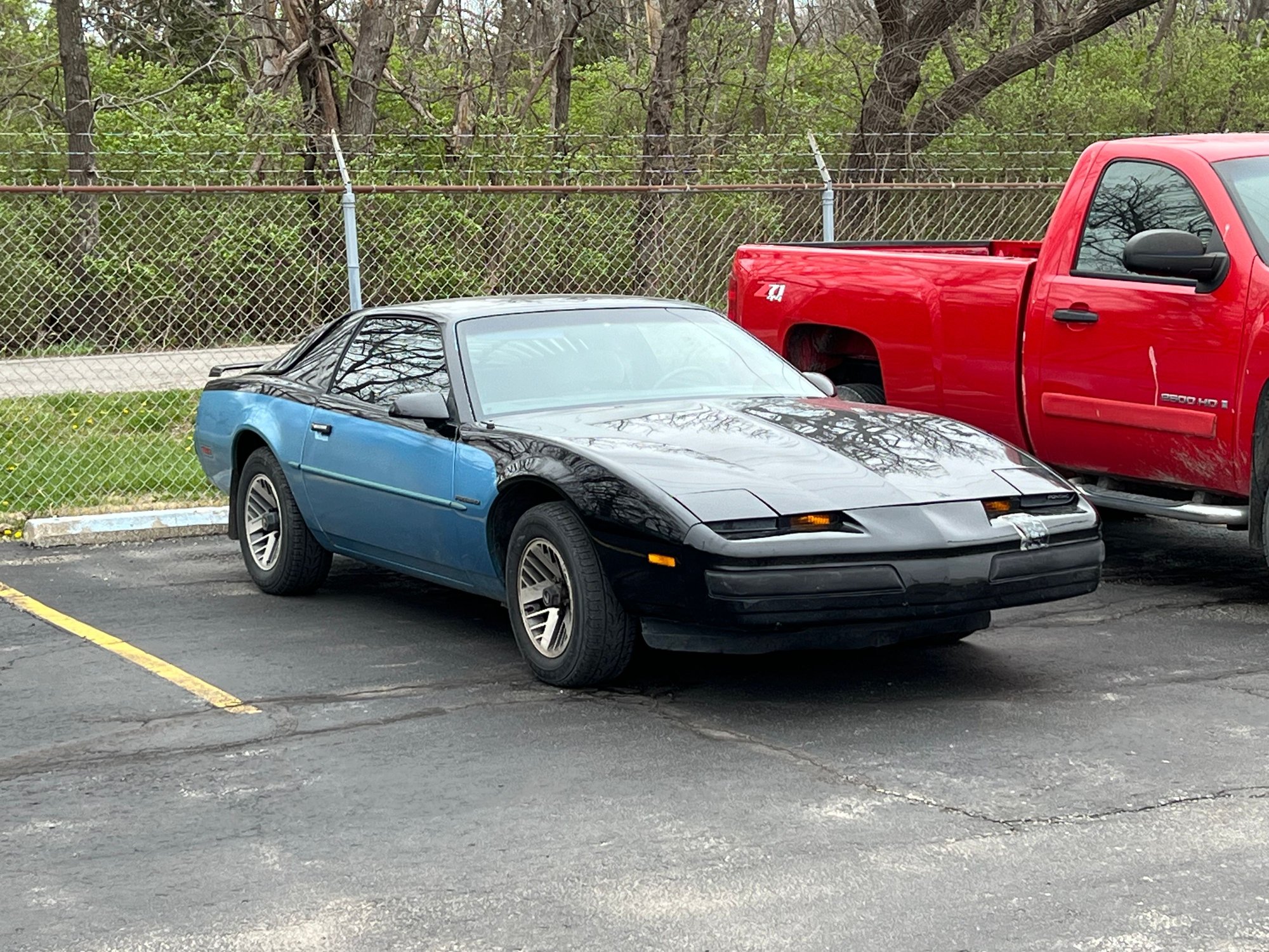

Well, it's been a few years in the making, but my old Firebird is slated to make its homecoming in just one week!
  • It is only a 2.8L, but should be fine until I get the time and money together to tear it apart. I'll just be happy to have it and drive it for now.
  • The seats are worse for wear and need recovered, but they needed that when I sold it.
  • Paint is fair. The $800 paint job I did in the early 2010's is holding up about how you would expect, and there is some chipping along the door seam at the back, but no major rust.
  • It's got a hole in the front bumper now, so I'll need to get another one. I'll probably do this at the same time as the paint.
I'm very excited to have a project again, and over the moon that it gets to be my old first car. Just a hop, skip, and a 450 mile round trip jump to go!

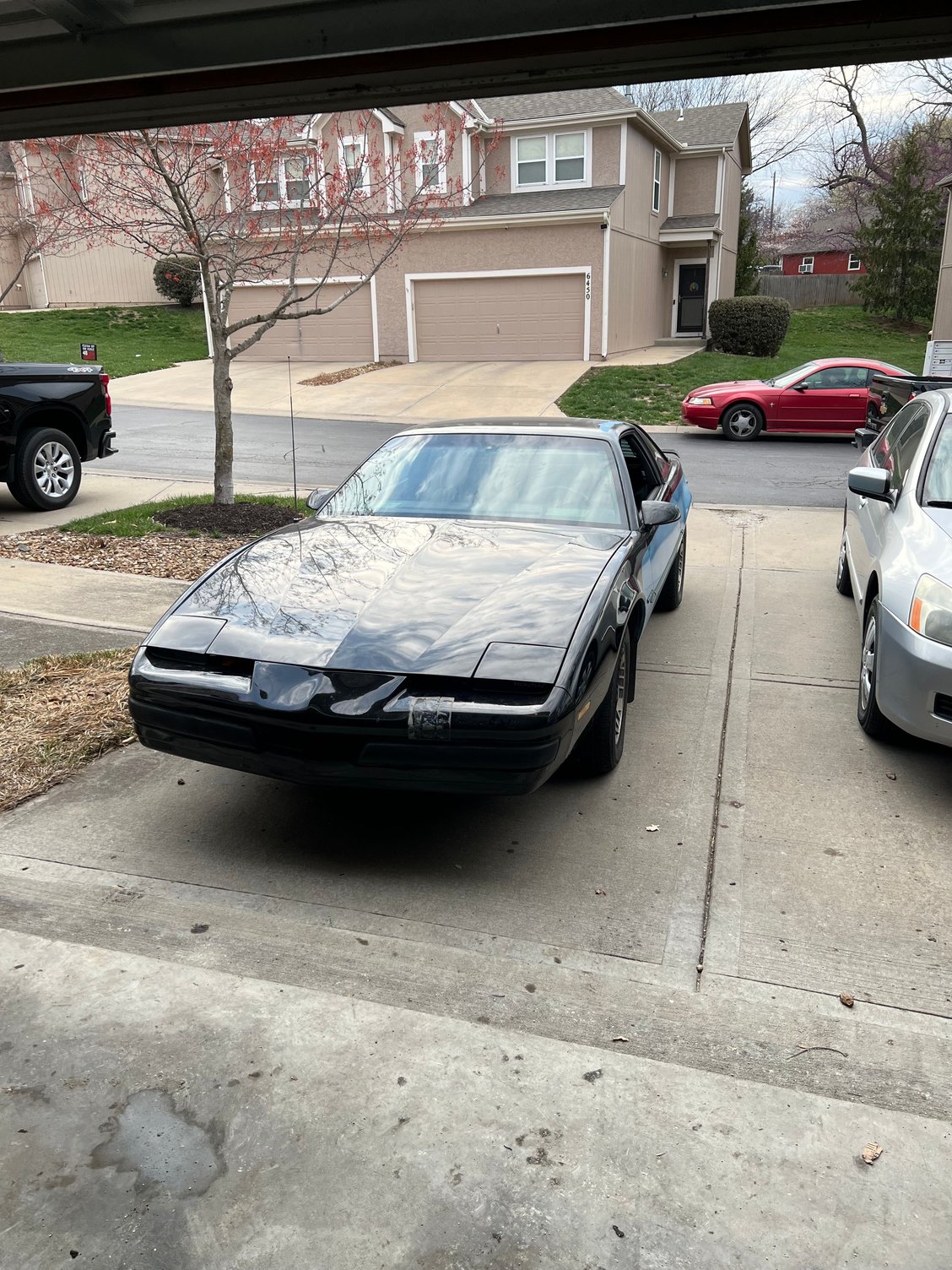

Today was the big day! I replaced the battery, added 2 gallons of premium, and it fired right up!
I can see that uncle Feivel has paid a visit at some point in the past decade, but from what I can tell, he didn’t stay long.
It does have a misfire, but it is running pretty well for having half a tank of 3+ year old gas with only 2 gallons of premium in on top. Good enough to drive itself onto and off of the trailer, as well as a few victory laps around the block when I got it home.

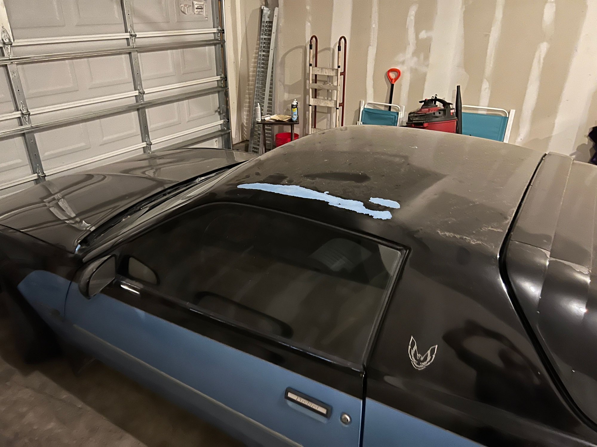

Paint is worse than expected, but that won’t be an issue. I expected “needs repainted” , I got “Really needs repainted”.
Brakes feel like a heaping serving of soft serve, so I’ll need to dig into the lines and see what’s up there. They do still function, but I’m far from impressed.
The oil change tag is still in the car from the last time I got it changed, in APRIL OF 2014!!! God I hope they’ve just been doing them themselves. If not, it’s only been a little over 10k miles since that 2014 oil change. I am skeptical of the oil pressure reading. It is showing 60+ PSI and does not budge at all when the engine is running. Drops to zero when the engine is off however. More investigation needed (after changing the oil).
All-in-all, it was a successful road trip, and I’m pleased as peach with it. My fiancé doesn’t get it at all, but she’s taken the position that she’s “just glad I’m happy”

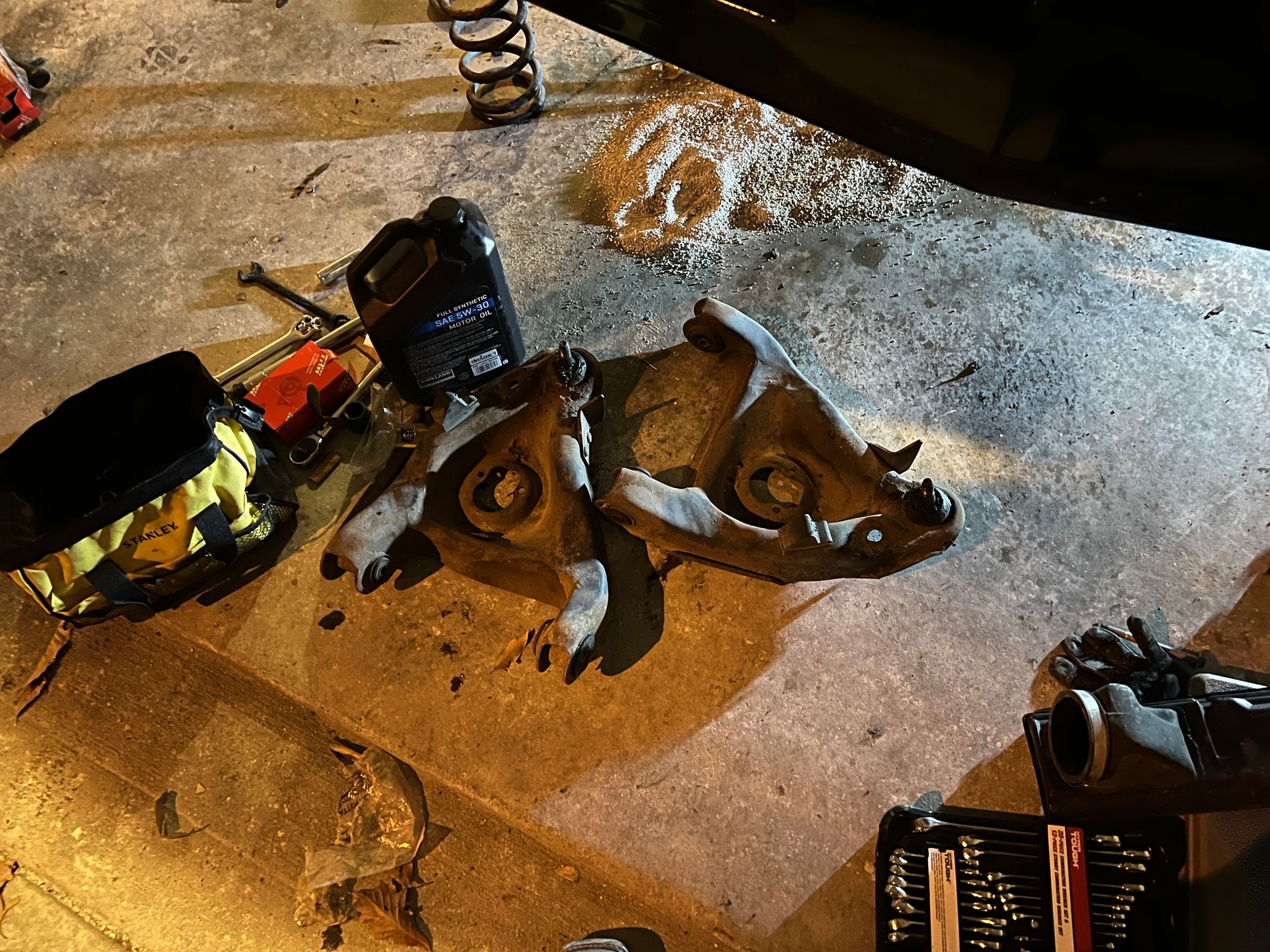

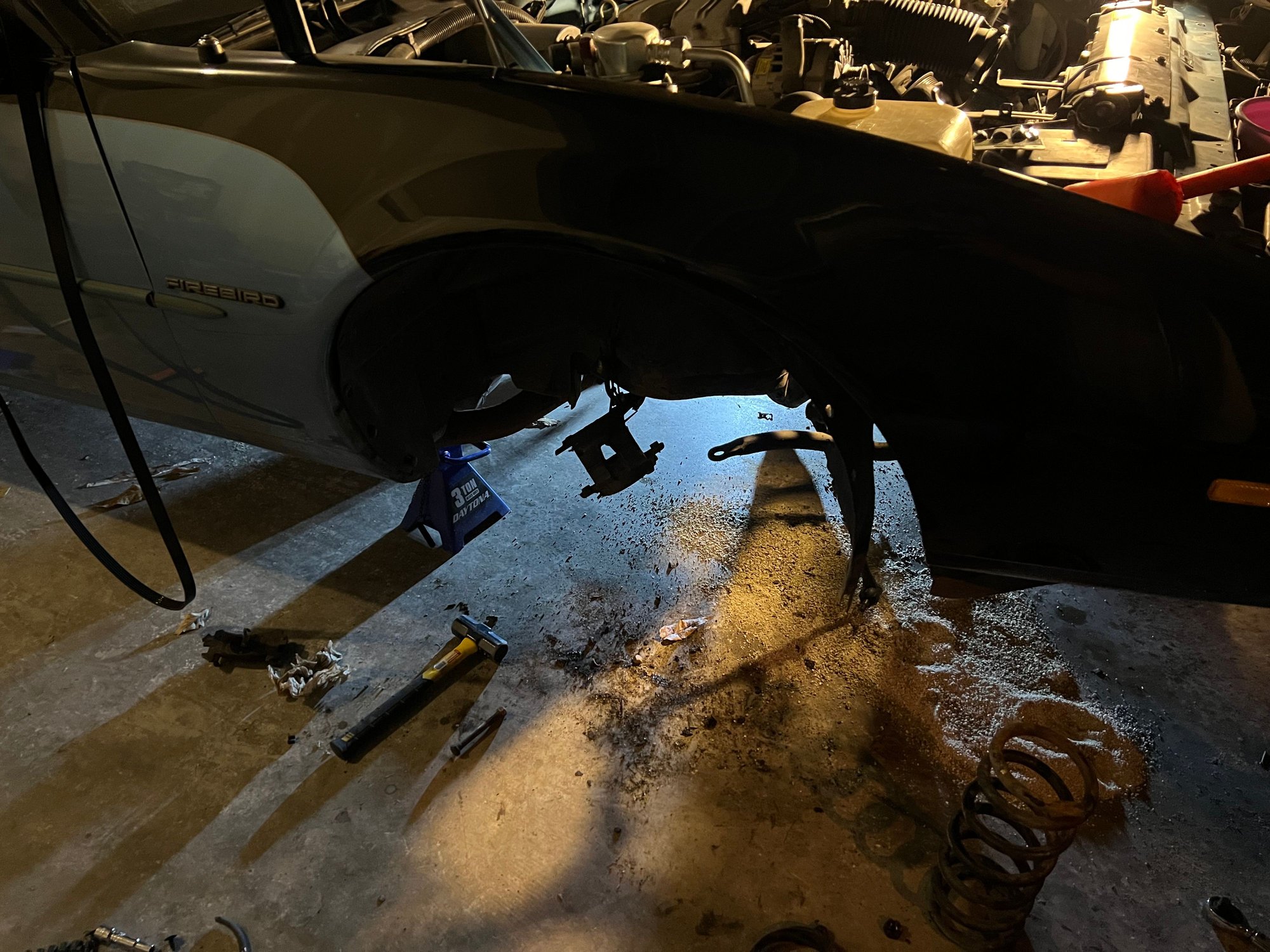

I’ve spent the day today checking it out and finding issues to fix.

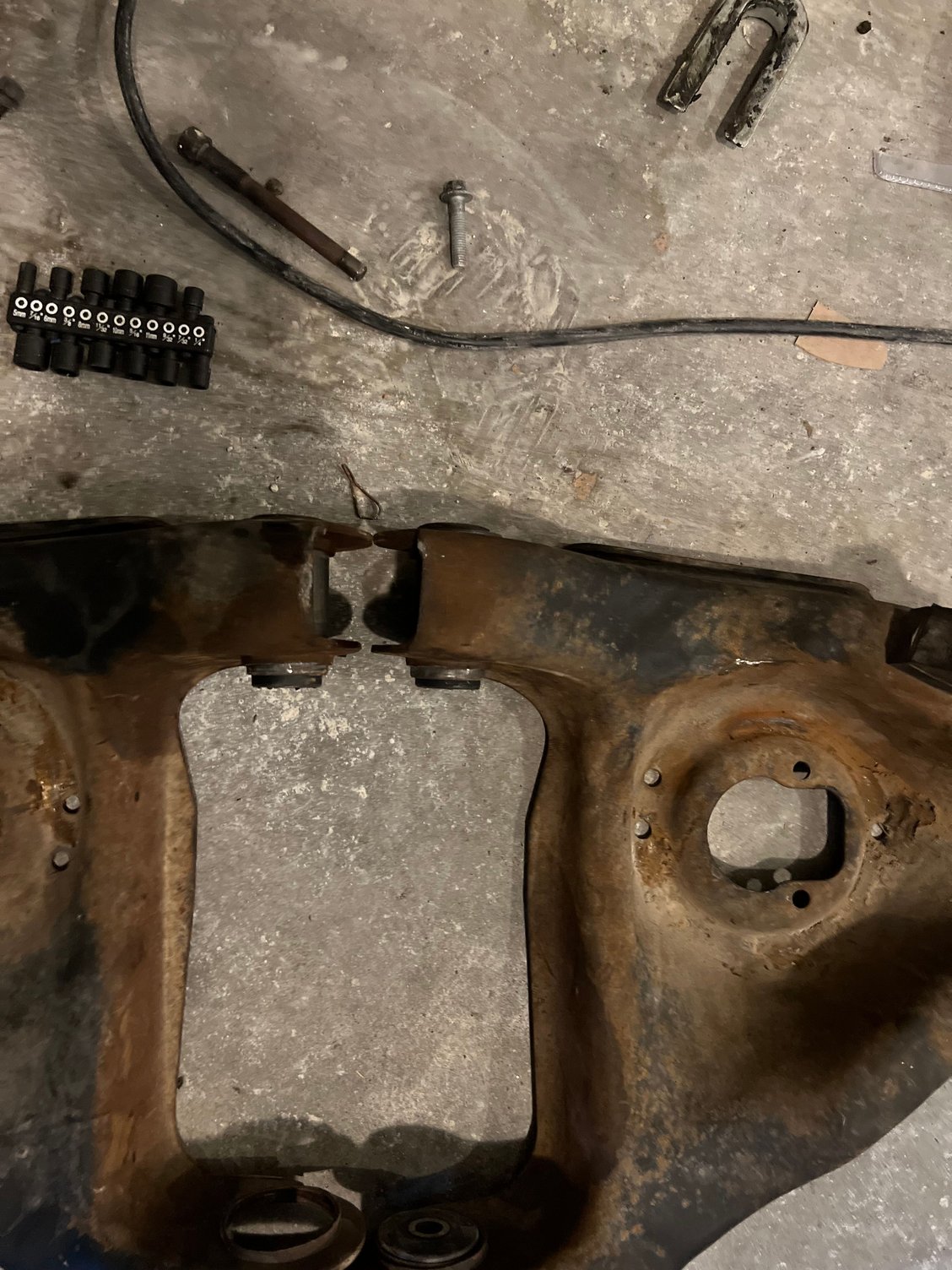

Front end had a significant “clunk” going over bumps and around corners. After checking it all out, I found half of a single sway bar end link bushing still intact. $25 for a new set of end links, and the clunk is completely gone.
The only evidence of Feivel I’ve found is the vacuum line for cruise control being chewed in half. I put a new 5/32” line on, and cruise is working great once again.
On the oil, I can now confirm that the oil must have been changed, but the tag wasn’t updated. The oil in it was cleaner than the (4,500 mi) oil in my truck, but it is now changed anyway.

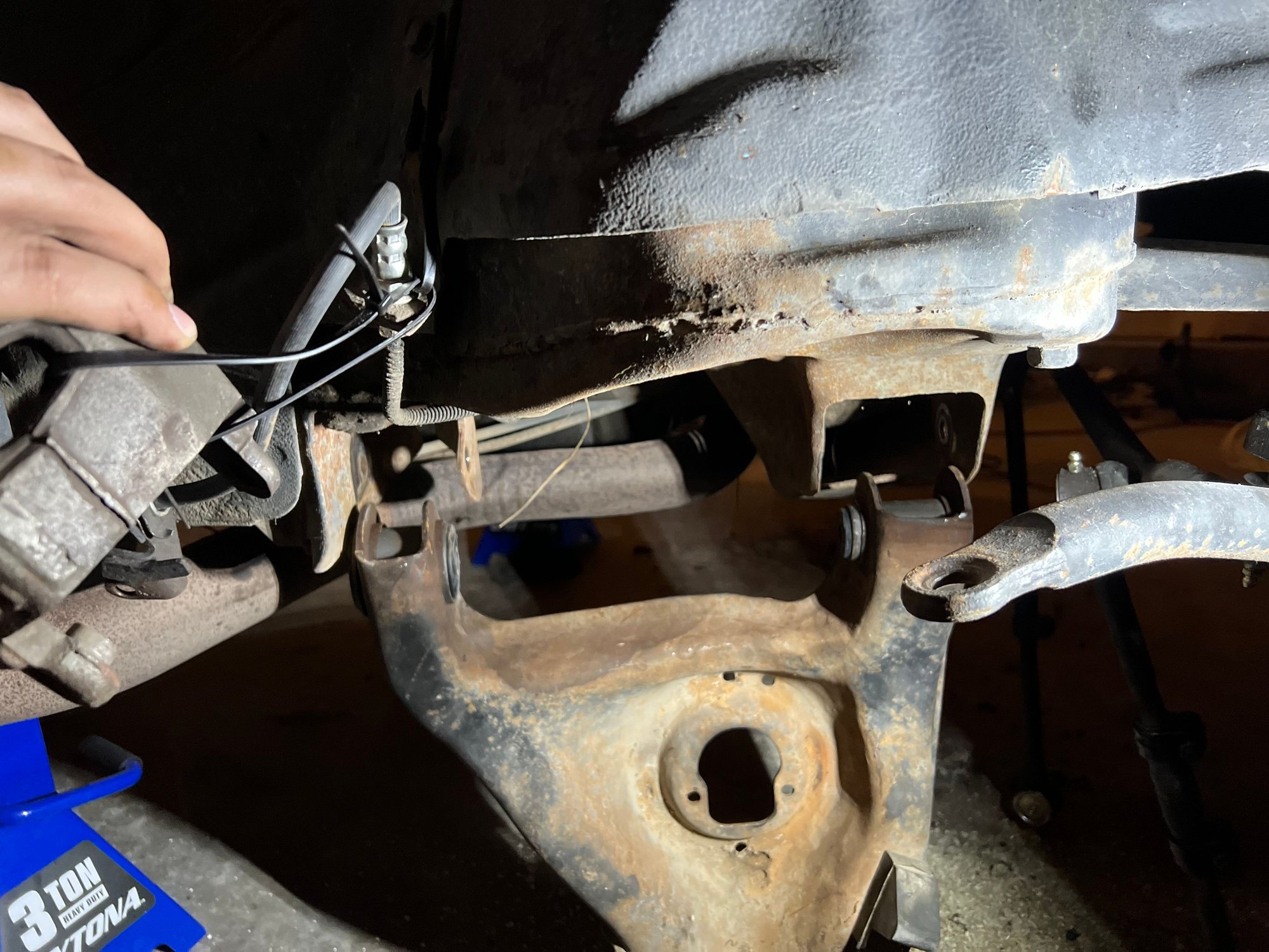

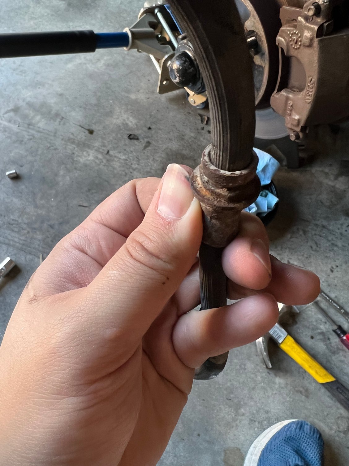

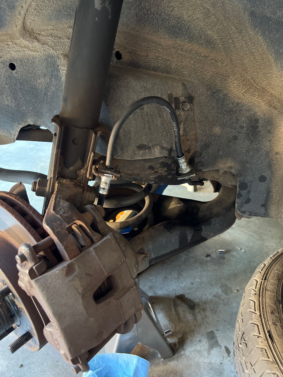

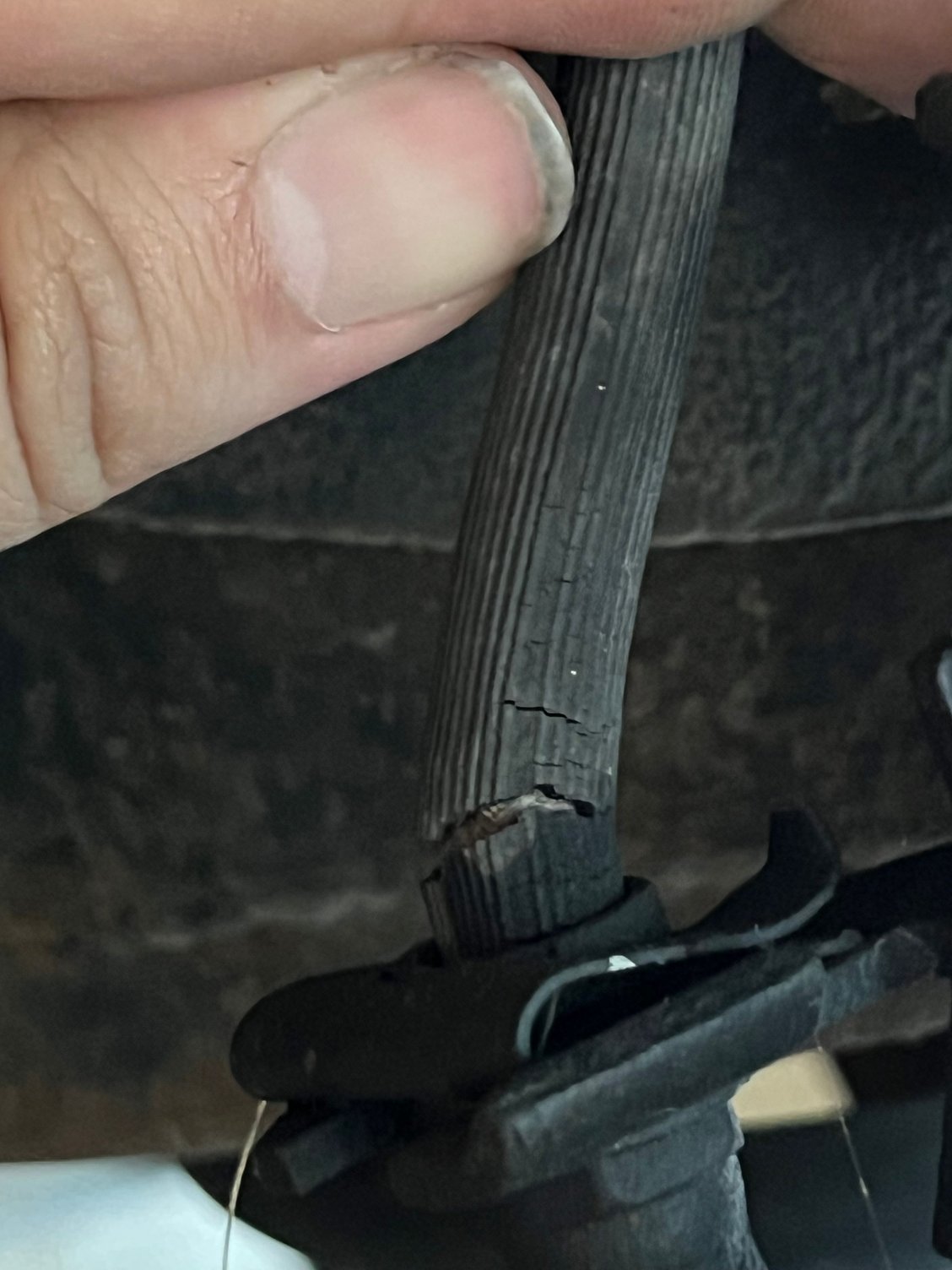

Getting back to the Firebird first thing this morning. Pads look to be in great shape up front, but there is a grinding/creaking sound from one of them. Anyone have any ideas?
Further inspection has shown the front brake hoses to be hanging on by a thread. New hoses are in the docket for today.
Additionally, my front struts appear to be bad. Doing the push on the fender test, it bounced 2-3 times before settling up front, and zero times out back. They are also coated in oil. (Confirm?)

I didn’t know what the difference between the left and right brake hoses was until today. Turns out they clock into features on the car so that that aren’t installed twisted.
I couldn’t find an answer to why they were different part numbers online, so I just wanted to post sharing that for future first time brake line DIYers.

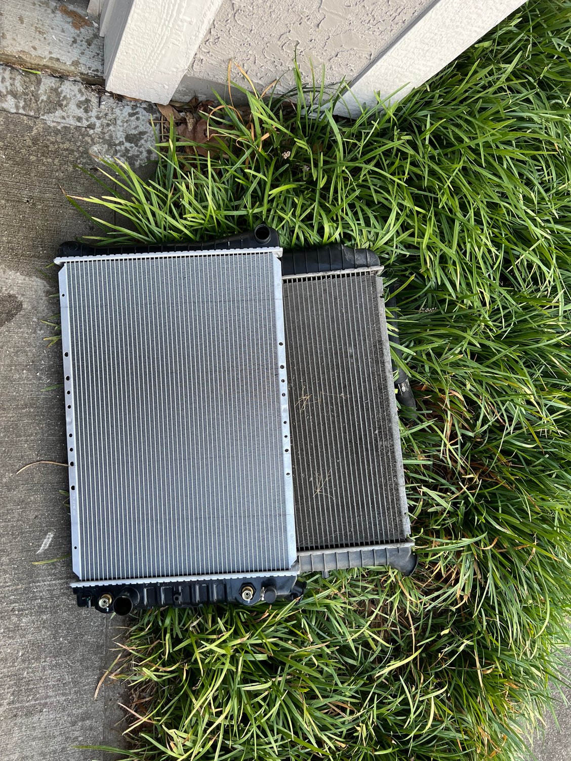

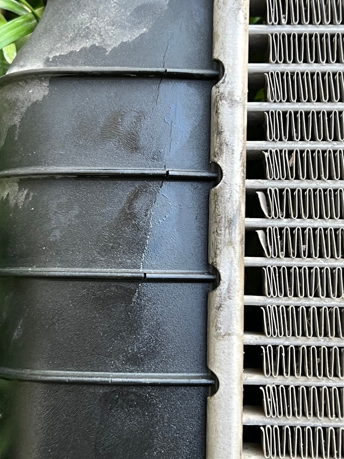

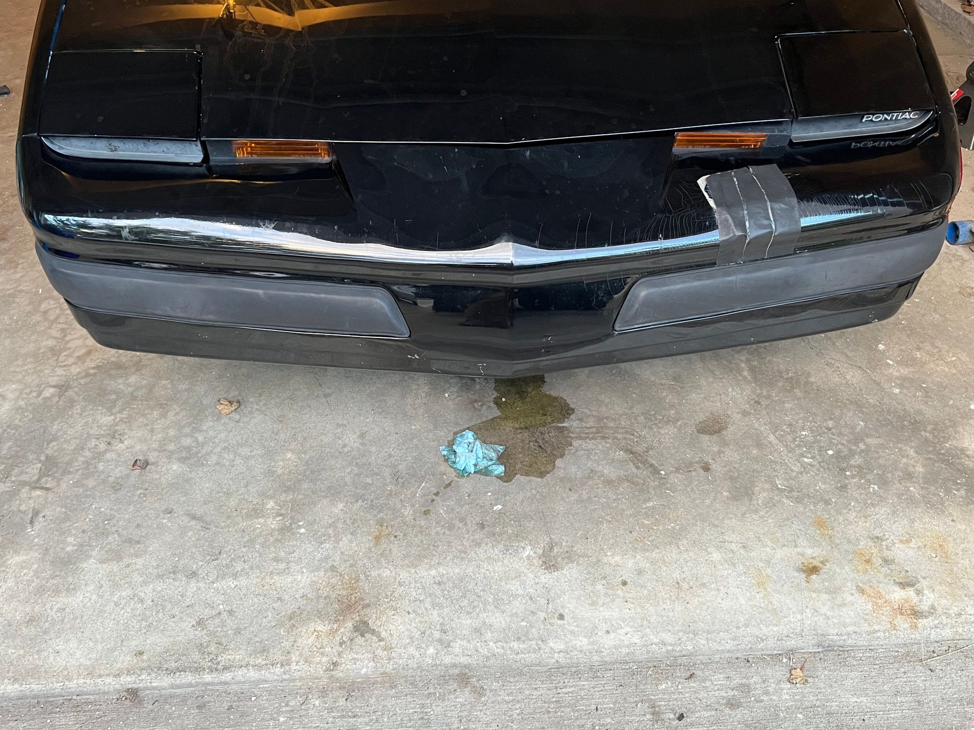

Well, I got the radiator replaced! After some research, I found that nobody makes the v6 radiator anymore! I did some digging and found that the 1990 v6 firebird uses the v8 radiator, so I just bought the 1990 v6 radiator hoses and the best el cheapo radiator I could find on RockAuto. This radiator is a bit wider, but seemed to fit up well enough.
Busted v6 Radiator
Old vs New Radiator Sizes

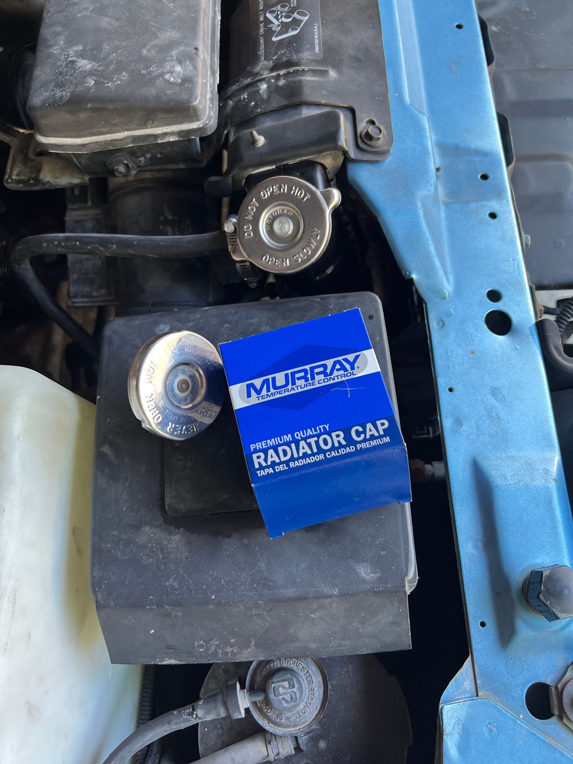

After replacing the radiator, I still had a minor leak going on. I decided to replace the old radiator cap and see if it helped.
Still leaks a little?
New Radiator Cap
Still leaks a little from... somewhere... I have my doubts that the drain on this cheap-a$$ radiator is actually sealing. But, it is good enough to get me by and go for a few rides to work before the end of the year. I would have went with a nicer radiator, but my medium term plans will call for a bigger radiator anyway. Figured I'd just do it right when that time actually comes.

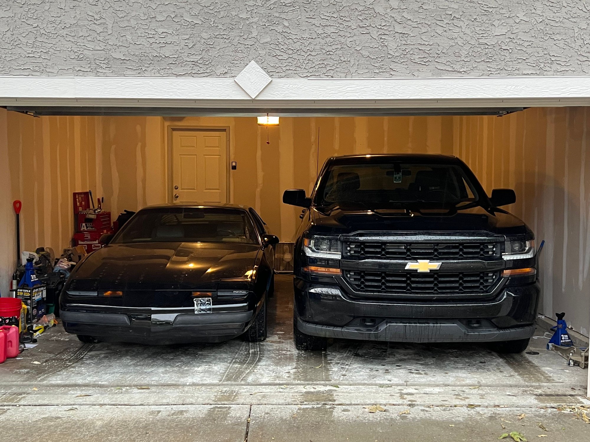

Well, my current daily is a 2017 Silverado. The L83 in it makes good enough power, and I am impressed by 20MPG out of it while driving a big *** brick down the highway. It seems reliable too, so I would like to have basically a Gen V driveline in the Firebird.
1989 Firebird and 2017 Silverado
My old daily was a 2018 Mustang GT. I really enjoyed the 10R80 in that, and I can get the same transmission in Chevy flavor just called the 10L80.
My old 1998 F150 and 2018 Mustang GT.
My ultimate goal is a dead reliable cruiser that makes modern ponies and makes good MPGs. Targeting 350-450HP, and 20-30MPG.
Gotta get the paint fixed and the very very minor (for now) rust spots I have identified. Then make it nice and comfy, something I can drive anywhere in the country and just enjoy.
TL;DR: L84/L86/LT1 + 10L80 + Ford 9” + Fresh Paint + Comfy & Clean Interior.

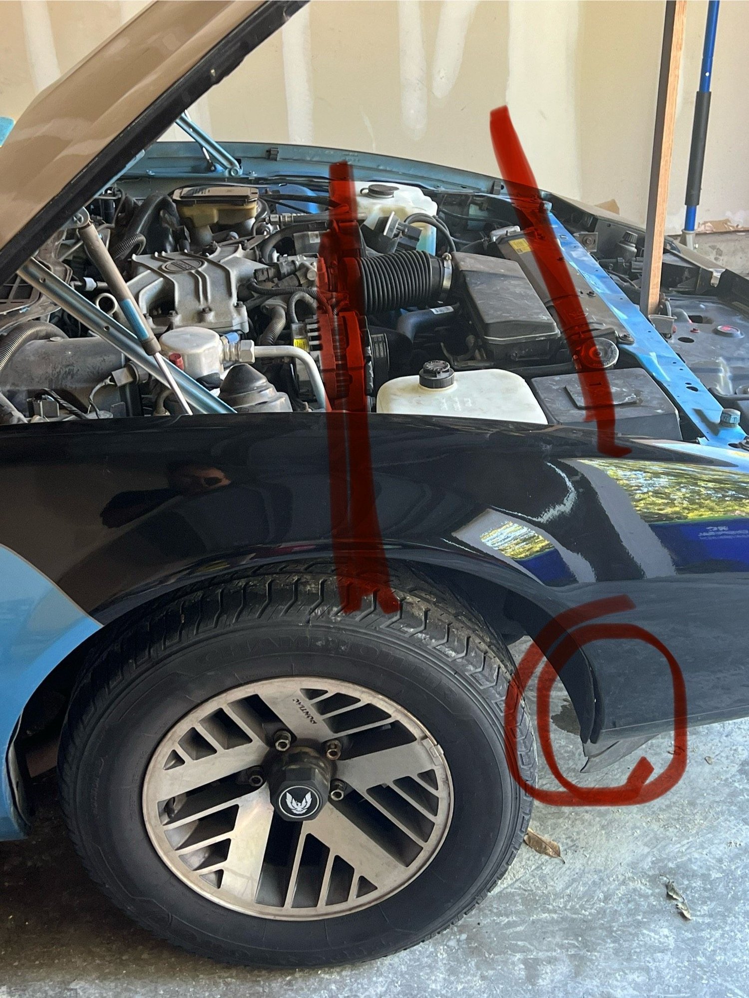

I am hoping so too. There really isn't much, even the battery tray looks factory fresh still. Only places I've identified any at all are just in front of the rear wheels, and just behind the doors on either side. Even the seams along the underside of the car are pretty much blemish free.
In front of the wheels looks like it may need some new material, but it is all very rigid still. Only way to know is to dig in.
Behind the doors on the seam is just surface rust. The last owner lived on a rock road, chipped the paint off right there. I could remove 100% of the rust with 10 minutes and some 80 grit.
The real question is whether I have it in me to paint a car by myself, or if I can find a place deep enough in my wallet to not have to.

Back to it! We've got a B-E-A-U-tiful few days in the midwest, so time to get cracking on the 'bird again!
First order of business was the coolant (still) leaking all over the garage floor. I went to jack up the car to get the new lower radiator hose on, and misplaced the jack, letting it slip forward onto the center link. Violently.
Measuring the toe just for ***** and gigs, I measured 48" at the rear of the front tires side to side, and 46" at the front of the front tires side to side. So I guess I'm rebuilding the steering this weekend!
Once I got the car up on jack stands (PROPERLY), I went ahead with checking out the lower radiator hose... but, it's actually the water pump leaking. COOL. I hear those are super easy on the 2.8.
List of work for the weekend is now:
  • Water Pump & Gasket - BOSH 98070 & FEL-PRO 35409
  • Front Shocks - MONROE 71728
  • Center Link - MOOG DS1049
  • Tie Rod Ends (Inner & Outer, Both Sides) - RAYBESTOS 4011316 & 4011317
  • Tie Rod Sleeves - TRW JSA1015
  • Brake Pads - WAGNER ZD154
  • Control Arm Bushings - PRECISION CHASSIS PRE K6253
  • Ball Joints - ACDELCO 45D2026
  • Idler Arm - ACDELCO 45C1065
  • Partridge in a Pear Tree
Much fun to be had, and lesson learned... make sure you position your jacks carefully... I'll post more when work gets cracking!

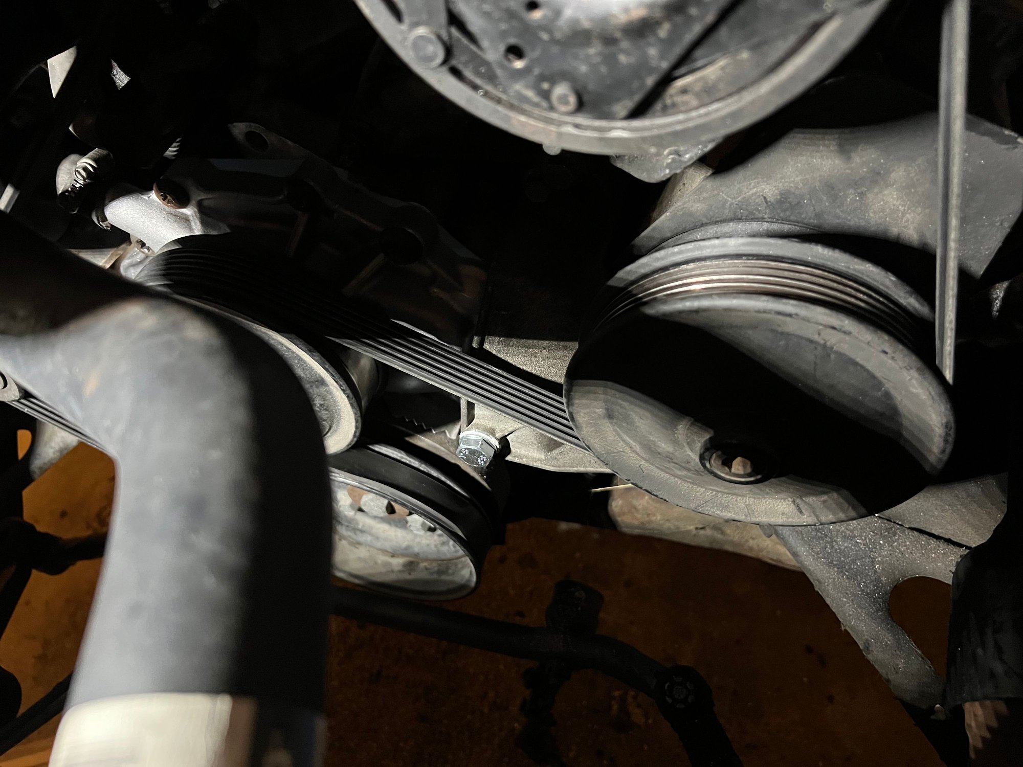

Water Pump - Damn Power Steering Bracket

Pain in the rear to get down. My ball joint & bushing press won’t fit between the legs of the control arms, so I’ll need to find a different path…
New Bosch water pump and Fel-Pro gasket. Glad I got the gasket, Bosch FOLDED the one in the box, breaking it in half. Also, the boss for the Power steering pump is tapped for the wrong hole size. It’s the same size as the larger bolts on the PS pump bracket for some reason.

Well, not a lot of luck in the shop this week.
I got the new water pump mounted, and resized the hole on the PS bracket for the oversized bolt hole on the water pump. The bolt I ended up using was an M10-1.5 x 35mm hex head, along with a generic M10 flat washer. It seems to have done the job, and things are moving forward!
Water Pump Installed
New Bolt
After fighting with the control arms, I think I stretched one of them out. I briefly tried using a bottle jack to loosen the bushings (an absolute boneheaded move in retrospect), and now that control arm won’t go back in its home.
Passenger control arm - won’t fit
Comparing the two control arms, it appears that the one I used the jack on is about a 1/4” wider than the other one. Angrier than hell at myself for that, and even worse that I finished pressing in the new bushings and ball joint before noticing. $50 down the drain unless I can find a way to salvage the arm.
Lined up on one side…
Stretched and misaligned on the other…
For a path forward, I have a few ideas:
  1. New Tubular Control Arms. Speedway Motors has a set of nothing specials for $199, and if I had known about them before buying bushings and ball joints, I would have just done that from the get go. I don’t think these are in the same league as a nice set of UMIs, but they can’t be worse than the stockers, right? Relevant Forum Thread
  2. New to me control arm from Hawks Motorsports. These get the job done, but it’s $50 for the part, and another $50 for a new set of bushings and a matching ball joint. Plus, this whole process has been a pain in my rear. Not a big fan of this option.
  3. Squeeze it to fit. Can I just put this in a press and squeeze it to make it better? I don’t know, but if the part is junk anyway, I’m keen to find out. $100 buys a cheap A-Frame press from JEGS. I wouldn’t mind having one, but don’t want to spend the money if it won’t fix the problem.
  4. Take it to a shop. This costs pride, but hey, who needs that anyway. Maybe they have a press and they’ll give ‘er a squeeze for me.
Old Feb 27, 2024 | 09:58 PM

Exactly what I had to do. Took the front arms out and restored them. I bought some quality bushings and ball joints. I took them to a local hydraulic shop and they popped the old ones out, new in and they reinstalled in the car with ease. If you happen to need a new one and don’t wanna drop a ton of cash check your local salvage yard. Guy here quoted me $70 if I needed one. That includes him removing it from donor car

I got mad and just ordered the new tubular control arms. I get married on Friday and I’m away on my honeymoon for a week after, so they will hopefully be here right in time for me to get back.
New Control Arms and Hardware
I’m really disappointed that I won’t have the car done for wedding day, but it is what it is. As far as I can tell, I might be the first guy on the forum to actually install and drive them, but not the first to get them. (See previous forum link).

After a long day of work, the car is back together again! Speedway ended up not being able to give me a firm delivery date for their A-Arms, so I went with BMR to get me a set. I ended up with what are technically G-Body arms due to time constraints, but BMR confirmed that they are the same part number that they sell as F-Body arms too (and almost $100 cheaper to boot!). They fit well, and I have no real complaints. As a note, I had to swap to right angle zerk fittings for these control arms. At least one of the existing straight ones was going to be inaccessible with the control arms on the car.
Driver’s Side Control Arm
Passenger’s Side Suspension Assembly
Right Angle Zerk Fitting
I ended up reusing the existing wheel bearings, but did opt for new front inner wheel seals, as mine were falling apart.
Back on the Ground!
With that done, it now desperately needs an alignment. Despite my best attempt at matching the old hardware, I can tell just looking at it that it has pretty bad toe-out. Additionally, these new control arms are noisy! They creak and pop like crazy on acceleration and braking. I am wondering if I over torqued the bolts for the control arms… I may go back and loosen those in the morning just to see. (Advice on this?)
Happy wrenching!
