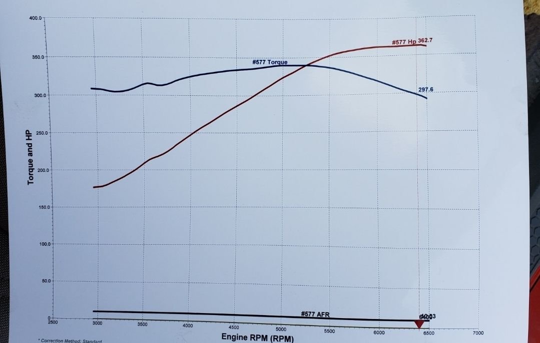

380hp 305tbi
Got the bird dyno tuned the other day and was hoping for a little more but it runs and drives pretty good now, made 380hp/378 foot pounds to the wheels think it's a conservative tune?
2006 gto 6.0, T56, ls7 clutch, 3.73 gears, Katech ported 243 heads, Johnson lifters, 42 pound injectors, cam motion titan 4 with their recommended valve springs, stock intake and throttle body, stock rockers with trunion upgrade, home made intake, hooker blackheart 1⅞ headers an the hooker blackheart true duel exhaust definitely faster then the 305tbi.

Re: 380hp 305
Hmmmm, well 380 RW is PLENTY to make for a wicked fun car...and that's a gorgeous, fun car!
I had a bone stock C6 (T56 car)that did 361....then 366 after a tune (a pretty lame 5 hp gain from the tune!?). Anyway, I'd think that with a cam, LT headers and exhaust it should do more than about 20 better than stock....you're about 20 better than my stockity-stock, so I think it should do better. That's a pretty healthy cam you got there...I'd think it should be over 400 wheel. My car also did 355 RWTQ, so you're about 20 better there, too.
Another thing; your peak hp is at 5800....box stock, that engine should peak at 6k, IIRC, so it's weird that w/way. more cam and better (on paper) exhaust, you're peaking lower? Hmmm....

Re: 380hp 305
I was thinking 400 at the wheels, it's good enough for now I have a few small things to do but Ill keep my eyes open for deals on intakes to get it tuned again.

I would have expected more with that setup to be honest

Re: 380hp 305
Can you test the exhaust back pressure?

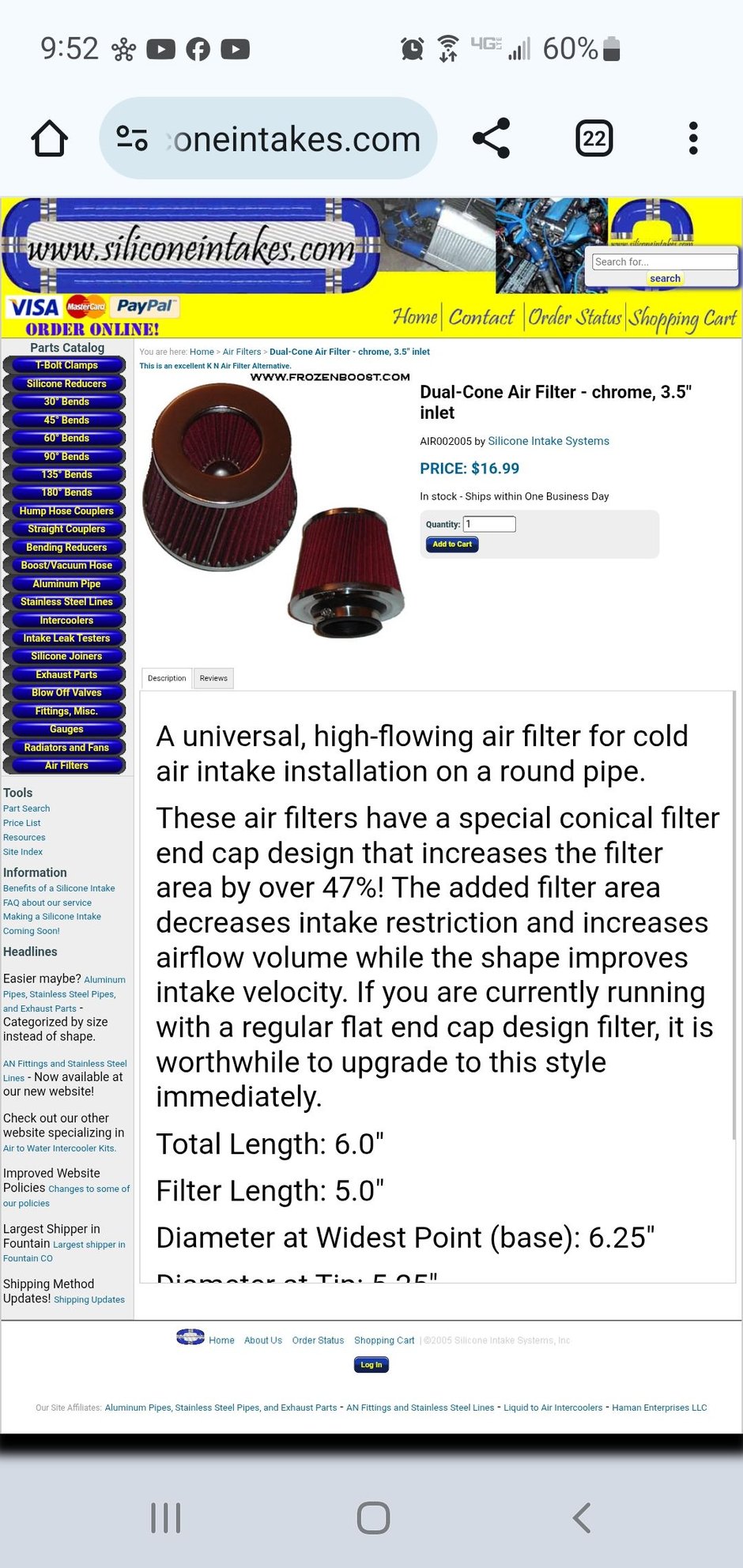

Re: 380hp 305
What is your air intake setup? Filter size and piping?

Re: 380hp 305
Thats about right considering that your peak power hits at 5800rpm or so and then it noses over. With 6.0L if you want more power you gotta spin it faster.
But looking at that cam in other cars it seams to make peak power in the low-mid 6000's on a 6.0L.
Exactly. W/that cam, it should be peaking higher, IMO.

363 rw with a 5.7 243 heads LS7 cam and very mild tune

Re: 380hp 305
Your combo probably has more in it as your tuner didn't extend the run until power significantly dropped off. Also, a dyno is a just a tool where the numbers are for the most part meaningless. Your track times will stress test your dyno results. I'd ask your tuner why they let off so early. It may be because of knock counts, AFR, or suspected valve float.
It's 3.5 inch which is what the maf is, and a generic filter from https://www.siliconeintakes.com/
Your piping size is good. These motors do not like a small filter. I gained almost 15rwhp switching to a giant cone filter from a "basic" sized filter.
Edit: did your tuner see any signs of pulling vacuum at WOT?

Re: 380hp 305
here's a pic of the filter, I'll probably get something a bit better after you mentioned it since it was a good for now sort of deal

Re: 380hp 305
You beat me to the punch! That filter is way too small. By a lot. I would guess that your tuner saw vacuum at high rpm and stopped the pull short. If you replace it you'll likely need another tune. My fueling was way off after switching filters.

Re: 380hp 305
Even my filter was sucking in during dyno run. I run an amsoil dry with a prefilter.

You can see my prefilter(blue) being sucked in, then expand once he let's up throttle.

With a 3.5 inch conical filter having a base diameter of 6 inches... You need about an 8 inch long filter for a 364 ci engine at 6500 rpm.
This is based on calculations of minimum surface area published at K&N website, and calculating the surface area of a circular truncated cone.
