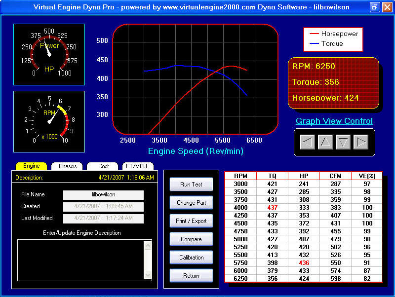

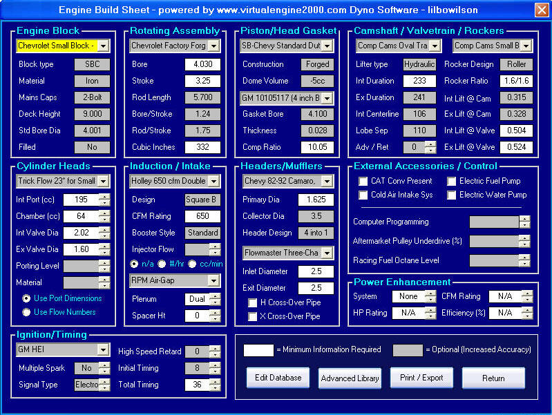

a little off topic, but how do you like that vitrual engine dyno pro software? i got the basic version.

that looks like fun.. dang, i need to get a PC.. or at least upgrade my mac so i can run windows programs..
but anyway, those numbers should get you to high 7's.. provided your car doesnt weigh 2 tons..

I have to say I do like the results that software puts out! Those upgrades are what I'm going to this is what I have now try it on your software for me:
Cam dur 230 and lifte .480 in/ext I think its a 280H design
Edelbrock Performer EPS intake
3" exhaust not 2.5
I have a pro billet distributor not HEI
My head gasket will be .015 thick not .028
I just installed my Quick fuel carb on it today that thing is amazing all the problems I had before (bogging, cutting off in drive, loading up) are gone. I don't even have to give it gas to start my car it fires right up every time.
